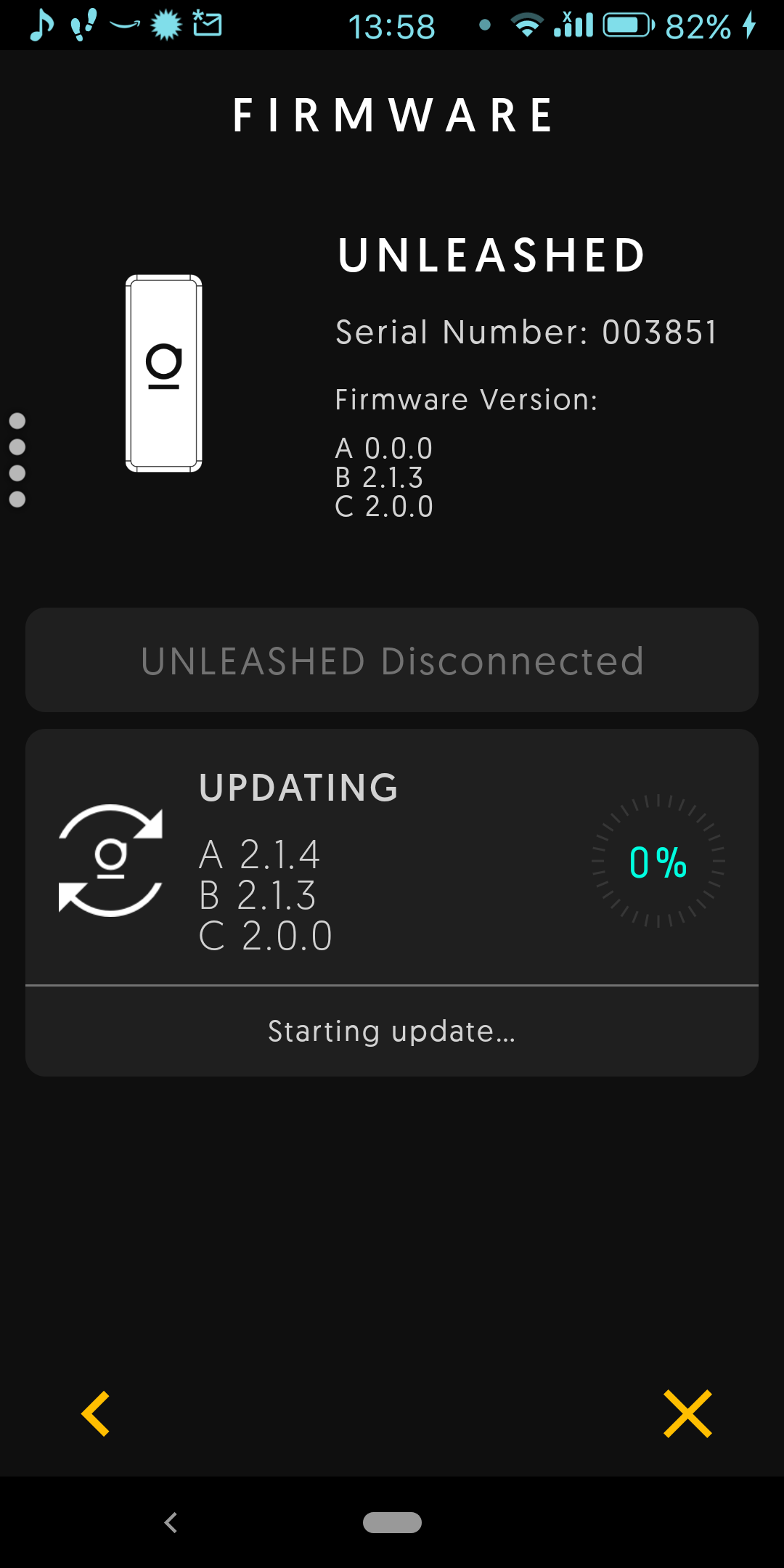

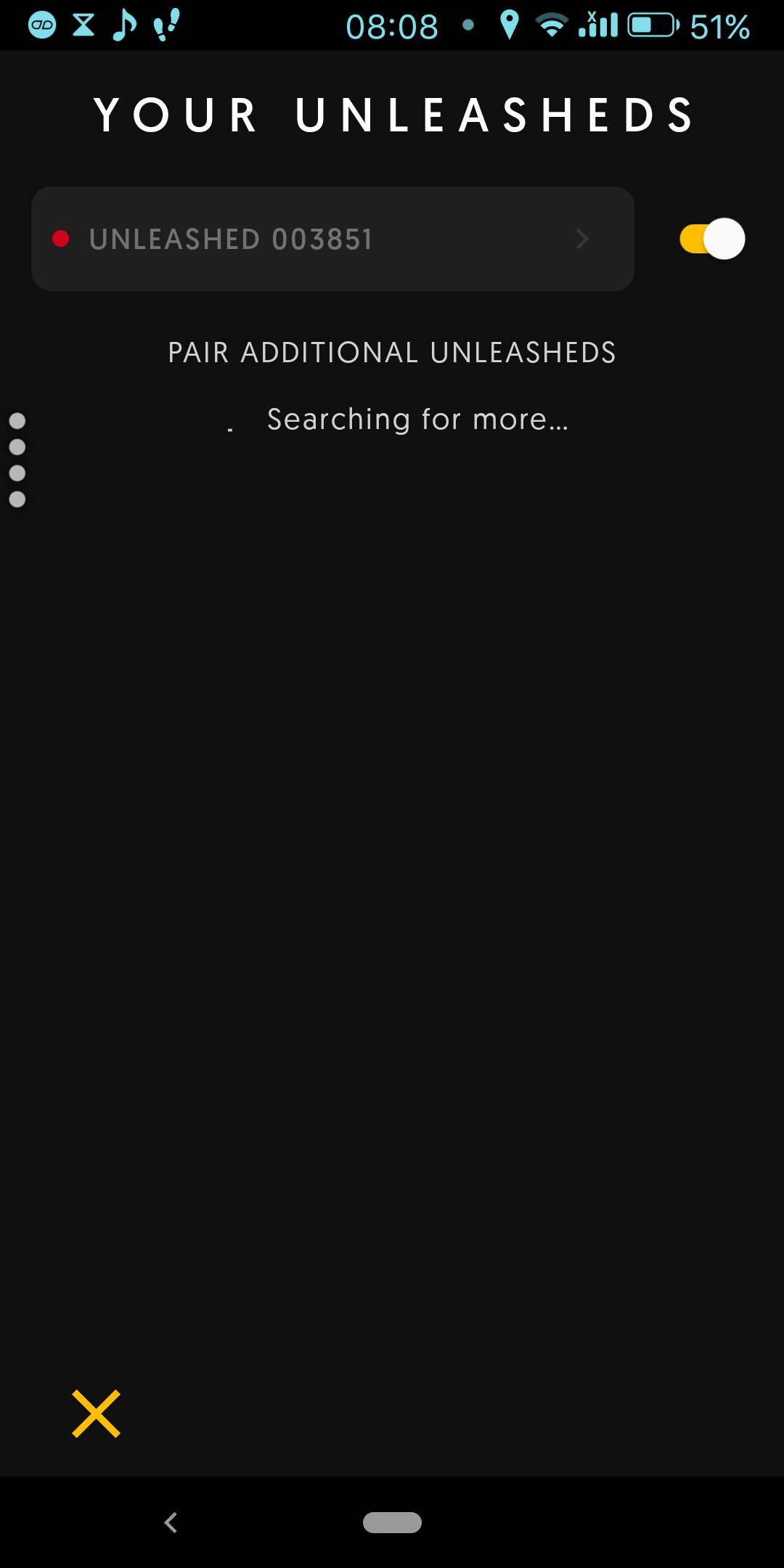

After month in Hospital i tried to reactivate my Unleashed Hardware on my Nikon D7000 but ended up with a mess, the LED is blinking red and the update process stucks at 0%

Hi!
I see that your serial number is below 4500, so we almost definitely have a fix for you. You will not believe this but the following trick will almost definitely help: Put the Unleashed in the freezer for 10-20 minutes, then plug it into the camera and try the update again, while it’s still as cold as possible.
We took a long time trying to find the cause of this problem. We found the problem and fixed it, but the fix comes in Firmware A, so if there’s ever a problem during the update of Firmware A, the fix will no longer work either.. The trick with the freezer has a scientific explanation too - now that we know the underlying cause.
I hope it helps!
- Posts: 1139
- Joined: October 9th, 2018, 4:17 pm
May 25th, 2022, 3:23 pm
Please try again a couple of times. We've had several cases where it only worked after the 3rd or 4th try.

May 27th, 2022, 12:24 pm
the third attempt was successfull, thx for this hint - unbelieveable but true hahaha
