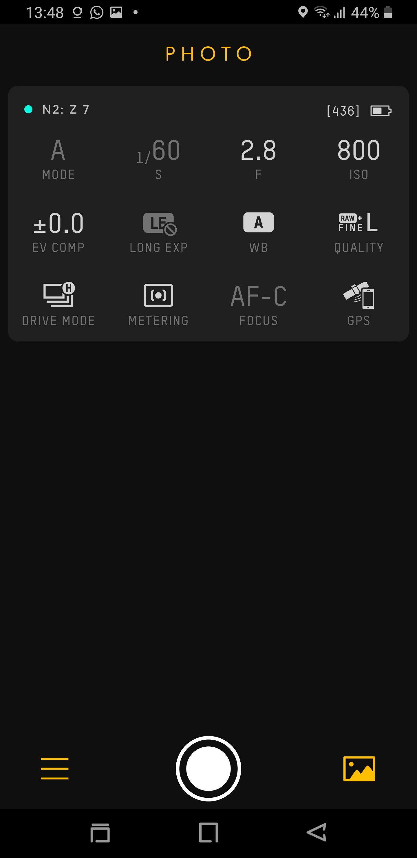

In the screenshot it looks like the Unleashed thinks the Shutterbutton is fully pressed. Although very unlikely, it's possible that there is a hardware issue that was missed by our tests.

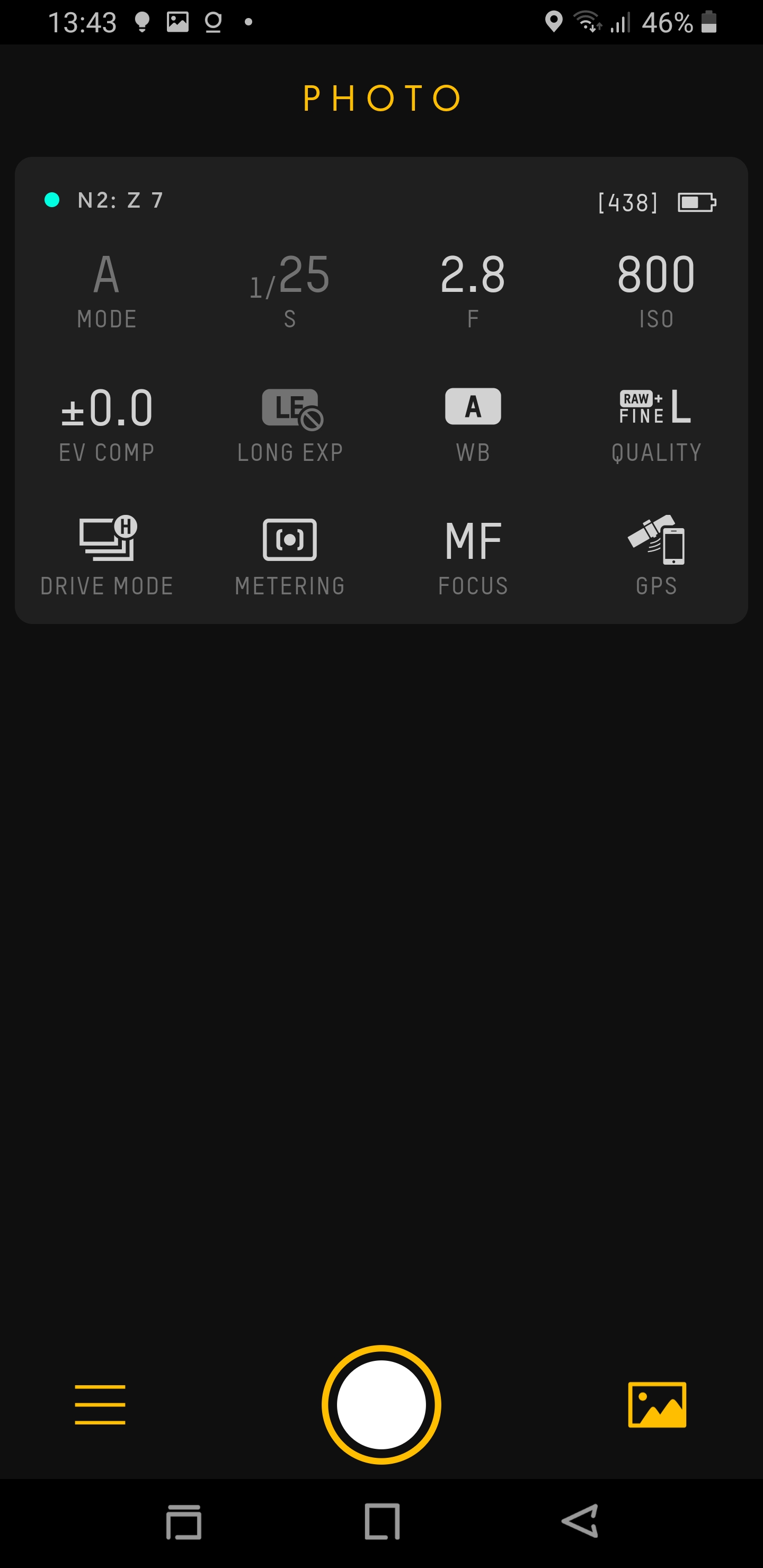

Could you unplug the Unleashed, plug it in again, don't press the shutterbutton in the App, but just leave the app open watch the shutterbutton in the app. Then halfpress the physical shutterbutton on the camera a few times, then fullpress the shutterbutton on the camera once or twice. Does the button get a little smaller when halfpressing and even smaller when fully pressing?
can you do a screen-recording that you can send us?

February 5th, 2021, 2:00 pm
ok, ik heb de unleashed losgekoppeld en opnieuw aangesloten
dan zie ik dit: bijlage : screenshot onaageroerd
bij half indrukken: t volgende screenshot
en bij afdrukken op camera de volgende : ( met een gele ring)
Screenshot_20210205 camera geheel ingedrukt neemt foto.jpg (193.33 KiB) Viewed 22482 times
Screenshot_20210205 ontspan camera half in gedrukt.jpg (185.92 KiB) Viewed 22482 times
Screenshot_20210205 omaangeroerd.jpg (186.27 KiB) Viewed 22482 times

February 5th, 2021, 2:01 pm
nog een screenshot wanneer ik een keer de trigger in de app heb aangeraakt
Screenshot_20210205 na aantikken trigger in de app.jpg (187.6 KiB) Viewed 22482 times
February 5th, 2021, 2:17 pm
Thanks for the screenshots.
it does indeed look like what I was worried about - the pin responsible for the "full press" seems to be disconnected. We'll have to send you a new unit. Sorry about that.
