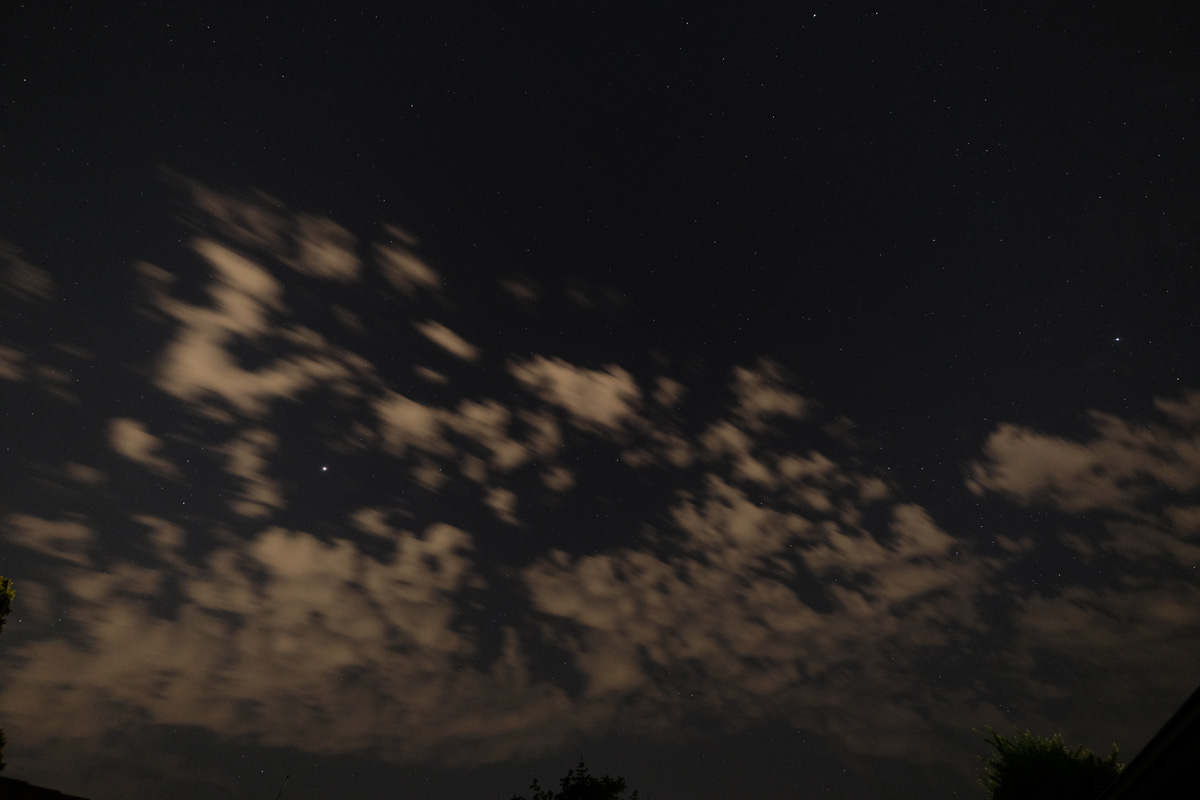

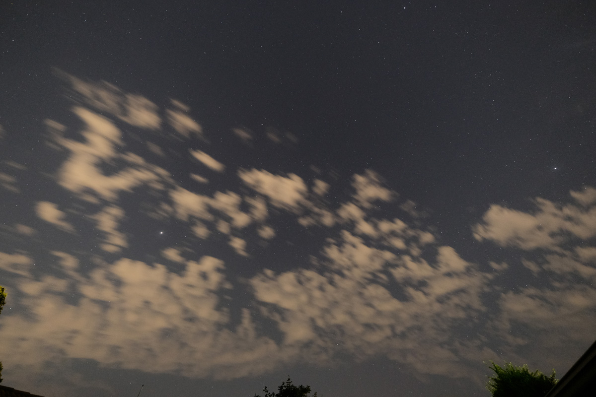

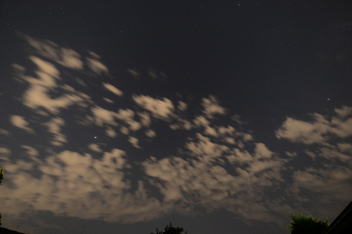

Take, for instance, the images I have attached, taken 15 sec apart.
DSCF1636 "chose" an iso of 1600
DSCF1637 "chose" an iso of 2000
DSCF1638 "chose" an iso of 1000
DSCF1639 "chose" an iso of 1250 (not posted here)
(I had to scale them down to post here)
All of thise leads to an unattractive flickering effect when all images are compiled into a timelapse in FCPX.

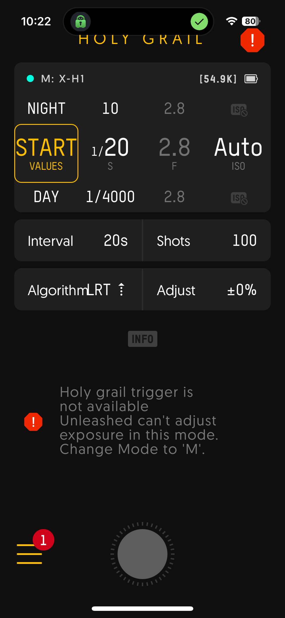

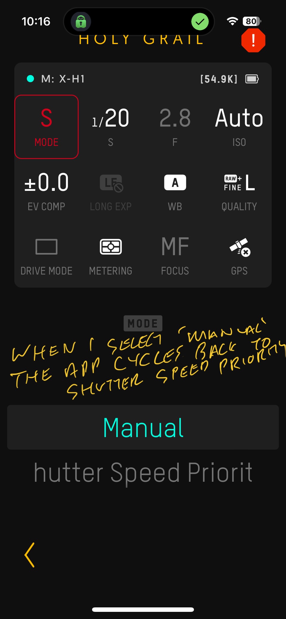

Problem I have is that when I set up using these settings, the app asks me to set mode to “M”.
I do this, but then the app automatically defers back to Shutter Speed Priority. I don’t have the ability to select M mode from within the app. The app will go no further until I select M mode, but it won’t allow me to do this as it automatically cycles back to shutter speed priority. https://youtube.com/shorts/AR4SV_mtfV4? ... mKjr5jLXEU
Looking forward to your solution!

The good news is that I have been able to set up my X-H1 to accomodate the settings that the Unleashed required. Fuji's menu system is diabolical but after some serious digging in the manual I have been able to set the "TACC" requirement so the Unleashed 22 can interact with the camera as it should and I can enter parameters properly.
The bad news is it seems something is going wrong with the ramping. I'll create another post in the bugs section which I think is the appropriate place for it.

Hi, and sorry for not replying last week.
Great that you found how to change the settings.
Yeah, Fuji is the only brand that does not follow the principle of starting with Program Mode, then determining which of the 3 exposure values can be adjusted, but does the opposite instead: Mode is determined by which of the exposure values are currently set to be "adjustable"...
The Unleashed and all its logic was designed for the "Mode first" cameras, so often for Fuji users, some of the Error messages might not intuitively make sense. Once you have found the right settings, you should be good to go though.
We'll check your other thread with the problems.
