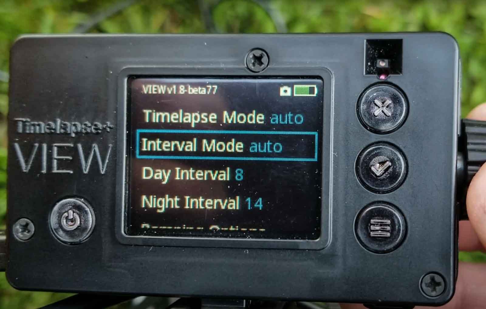

Below is the Timelape+VIEW interface for interval ramping:
Credit: https://www.youtube.com/watch?v=PR0I75v ... l=UH82NVME. I screen shot from UH82NVME's video

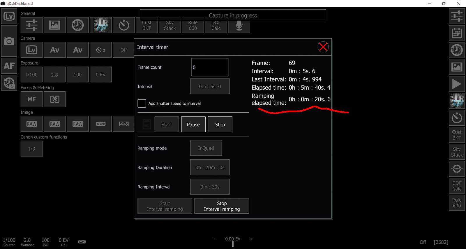

Another good example is qDslrDashboard, which is budget app and the windows/mac versions are totally free. It's a great app and it is able to do both bulb ramping and interval ramping automatically.
I played with it on my Windows laptop with my 5d4 (connected thru camera's WIFI). Here's how it handle the interval ramping, the UI is pretty flexible, totally user driven:
The initial interval is set to 5 secs, the target interval is 30 secs, the same as in my previous posts. And the duration of ramping from 5 secs to 30 secs is set to 20 mins. You dont want a ramping duration shorter than 10 mins, otherwise the acceleration is noticeable and rough.

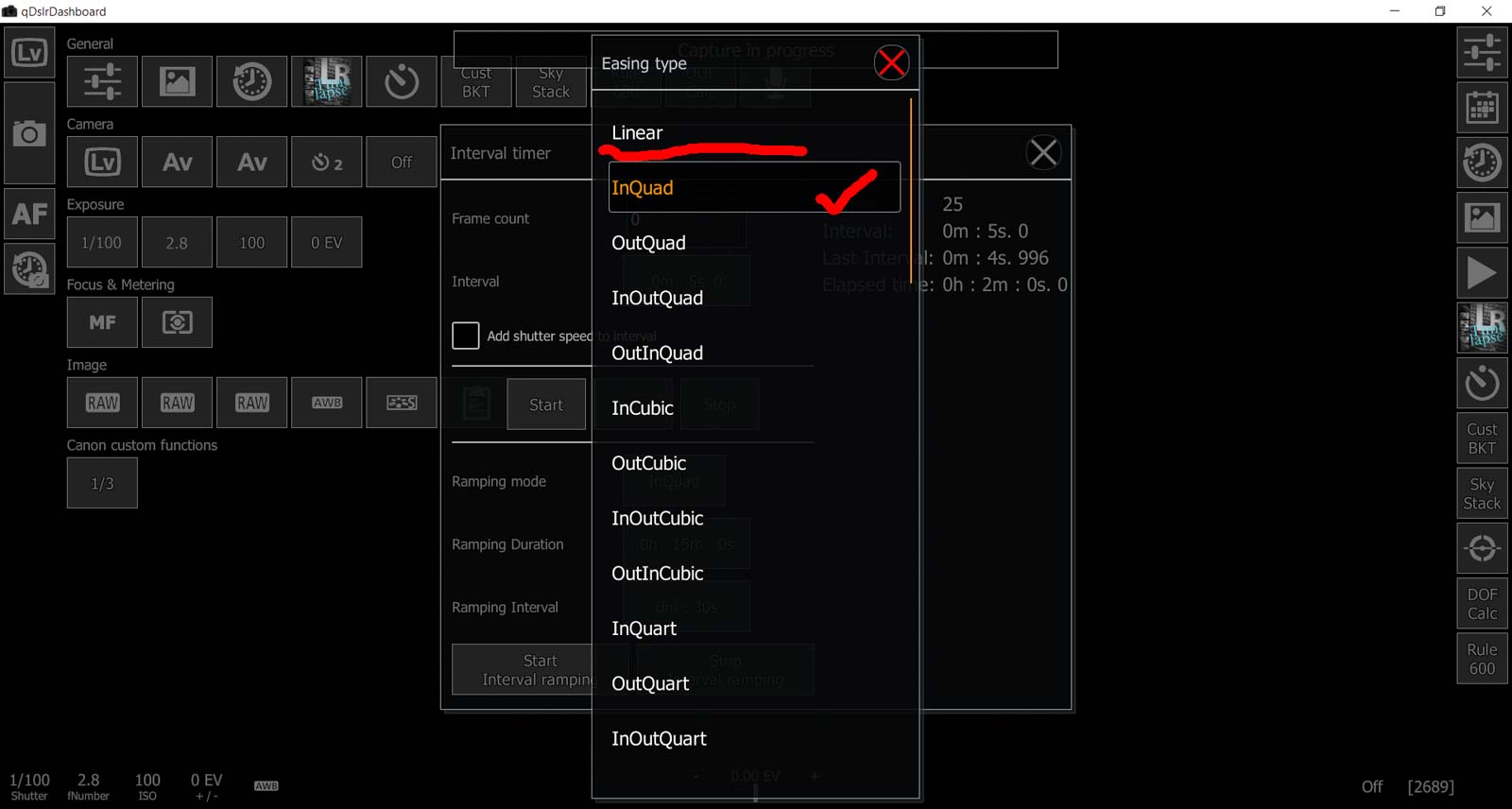

I prefer an exponential algorithm in the ramping mode as I mentioned before. The default is "Linear" though:
User can start/stop the ramping at anytime.
I like this free app, but you have to keep you computer or cell phone active all the time probably with a power bank. Sometimes the connection drops, sometimes the timer fires with wrong intervals.
