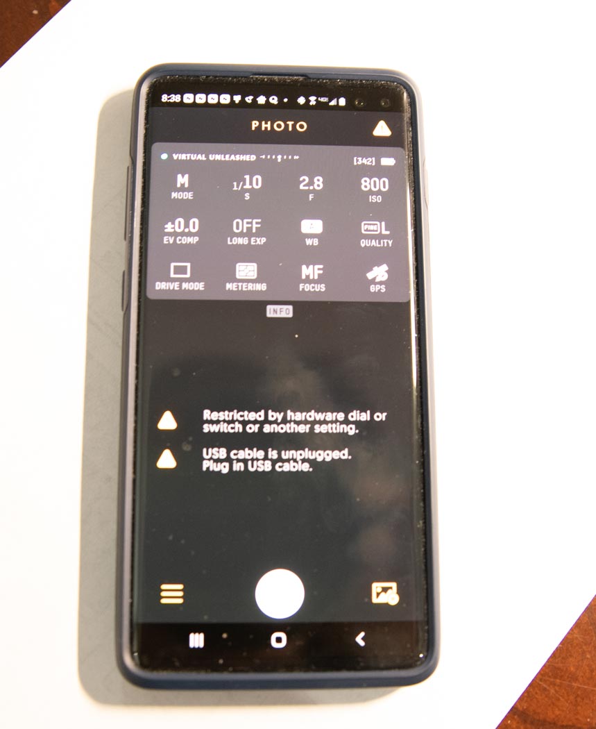

Thanks for the quick response. I think I've added a screen shot of the error message. I noticed none of the settings in the screen shot are the same settings as on the camera at that time, so I guess the unleashed is not communicating with the camera. I noticed in your instructional videos it appears the unleashed has a small light when connected. I don't see that light on mine.

OK, this is an easy one! ;-)
As you can see along the top of the app, it says "Virtual Unleashed". This means you have not yet paired the real Unleashed.
