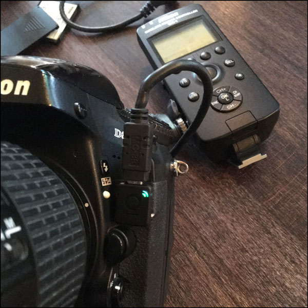

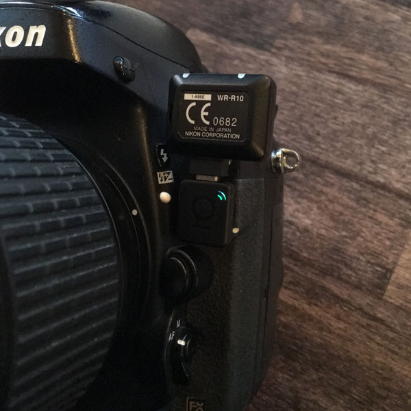

Almost. It does fit (on the N1, not so much on the N2 which is too close to the camera body), and we have made the pins of that plug compatible. however, we currently don't provide power to that port unless our custom USB cables. This is something we could change in a future firmware version though.
Any other MC-DC2 compatible remote release will work though - the pins are connected through to the round 10 pin port. I just tested - the WR-1 works so with power even the WR-R10 should work. However, what definitely does not (yet) work is that external flashes like the SB-5000 can be controlled with a WR-R10 plugged into an Unleashed N1. This is something we are looking into, and have made some preparations for, but it will require a lot of work in Firmware with a very low priority at the moment!
