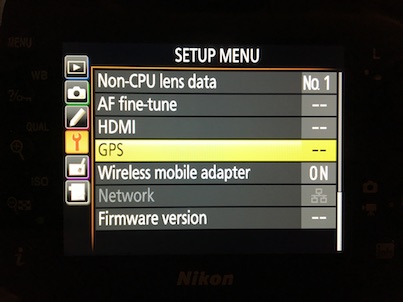

Hi, Sorry to hear that. Can you check if you have the "Location Data" or "GPS" item in your Setup menu (between HDMI and Wireless mobile adapter/Wifi)? This would be the sure check if your camera supports GPS at all, or if it's a version without this feature.
(how it looks on our D7100)
