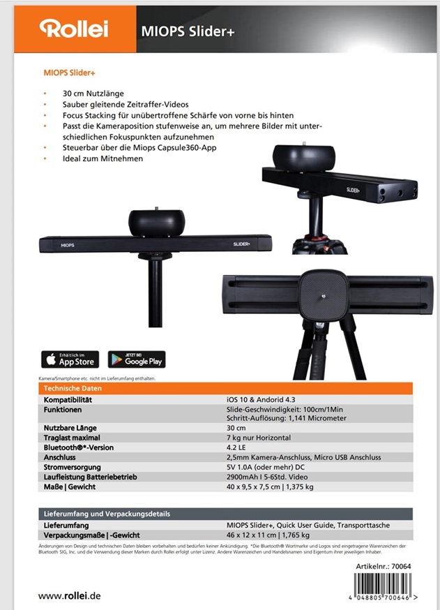

Did anyone test the UNLEASHED'22 with MIOPS slider+ (x-axis) and Capsule(s) (y/z axis) from Rollei?

Right now, only Syrp devices and Blackforestmotion PINE controllers are supported. We're planning to expand this in the future, but the devices have to be controllable via Bluetooth low energy to even be considered.

it supports BT 4.2 LE:

the nRF Connect output for the Capsule360 and the slider+

But unfortunately this shows us that they're using a single characteristic (Nordic UART Service) and will certainly have a proprietary protocol running over that. That will be a lot of effort to reverse engineer.
