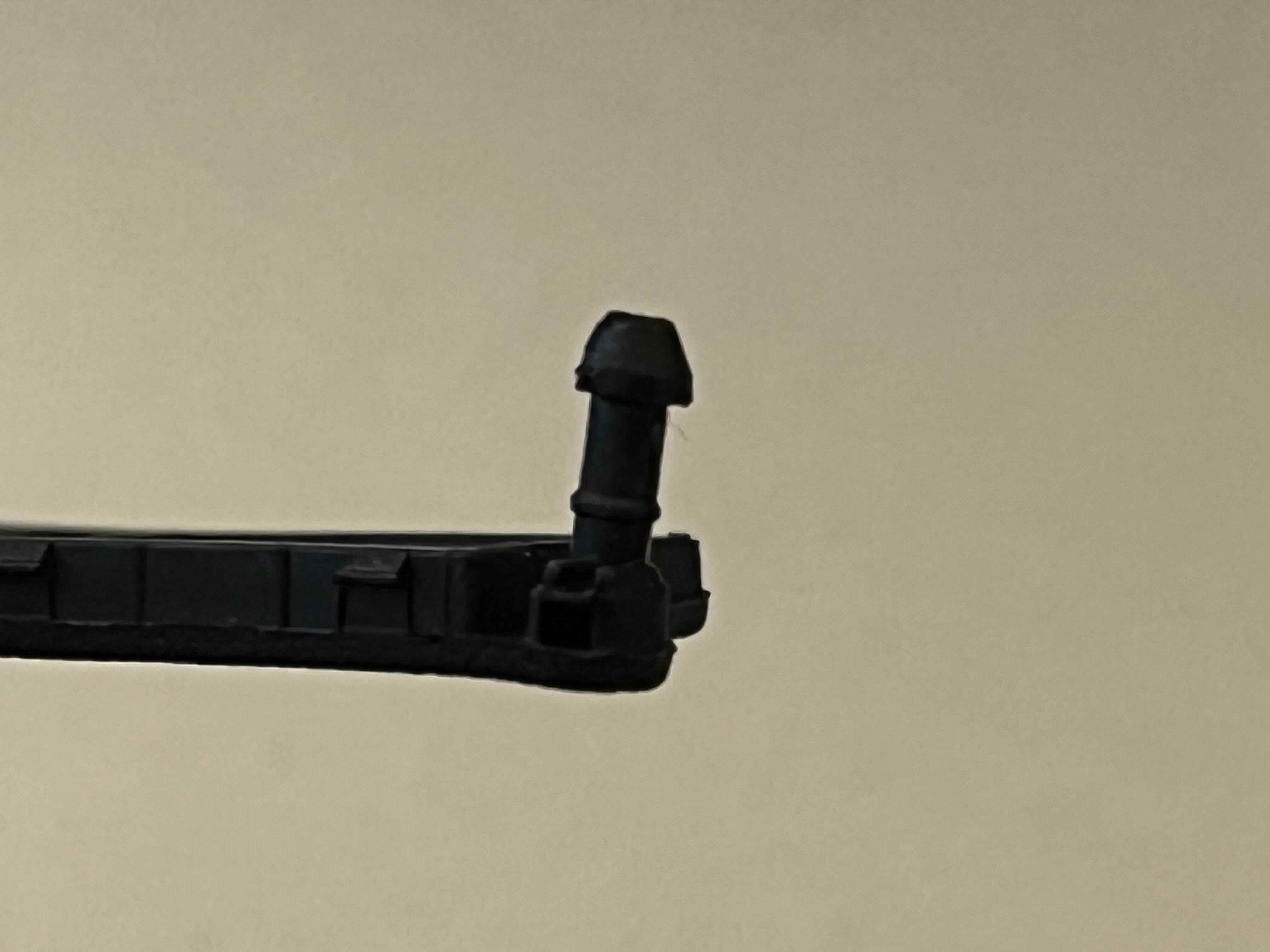

This is what the flap looks like when you pull it out:
Of course there's a risk of ripping off the part that goes into the camera, so please proceed at your own risk.
