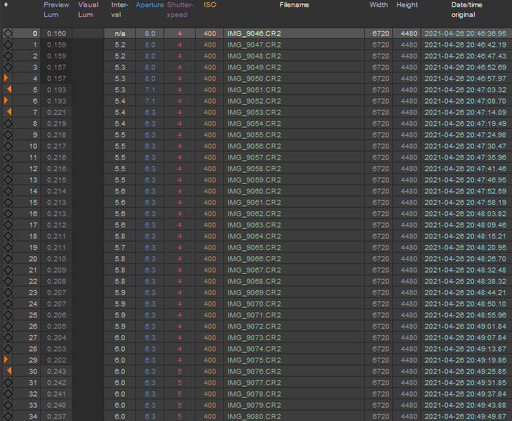

I experience the missing shots issue a lot when I do timelapse with LRTimelapse Pro Timer paired together with Unleashed.
When I used LRTimelapse Timer alone, and manually ramped the exposure with the camera dials, there's no missing shot:
No missing frames when manual.png (74.18 KiB) Viewed 14064 times

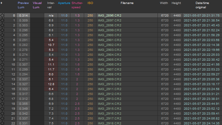

But whenever I used Unleash (in photo mode) to change the exposure settings while the LRTimelapse Timer is running, I always missed some shots although the interval is much longer than the shutter speed (I tried the faster shutter speeds, still the same issue):
Missing frames with Unleashed.png (51.55 KiB) Viewed 14064 times
Could it be possible that Unleash might block/interfere the shutter release when Unleash is changing the exposure settings?

The top screen on my Canon5d IV shows 'Busy' msg briefly right after the shutter is closed for each shot. I guess that's when the buffer is being written to the memory card. But when the shutter is open, which is triggered by the intervalometer, there's no 'Busy' warning.
do you make the change from our app immediately after a shot, so that there's a long pause before the next time it should trigger? and does the change get carried out successfully?
Since the time difference btw my shutter speed and interval is only around 2~3 seconds, it's hard to change the setting exactly right after a shot. So, there's no long pause. Sometimes I had to try multiple times to get the setting applied. I just kept trying, and I didn't pay attention whether the shutter was open or closed. This is the part I suspect to have caused those missing shots, that the shutter was blocked when I made any changes from Unleashed app.
I guess the two devices have to be synchronized if the camera doesn't supports multi thread operations, otherwise their operations could block each other. Any suggestions? I really don't want to leave a 5 second gap between the shots.
