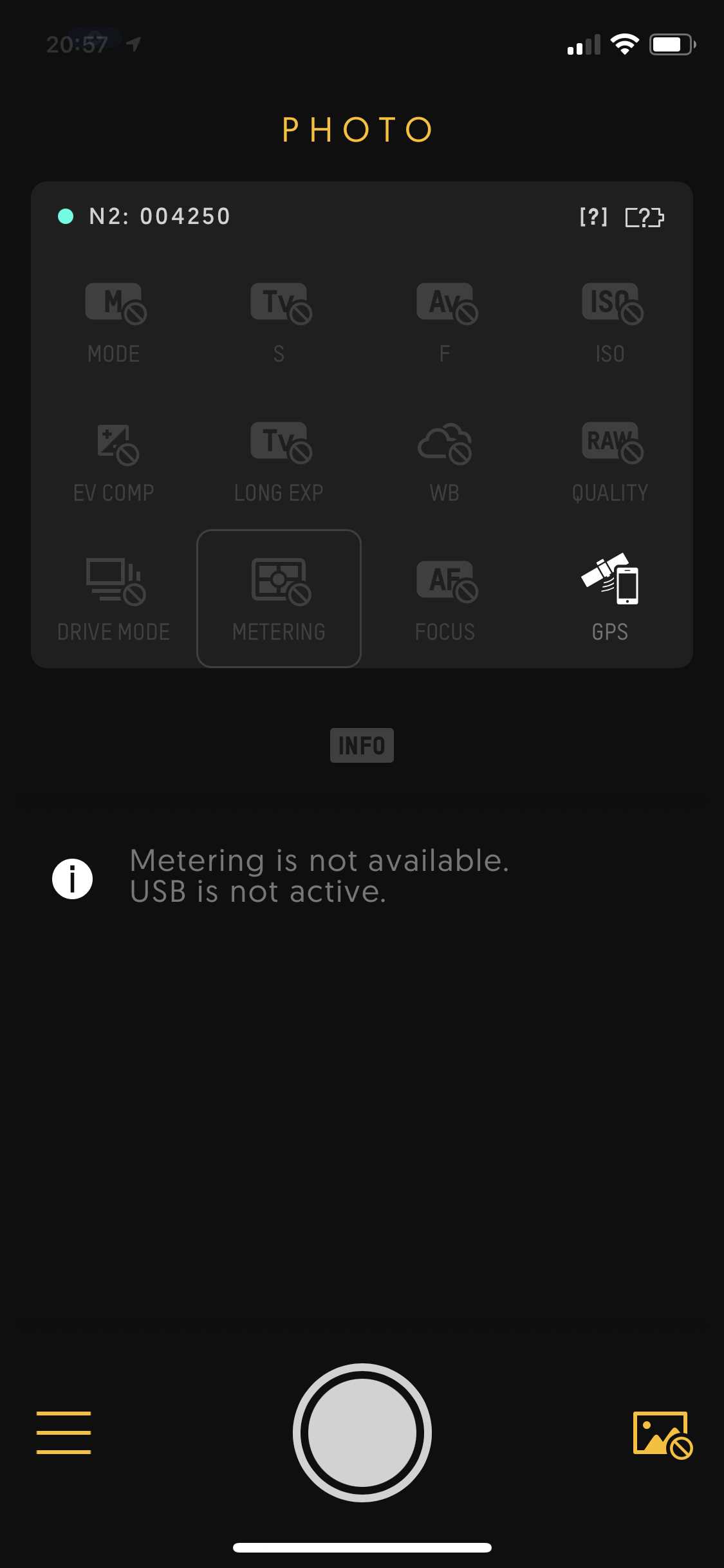

Tapping on the grayed out settings give nothing except for the metering one. Then the feedback is ‘metering is not available. USB is not active.

Could you make a snapshot of the App screen on your smartphone to see what options are grayed out? Press volume down + power button at the same time to make a snapshot/screenshot.

printscreen of the app attached.

Notice anything? I see from the screenshot of the App that the App has not as name the name of the camera (should be N2:D90, not N2:004250). To me this COULD mean that the USB cable is incorrectly installed. I am not saying it is, but could be.

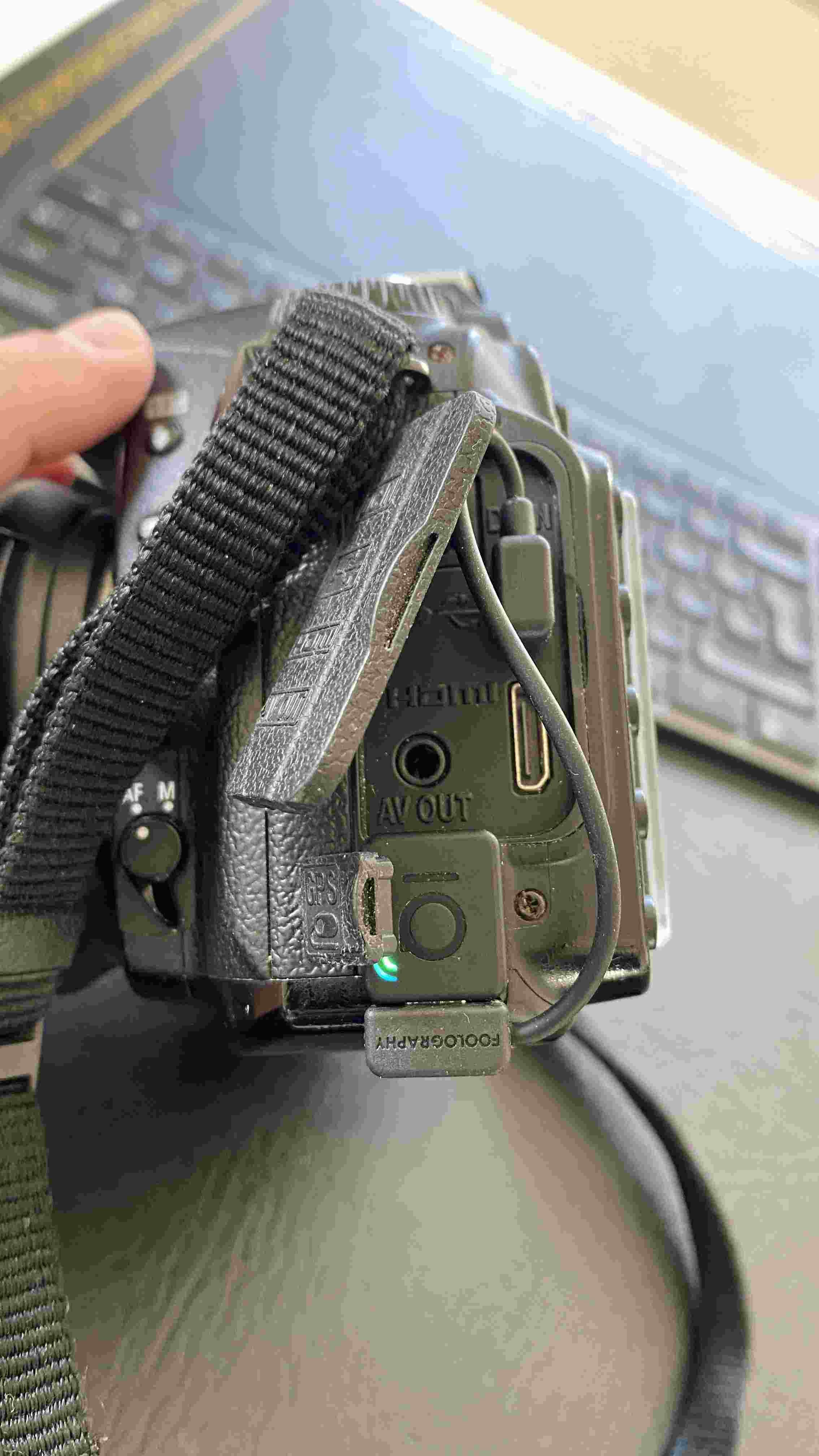

Could you make a photo with your iPhone of the D90 with the Unleashed N2 connected, including the USB cable attached. Maybe that is the problem. I had this problem when I still had my D90, before it finally gave up the ghost due to mirror-of-death problem (mirror stuck for good).
The App should report N2:D90!

Photo attached.
