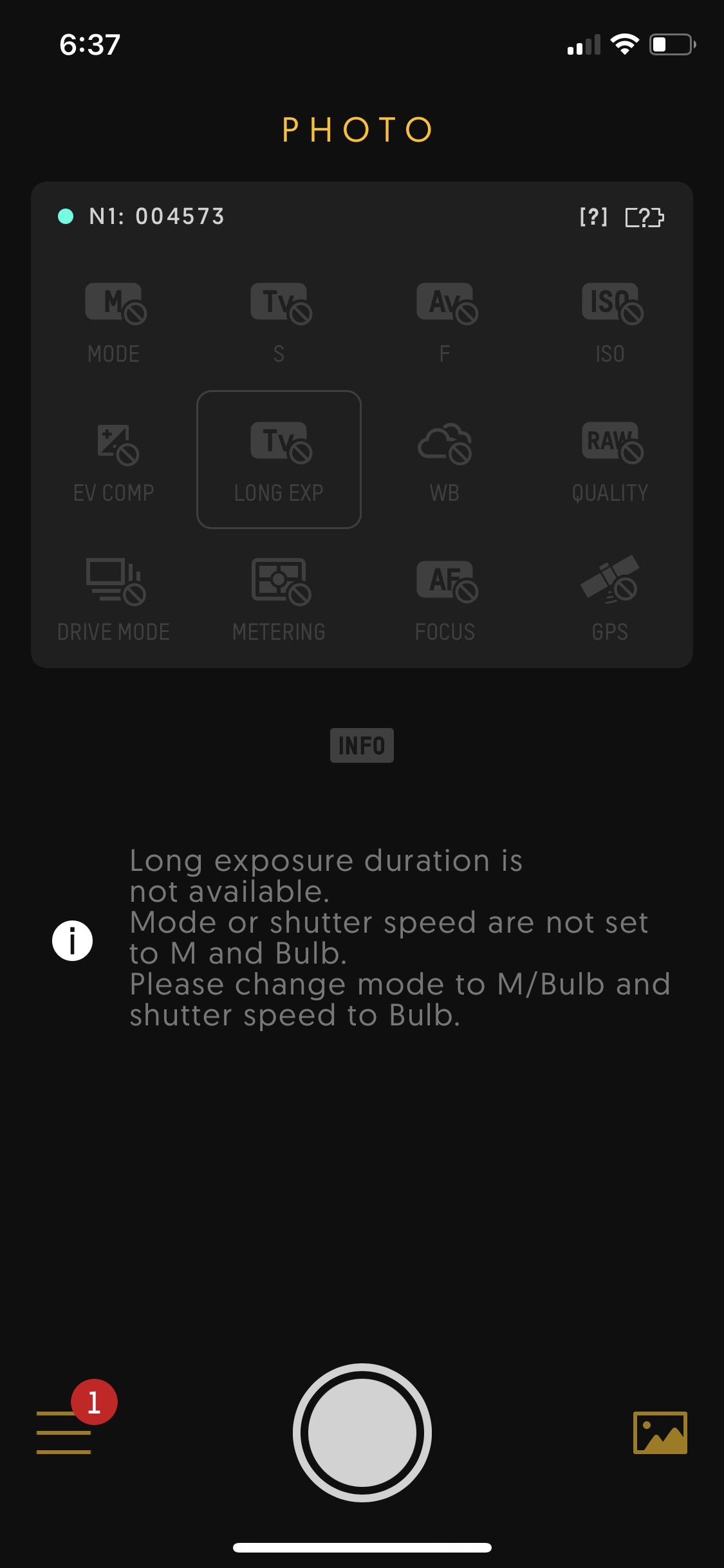

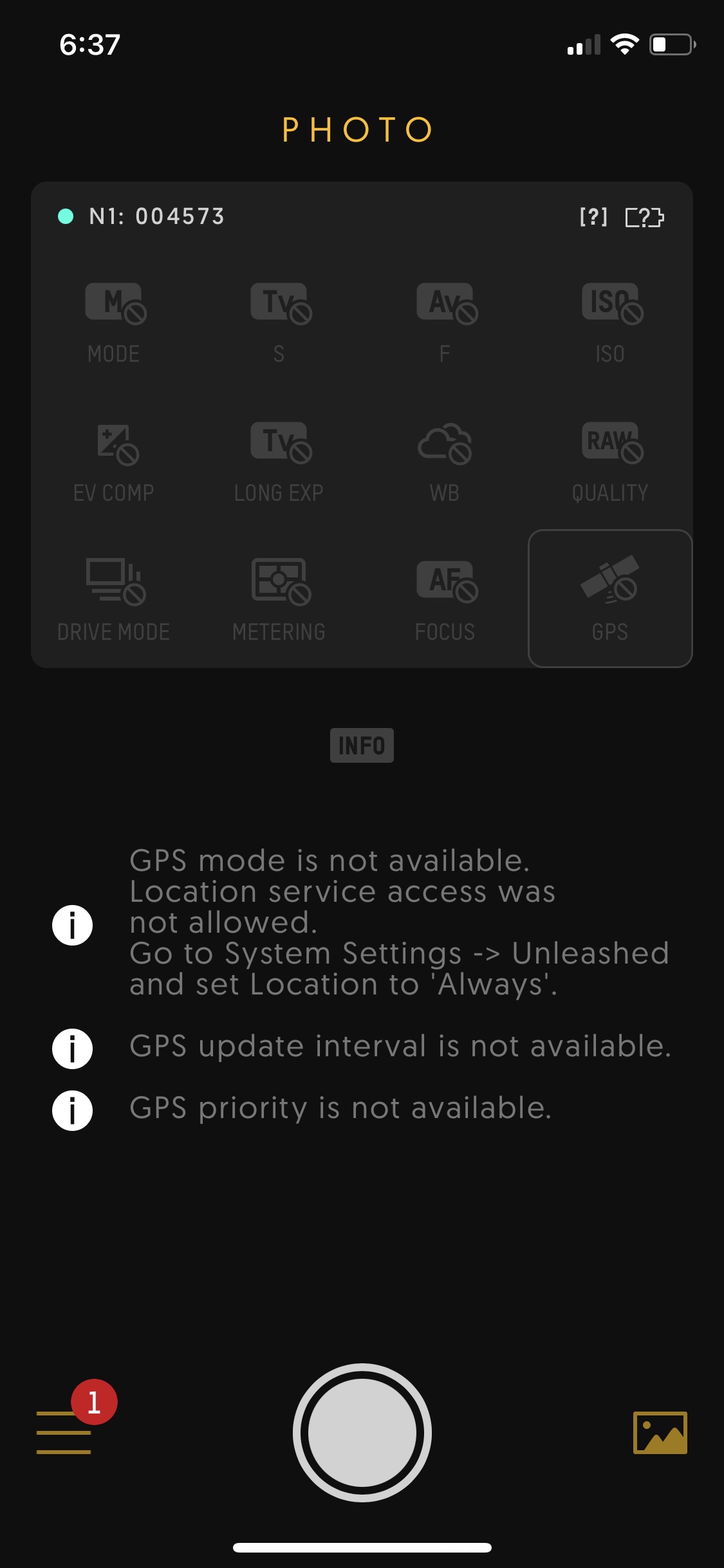

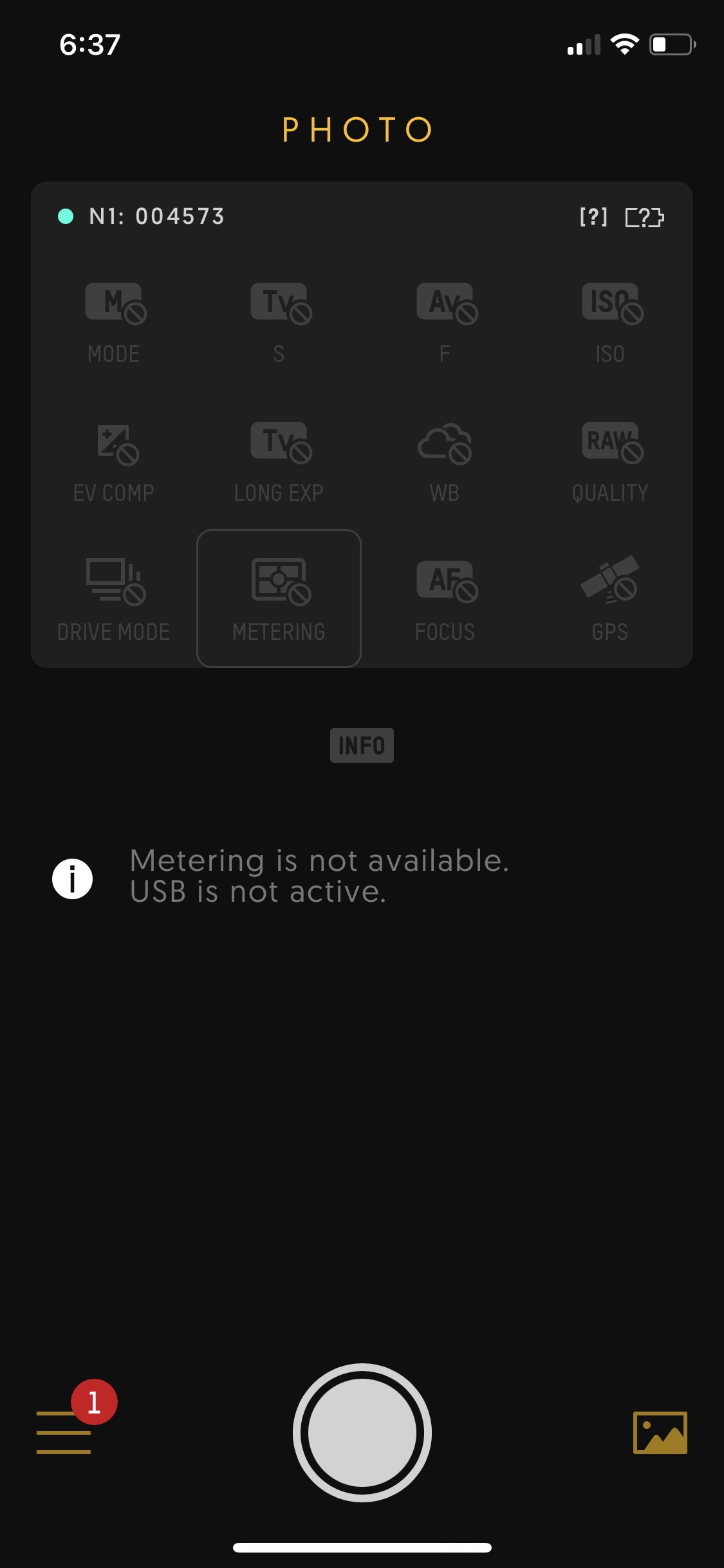

I’ve attached 3 screenshots of the only 3 buttons that show a message. All the others are non-resposive.

3) Tried the 'Metering' option in app and it said "metering is not available. USB mode not set to PTP blah blah blah". (screenshot attached)
4) Set USB mode on camera to PTP and turned off/on camera per instructions in app.
5) New message appears when pressing Metering option: "Metering is not available. USB is not active." (screenshot attached)
Perhaps a faulty USB cable from N1 to camera? I've attached more screenshots to show above.
