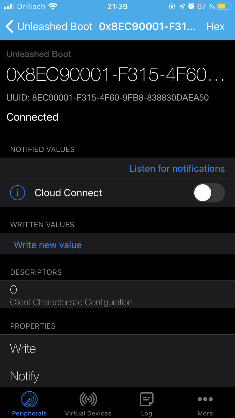

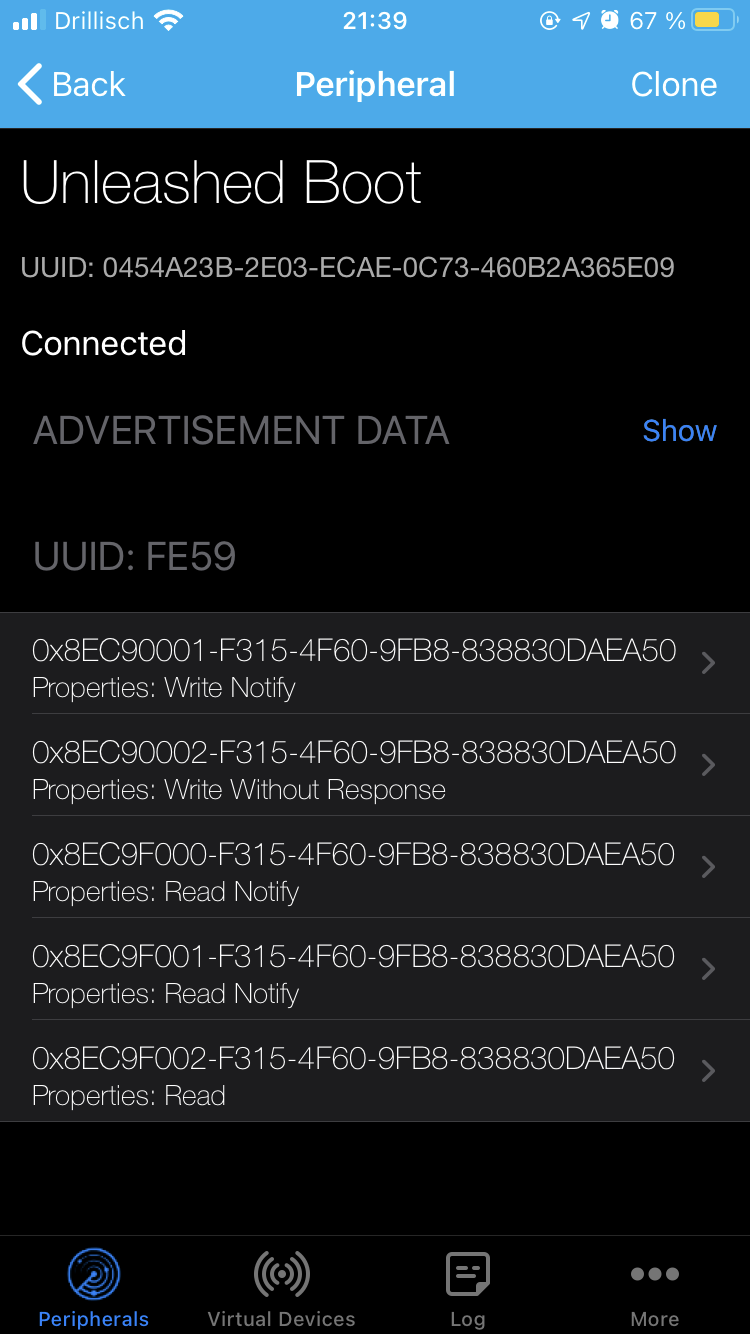

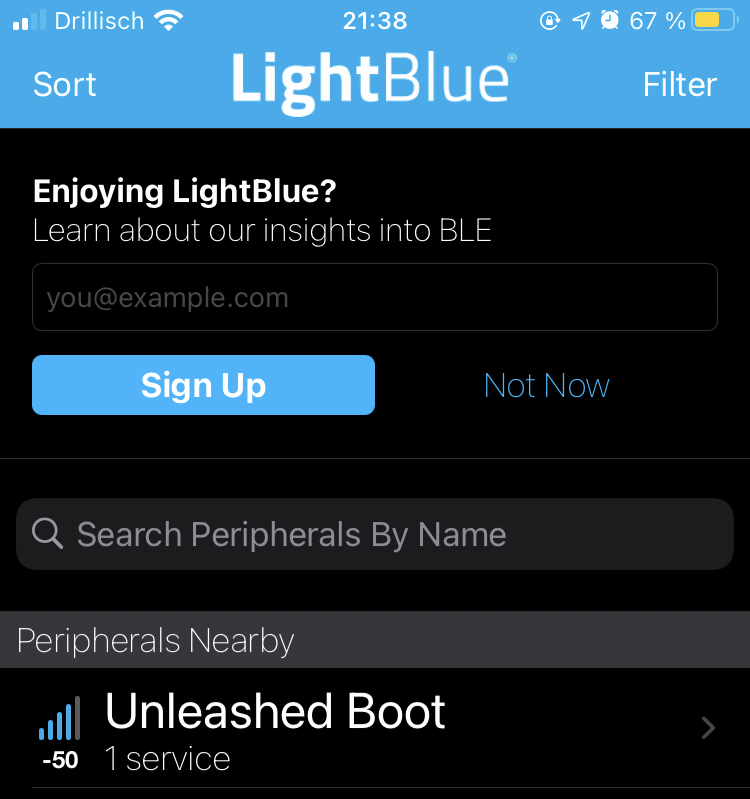

By the looks of it, I wouldn't count on it. You can try to reset it manually with another app.
- Download a Bluetooth scanner app such as Lightblue (icon looks like a blue fist)
- Connect to the device called Unleashed Boot:
- Select the first item on the list, the one that says write notify:
- Tap on the listen to notifications button, then on write new value button, then write 20 and tap on done
- Your Unleashed should reboot then.
Hope that helps

Hei Andy,
Thanks. I installed the app, and I managed to connect.

December 14th, 2020, 10:18 pm
Do you see the same items on the list as the ones in the screenshot?

slightly different, i'm using Android. Should i switch to iPhone?
December 14th, 2020, 10:30 pm
Shouldn’t be necessary, you should still see the same numbers and text, even if the UI is different
now i'm on iphone. it is identical to your screens

December 14th, 2020, 10:31 pm
But still i'm not sure what i should do. Should i write new value, or?
