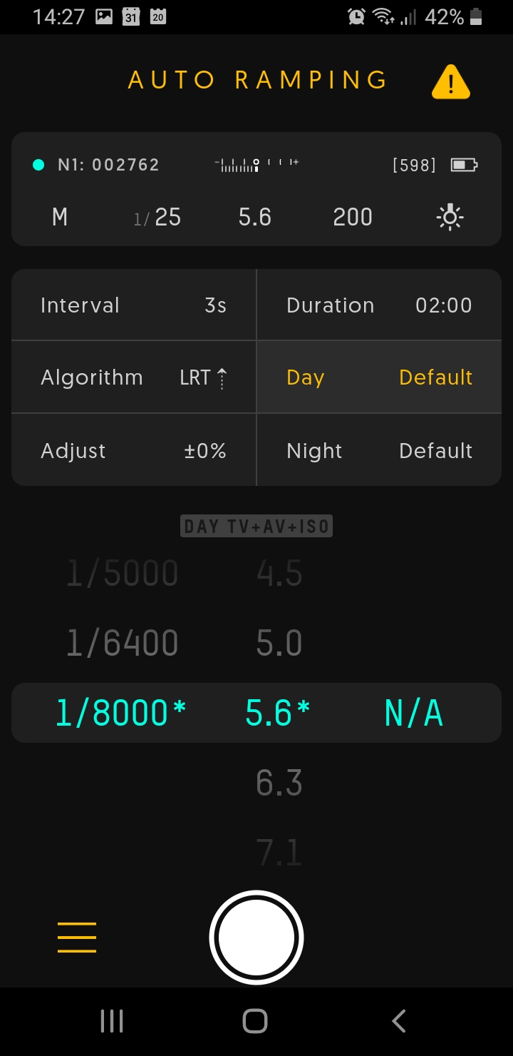

just received brand new N1, no issues pairing with my phone once installed on my Nikon D700. I'm able to manage all camera settings, take pictures and review them. When using ramping mode, when I click on "DAy" and "Night" settings, the ISO settings is marked as "unavailable" and I'm not able to set min and max ISO for my holy-grail TL. Is this an issue with my device or camera?

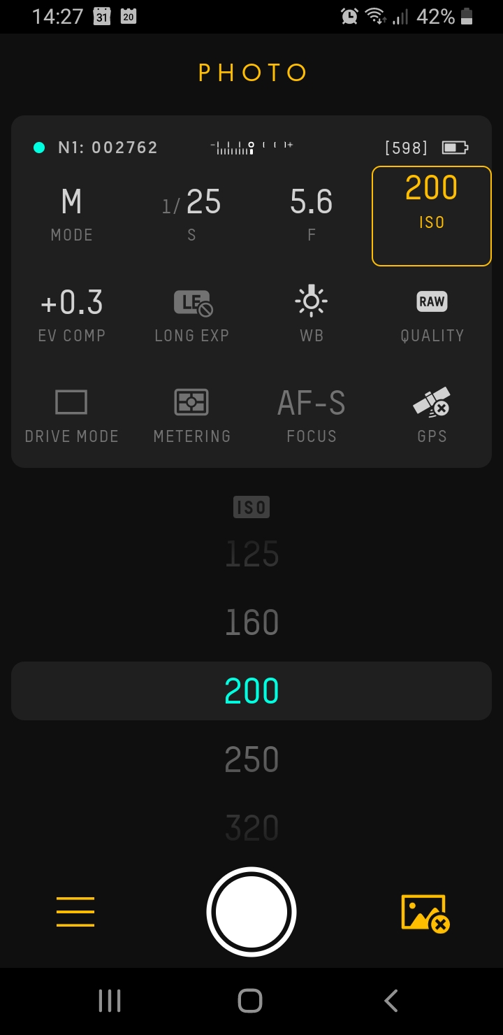

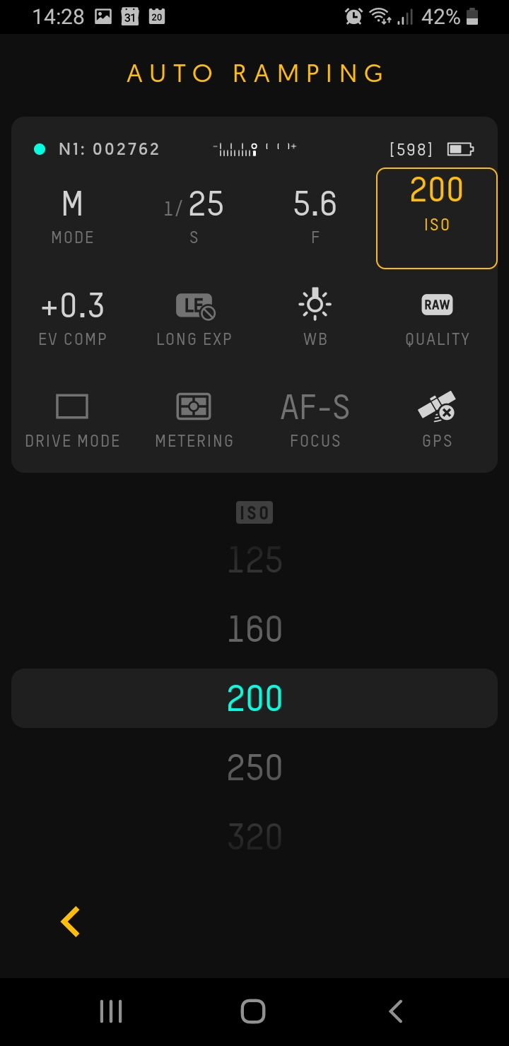

can you send me a screenshot of both the normal ISO setting (tap on ISO in the Photo screen) and of the day limits on the Autoramp screen?

Auto ISO setting was my first concern, I double checked it and can confirm that it's disabled. During timelapses I work in full manual settings (M mode, no AF, daylight WB, fixed ISO).
Please find attached the requested screenshots.

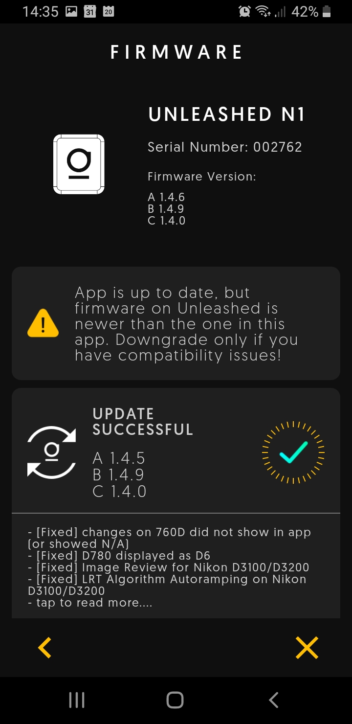

- after first binding, I performed a firmware update as suggested, now in device's settings I find a warning that suggest to downgrade firmware to avoid compatibility issues, when I start it, downgrade completes successfully but fw version doesn't change. See attached screenshot

Hi Paolo, this could have to do with the ISO limits being N/A.
We'll have a look what happened there.
On a sunset, we first decrease shutterspeed down to the night limit then open aperture then increase ISO.
On a sunrise, we decrease ISO down to the day limit, then close the aperture, then increase shutterspeed.
If you set one or more of the limits to the current value, we won't ramp that setting.
We'll also have a look at the firmware version mismatch and the downgrade message, It looks like we just forgot to update the version number saved in the app, as we released A1.4.5 and A1.4.6 very shortly one after the other.
