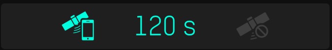

i did a test, The gps act normaly without the usb cable.
i have to set the latency and select phone or ipad GPs.
but i dont understand the meaning of the 3e icone
Annotation 2020-01-24 181332.jpg (8.57 KiB) Viewed 12919 times

We also explain the meaning of the third picker.

The USB cable only has a positive effect on the GPS functionality when the app is in the foreground and actively being used:
Without the cable, the Unleashed gets and sets settings on the camera using a protocol over the same pins of the 10-pin port that we also send GPS data to the camera over. We only get and set settings while the App is in the foreground.
When the GPS Priority (third picker) is set to "GPS", and you trigger the camera from the app, we do the following:
  1. stop the settings protocol asap
  2. wait 200-500ms so Camera will accept GPS protocol
  3. change to GPS protocol, and send a complete set of GPS data to camera
  4. wait about 200ms for the GPS data to complete transferring
  5. trigger camera
This guarantees that GPS data will be saved in each photo.
When the App is in the background, we disable the Settings protocol entirely and are always on the GPS Protocol, so there's no need to "switch protocols", therefore there is no delay, and hence no need for a "priority", since we can trigger instantly and still have GPS data in the photos.
Same thing when the USB cable is plugged in: we disable the Settings protocol through the GPS Pins, and get/set settings through USB. So again we can always send GPS data through the 10-pin-port at the same time, again making GPS Priority unnecessary (which is why it gets greyed out as in your screenshot).
