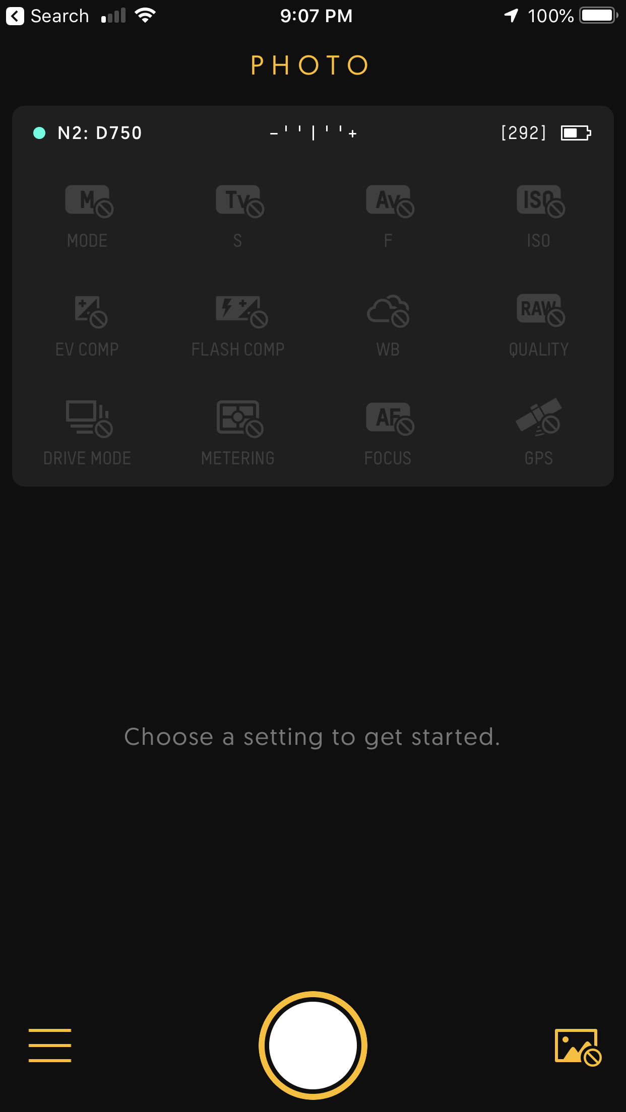

Here's the screen shot.

The app is indeed saying that the camera is shooting. You can tell by the yellow ring in the trigger button. We will have to investigate with a D750 because that information comes from hardware, not software. That means that your camera is not behaving as we expect it to.

So the yellow ring is there when the shutter is open?
Because I’m not shooting long exposures or anything. It’s set to aperture priority f8, looking out the window, with minimal 1/125 shutter speed to make the ISO adjust.

can you tap one of the settings and send another screenshot, to show us the error?
