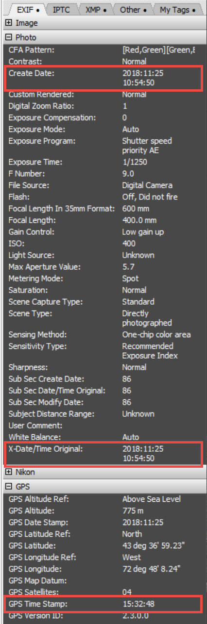

Having the same issue. Here are the details of how I experienced the issue in case it's helpful to fix:
Using the N2 with my D7200, spent the morning shooting approximately 450 images. The first 24 all had date/time stamps (except GPS Time) with values 22:02 (22 minutes, 2 seconds) in the future (ahead of GPS Time). GPS Time looks correct for those 24 images. Those 24 images were taken over a period of 3:45 (3 minutes, 45 seconds). All images taken for the rest of the day had correct time values.
If I understand, setting the "Set clock from satellite" option to OFF will avoid this issue until a FW update is available?
My FW, A1.0 B1.0 C1.1. Any ETA on a FW update?

Hi Mark,
Yes, disable the "Set time from GPS" setting in the camera in order to avoid this behavior. The fix for this issue is coming in the next couple of weeks.
