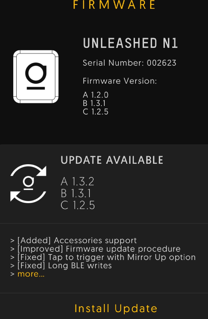

I received a new Unleashed on June 22nd and could not update it. I sent two emails to the support address and have so far been ignored. It is the N1, connected to a D300. I’ve tried all sorts of ways to get the update to complete but it always, always fails.

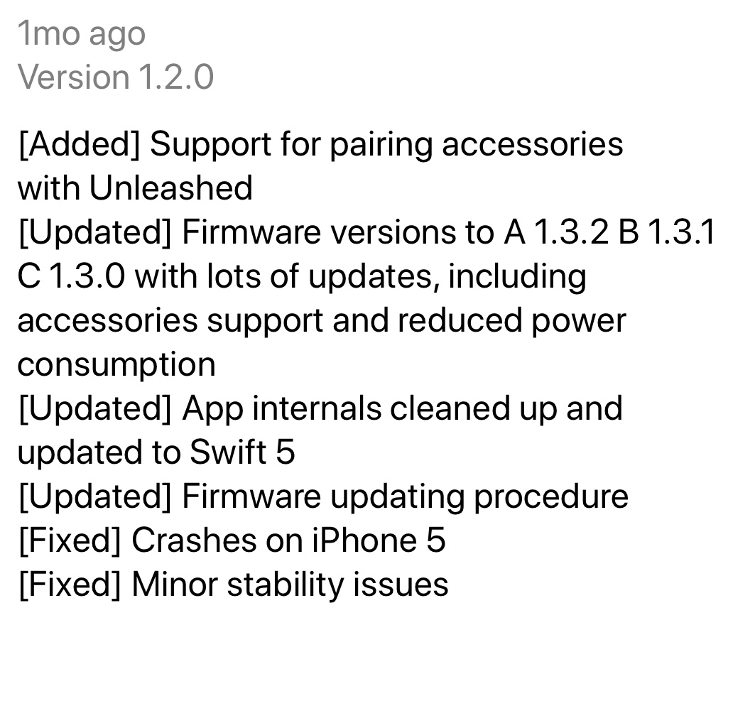

I attached a couple of images in my second email and I will attach them to this post in case this is the only way to get someone’s attention. The images are screenshots from my iPad mini 2, running IOS 12.3.1. One image shows the verbiage from the app’s info on the app store. The other shows the app’s info while connected to the Unleashed.
While the verbiage from the app’s description says the C firmware update is 1.3.0, when connected the app is saying 1.2.5 is the available C update. Something ain’t right.
Some help would be appreciated.

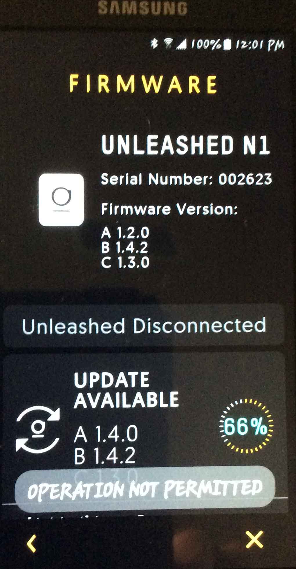

Some progress, but not enough! I was notified on my phone that an updated version (1.3.0) of the Unleashed app for Android was available so I installed it and attempted the firmware update again. Segments C and B are now up to date (see attached screenshot), but segment A will not update. I retried several times. I didn't go back and try the IOS app because it still shows segment C as 1.2.5.
Now what?
Now what?

Thanks, Oliver. I did update the app and I have tried numerous times to update the device. I did see it (your code) has been modified to bypass updates to segments that are up to date. Kudos for that! The update process immediately goes to “Updating A” now but the progress wheel never makes a move. It “tries” to update for maybe 10 seconds before displaying the failure message. I will give your suggestions a try and let you know. Get some sleep! 😀
