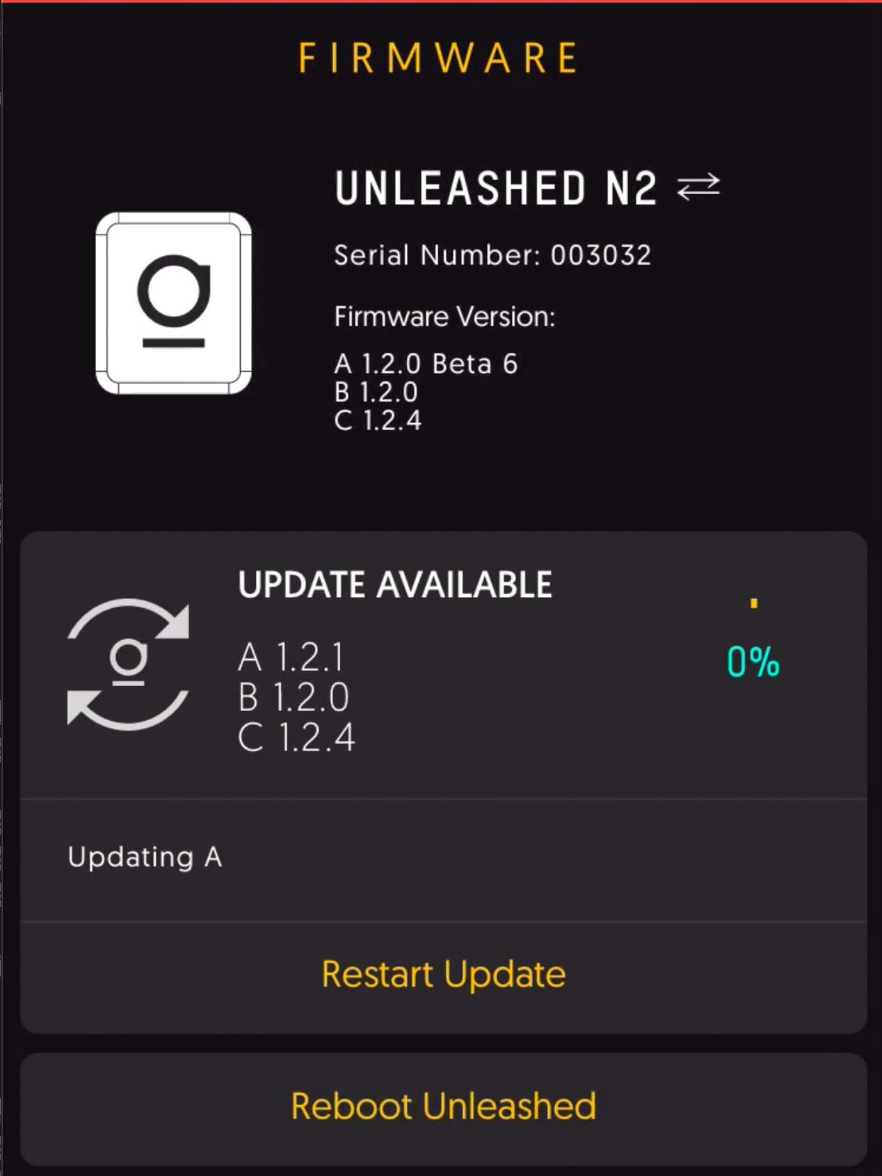

I do believe it's on the "A" upgrade. This is screen right before it fails...

The firmware update does the update in the order C -> B -> A
So C and B were successful, but A is failing (the most common case)
Do give it a few tries, and hopefully it will work at some point.
