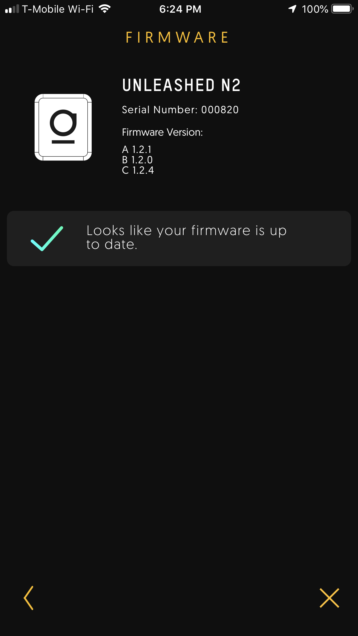

I tried it again to verify that the problems still occur. Yes plug it in and the Z7 menus don't work fully. Unplug the Unleashed and they're fine. Plug the Unleashed into the camera again and the menus are borked.
I managed to do a firmware update.
In general in Photo mode the shutter has gray or gold ring. But ALL of the control icons are disabled (grayed out) except for GPS. I tap the shutter button repeatedly and it won't trigger the shutter at all like it did previously. There is haptic feedback but nothing.
Then if I toggle the power on the Z7, all the control icons in the Photo mode are active and I can tap them and see the values I can set. But still the shutter button doesn't work on the camera and eventually all of the control icons dim again.
The GPS data is being sent from the Unleashed app. to the Z7 though, because when I take pictures, I see the UTC time changing. I can't review the pics because the Menu and the D-pad are non-functional with the Unleashed connected.

Here are the screenshots but only one is under the limit apparently. All of them are 280 kB or greater.

Hi just tried 1.4.0, 1.4.2 and 1.3.0 on my Z7.
Initially, it looked like the same behavior.
But I couldn't even trigger the shutter.
Then I toggled the Unleashed power on and off and I could trigger the shutter again. What's more, I could use the controls on the back of my Z7.
I tried video, still doesn't work, still says camera is still shooting.

If the firmware updates haven't made a difference until now, then you almost certainly have a defective Unleashed. We'll swap it for you. please send an email with your current billing & shipping address and a request for RMA information to support@foolography.com
