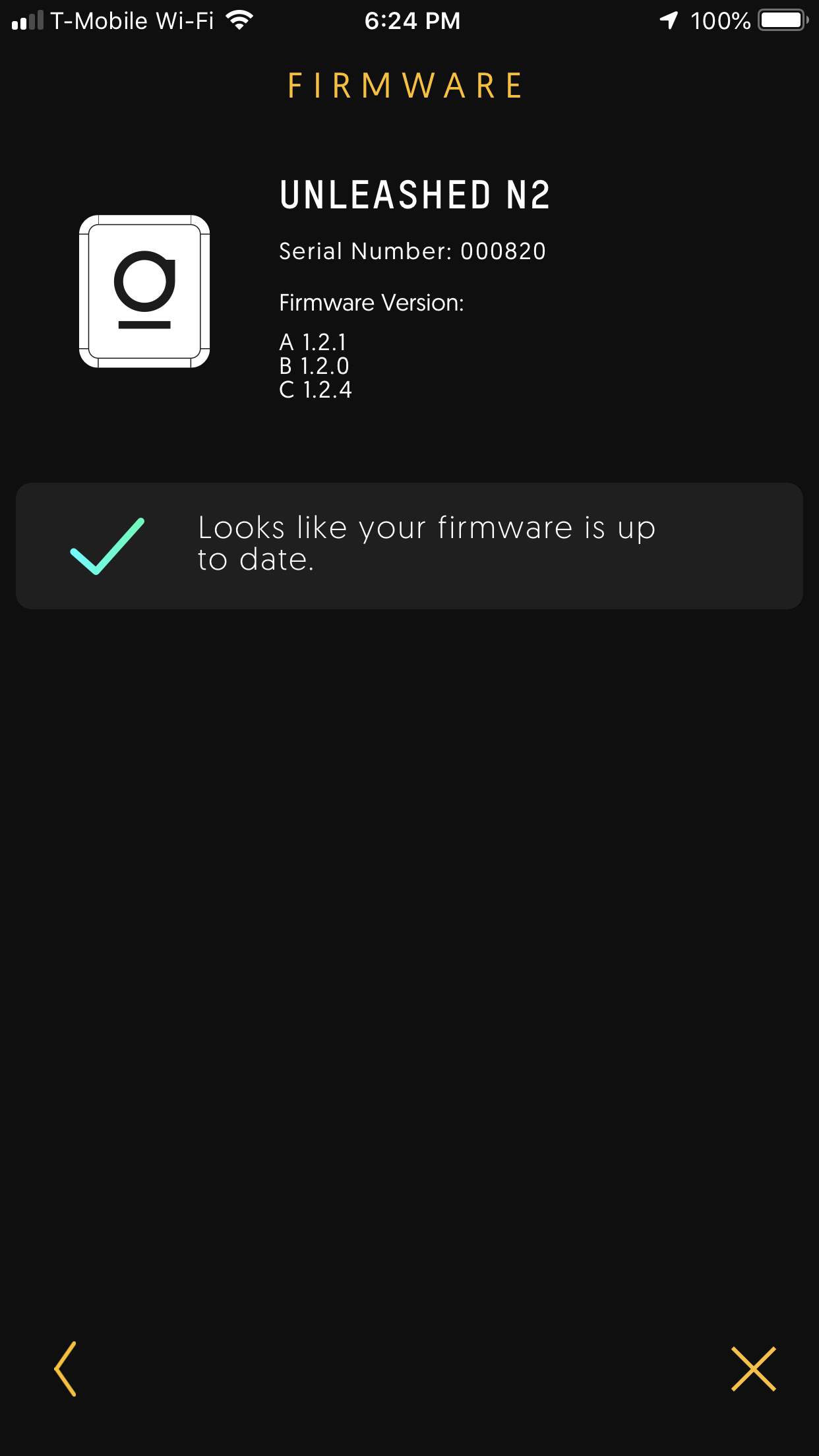

I managed to do a firmware update.

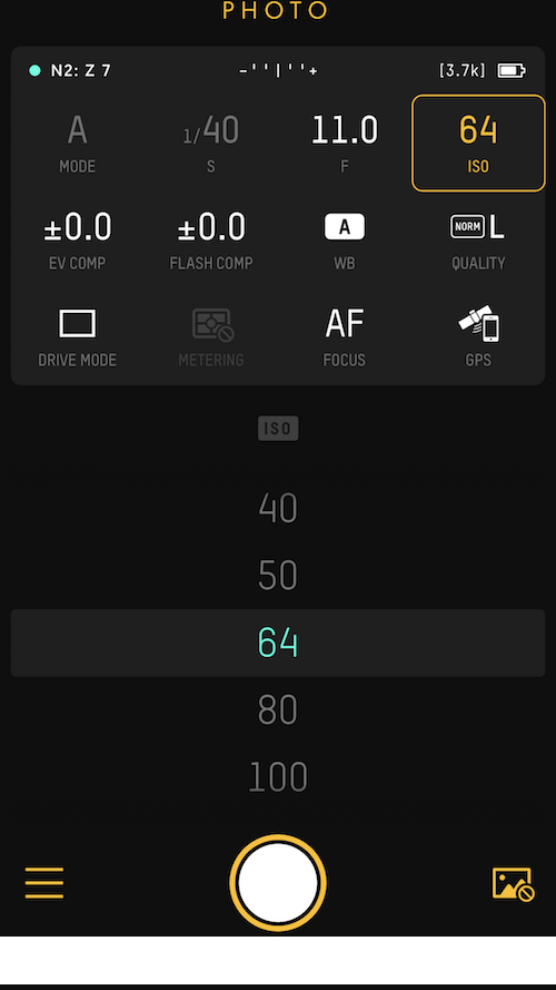

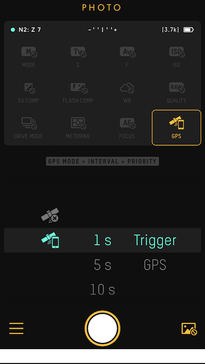

In general in Photo mode the shutter has gray or gold ring. But ALL of the control icons are disabled (grayed out) except for GPS. I tap the shutter button repeatedly and it won't trigger the shutter at all like it did previously. There is haptic feedback but nothing.
Then if I toggle the power on the Z7, all the control icons in the Photo mode are active and I can tap them and see the values I can set. But still the shutter button doesn't work on the camera and eventually all of the control icons dim again.

Here are the screenshots but only one is under the limit apparently. All of them are 280 kB or greater.

If you're seeing the yellow ring around the triggerbutton, that means the Unleashed is getting the info that the camera is currently taking a photo. That's why the app blocks the video and timelapse screens (to protect you from trying to start a video/timelapse, while the camera is shooting - eg during a long exposure).
