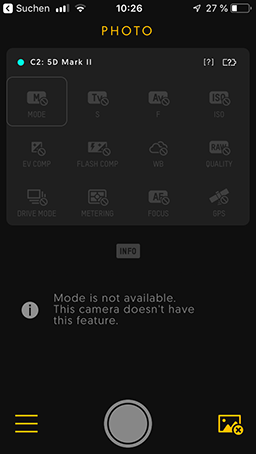

I have a Canon EOS 5D Mark II and the C2 does not work! It is connected to the app (turqoise dot).
But features are greyed out in the app (tried it with Iphone 5 SE and Ipad Pro 10.5). When selecting a feature it says: "Mode is not available. This camera doesn't have this feature." or "lense not attached." (Manual, TV, AV-Mode,...) or in other features (e.g. ISO-setting) it says "ISO is not available. Unknown error." Photo trigger also states "unknown error".
Tried it with full battery and empty Compact-Flash-Card. There is a question mark over the battery icon in the app and also next to it on the left a question mark in brackets (displays the number of pictures, I assume). On the far left where the turqoise dot is it said "C2: Canon 5D Mark II" in the beginning - now it says: "C2: 001462" (my serial number).
I also tried what Chris did above, nothing works!
Christoph

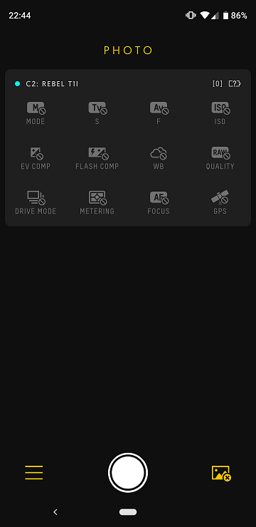

I have the same issue as square's post:
The photo trigger button does work on mine however...
I'm using my C2 with a Canon Rebel T1i / 500D (FW 1.1.2) and running the Android variant of the app (v0.9.3) (Google Pixel 3XL Android 9)
2018-11-05 22.44.09.png (28.78 KiB) Viewed 59036 times
Thanks
