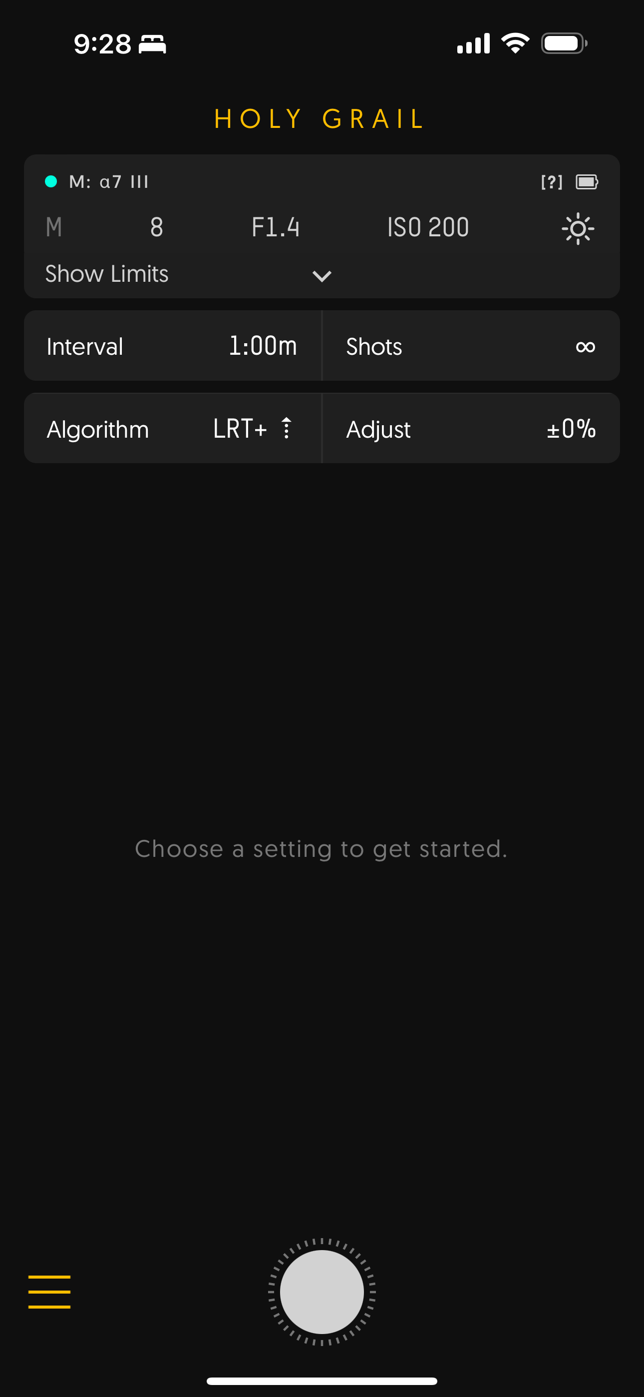

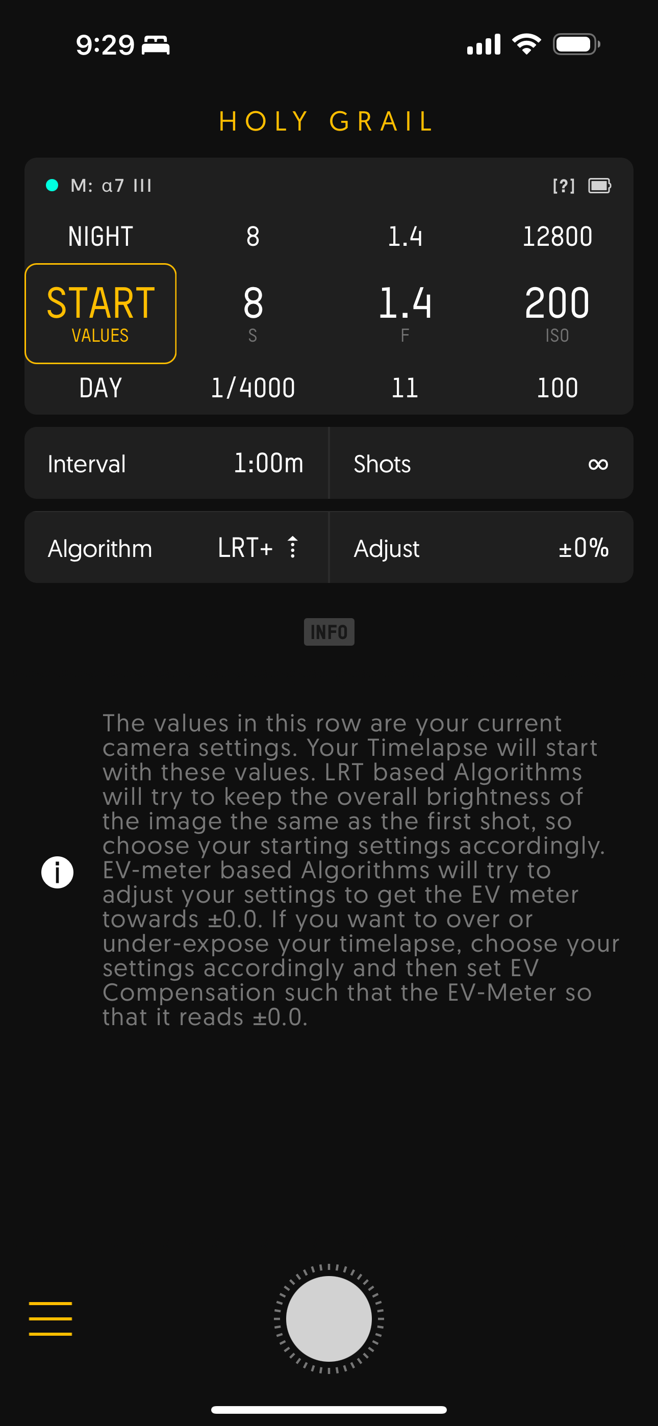

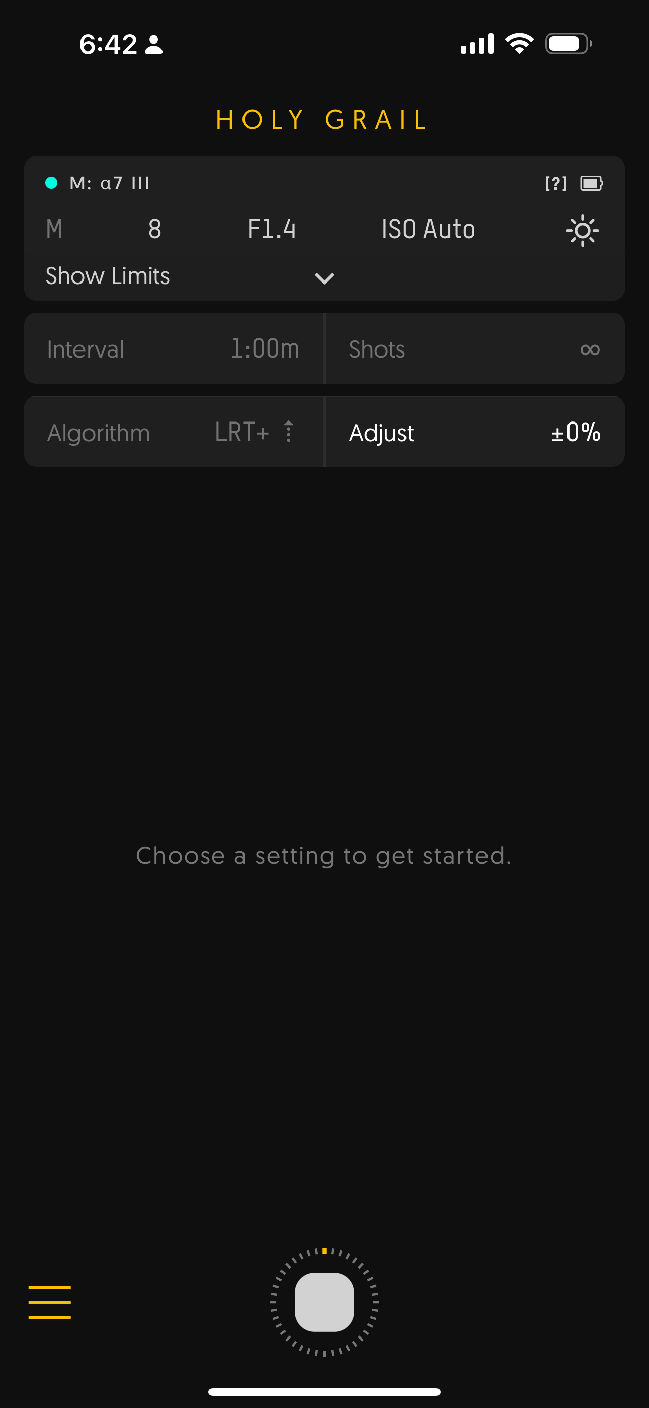

Sony A7r3 and iphone 15 pro max. In the last 2 overnight tests of a sunrise I have done I have had the ISO change to 'auto ISO' overnight, even though auto ISO was not chosen in any of the starting settings. Screen shots attached.
Any ideas what might be going on?
It is certainly not what I want to happen. I want ISO to be ramped appropriately as chosen.
Start Settings at 9.30 pm
Settings at 6.30 am the following morning - note ISO change

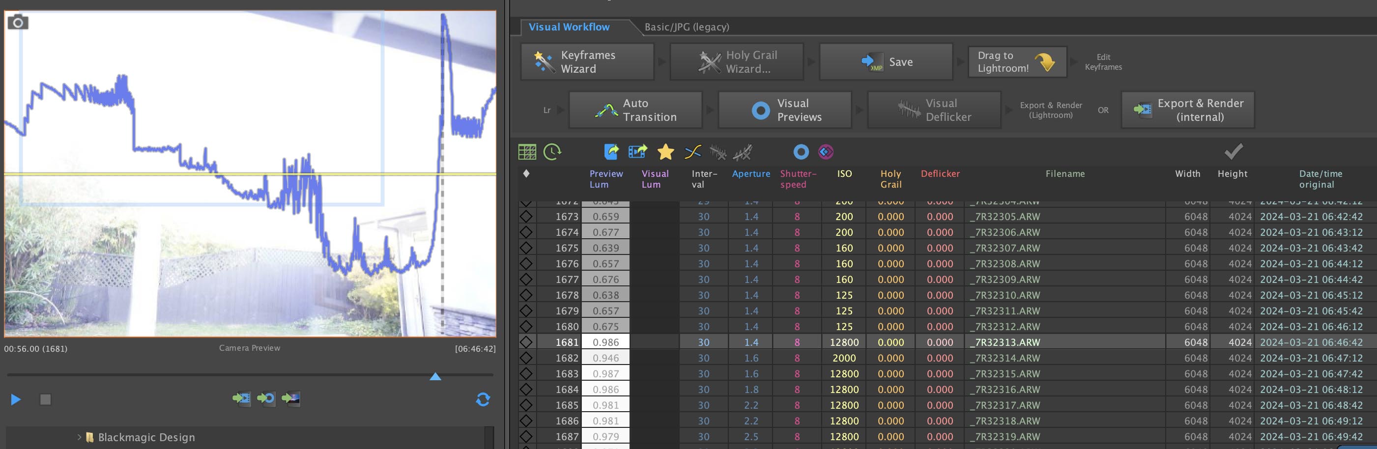

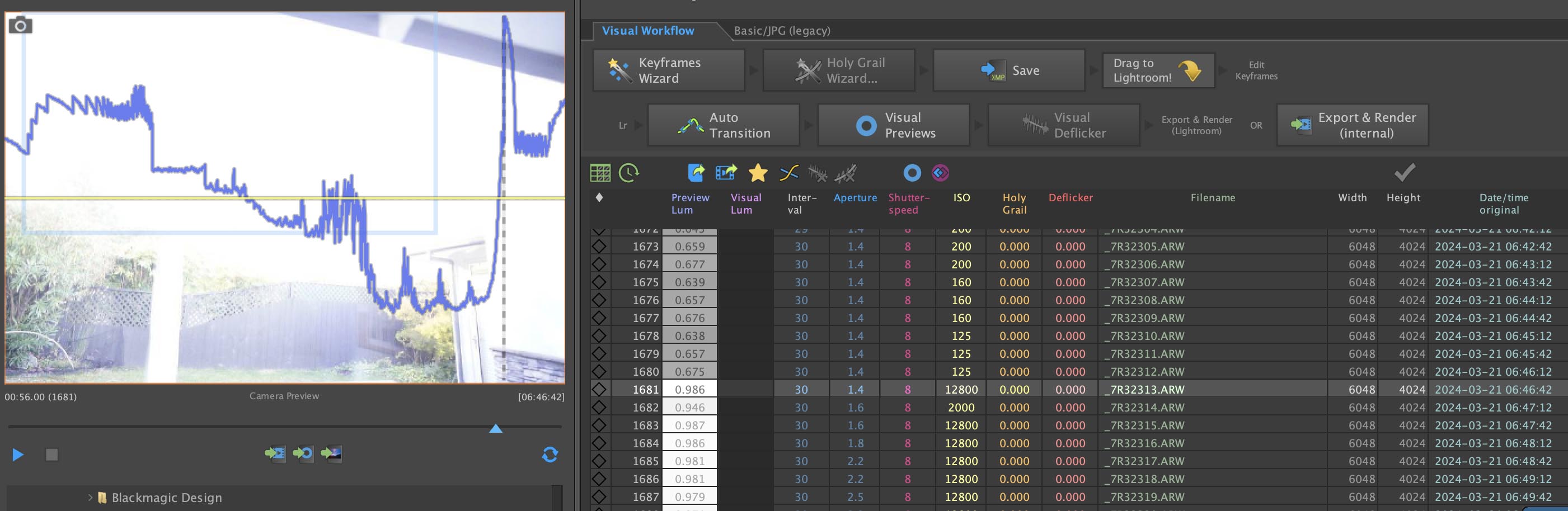

In my latest sunrise test I experienced a huge jump from ISO 125 to ISO 12800 about 45 minutes from sunrise, after running the program overnight using LRT plus sunrise algorighm. Ramping order: TV AV ISO
If it was an actual job it would have ruined the timelapse. At this stage, my experience of unleashed has been underwhelming for holy grail timelapse, I just can't rely on it. Very erratic jumps in exposure, mainly related to ISO.
Hoping this can be fixed. Any suggestions for tests, settings welcomed.
