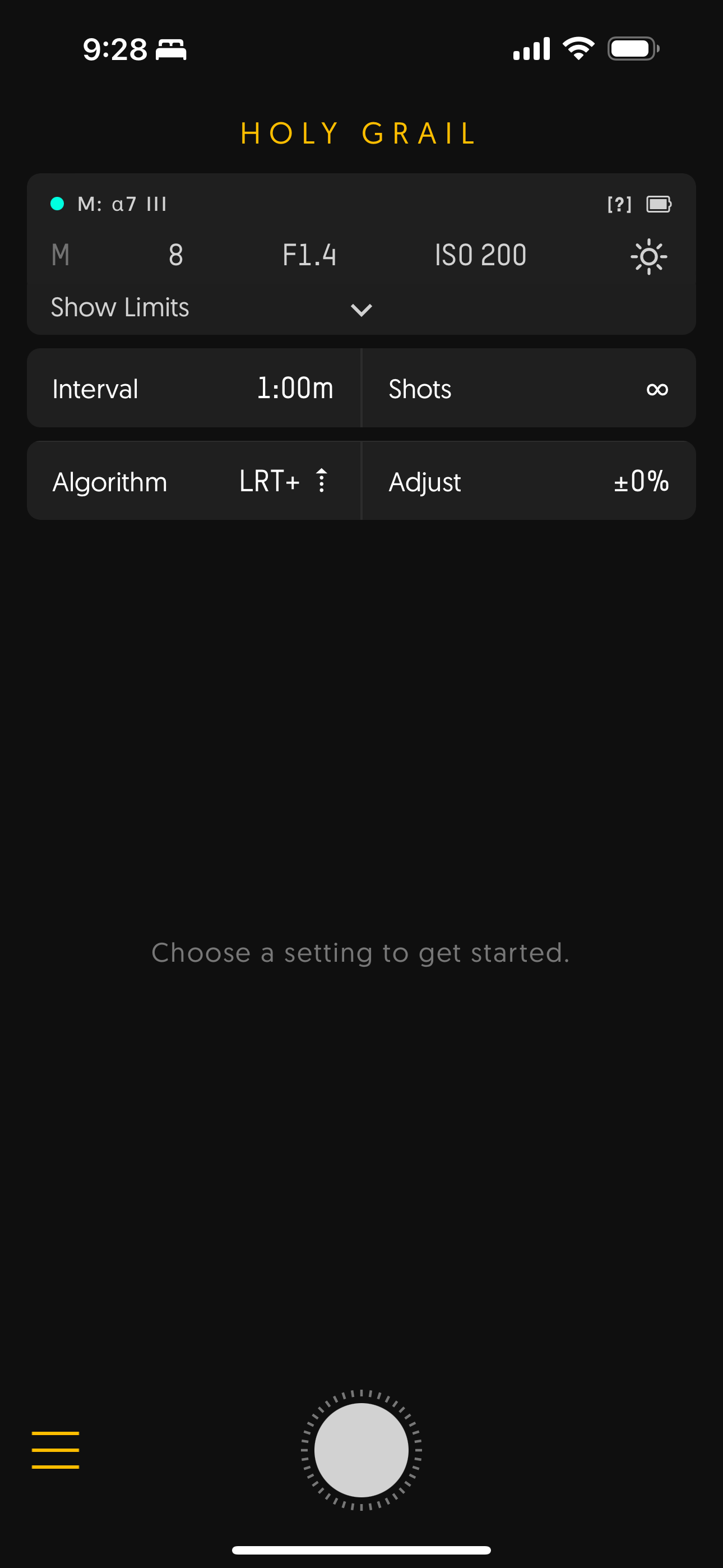

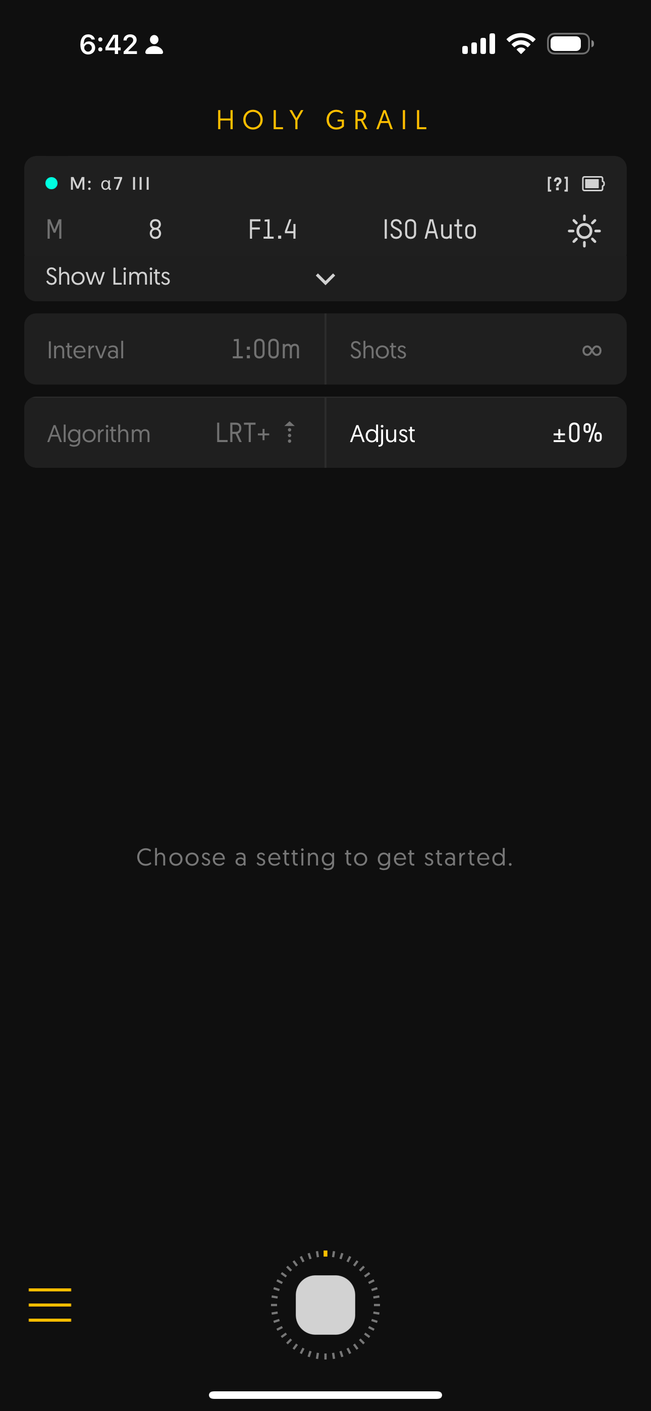

Sony A7r3 and iphone 15 pro max. In the last 2 overnight tests of a sunrise I have done I have had the ISO change to 'auto ISO' overnight, even though auto ISO was not chosen in any of the starting settings. Screen shots attached.
Any ideas what might be going on?
It is certainly not what I want to happen. I want ISO to be ramped appropriately as chosen.
Start Settings at 9.30 pm
Settings at 6.30 am the following morning - note ISO change

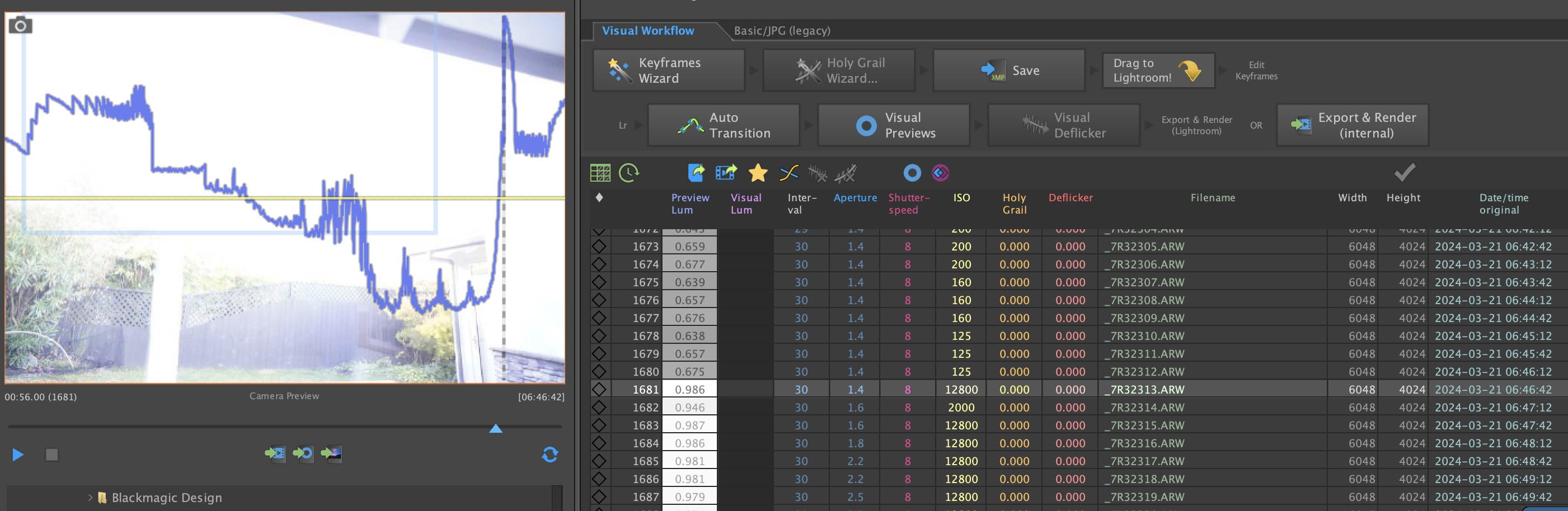

In my latest sunrise test I experienced a huge jump from ISO 125 to ISO 12800 about 45 minutes from sunrise, after running the program overnight using LRT plus sunrise algorighm. Ramping order: TV AV ISO
If it was an actual job it would have ruined the timelapse. At this stage, my experience of unleashed has been underwhelming for holy grail timelapse, I just can't rely on it. Very erratic jumps in exposure, mainly related to ISO.

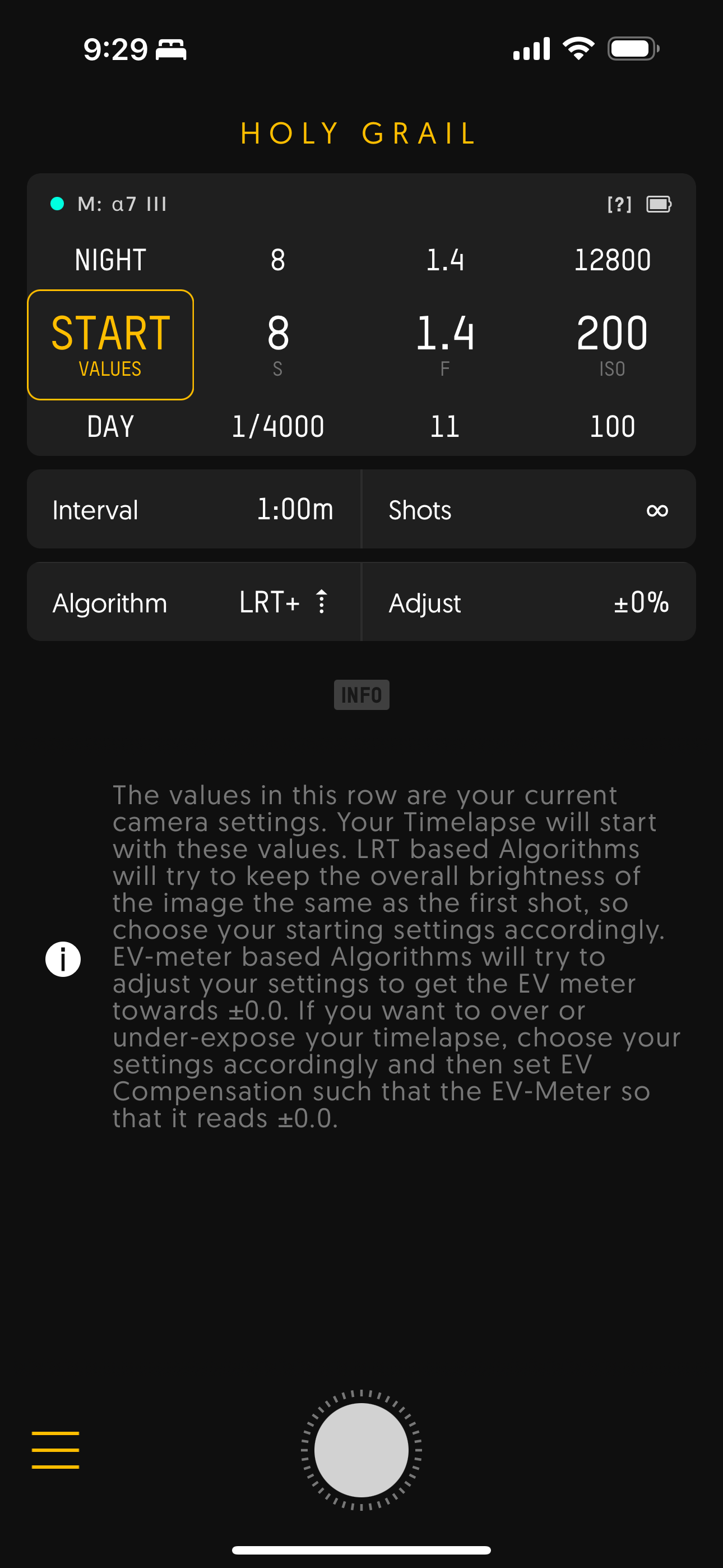

Still testing and no succesful holy grai timelapses so far with the Sony 7R4 or Sony 7R3. All apps and firmware up to date. I am using an iphone 15 pro max to run the unleashed software. I haven't had the ISO switching to Auto problem re-occur, it may have been because I set it close to the ISO camera limits?
Other funcitions seem to work fine but I purchased this device for its holy grail functionality. But it doesn't work.
I've tested both sunrise and sunset in all of the available algorithms. The most common recurring issue is aperture is ignored in the Ramping Order setting, it just sticks to whatever I start with and doesn't ramp at all. I use TV-AV-ISO for sunset and ISO-AV-TV for sunrise.
