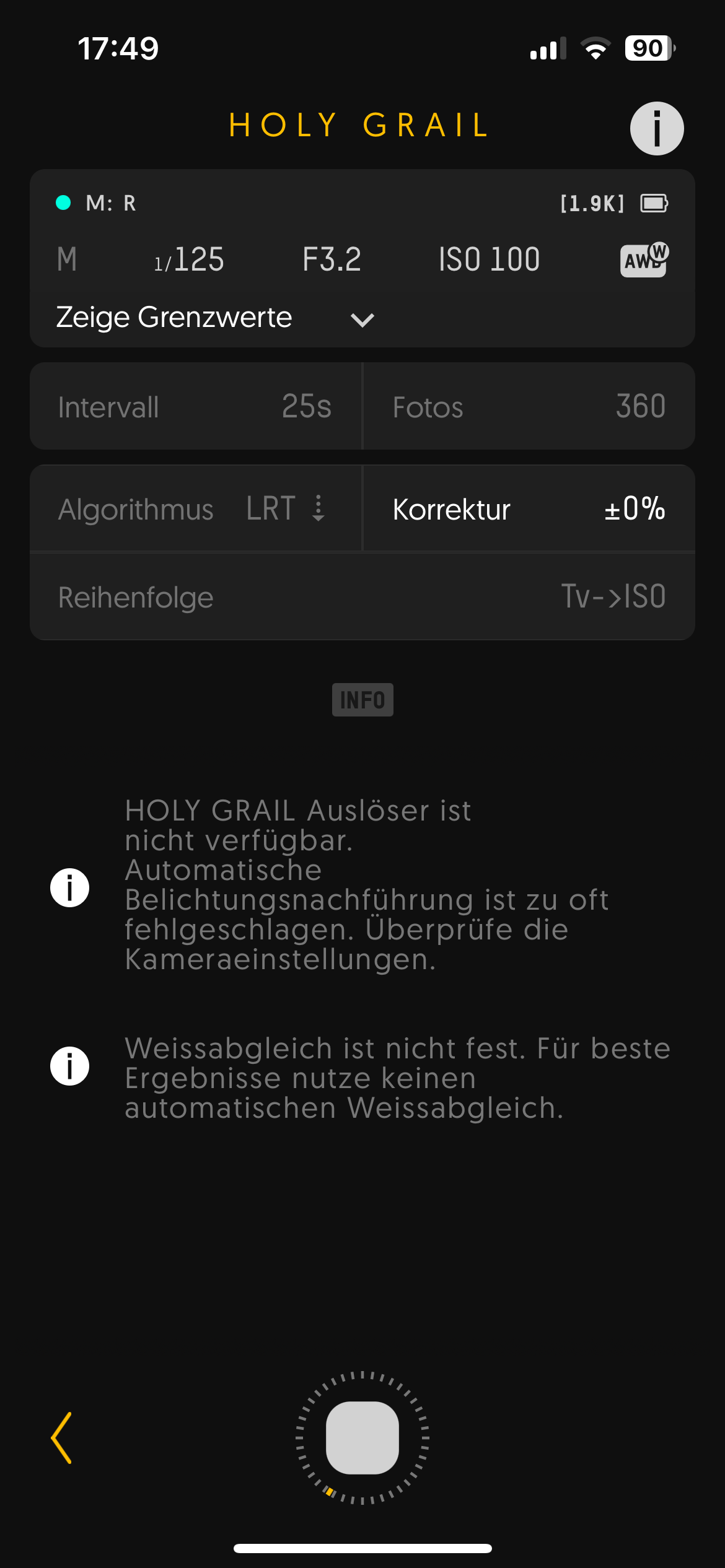

When trying to shot a Holy grail, I get this error message in the Unleashed app:
Error in english: HOLY GRAIL not available, automatic exposure setting failed too often.

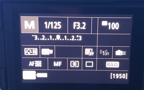

My camera is set to manual mode, manual AF, RAW only:
What is the problem? Latest Firmware updated today.
Never had a problem when shooting HG with qDSLR and these camera settings.

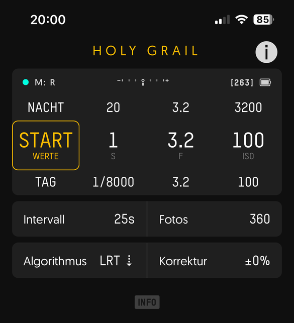

The settings that I can see look fine. Could you show me the day limits too?

Here the complete setting. But why does the day setting matter when making a sunset holy grail?

Tried another HG with the setting RAW + smallest JPG and this time it worked. So this setting seems to be mandatory and should be mentioned in the tutorials, FAQs or some kind of manual. It avoids a lot of frustration and angry users.
