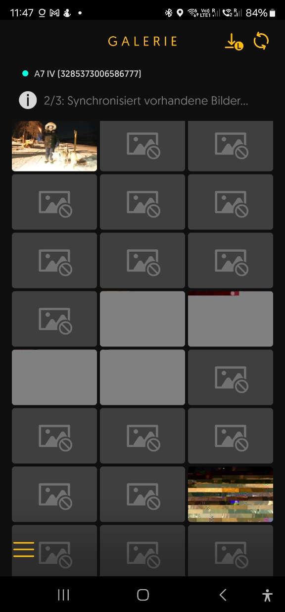

I have a Sony A7 IV and a Samsung Galaxy 23 Ultra and unleashed 22 with the last update. The GPS icon in the app is mostly red. Although a GPS signal arrives on the cell phone. Everything else works correctly.
UPDATE
Cannot Show Photos on Gallery. They were downloaded but shown as corrupt.
Also preview does Not work in the [review]
I'm on my journey in Norway, that is very frustrating
