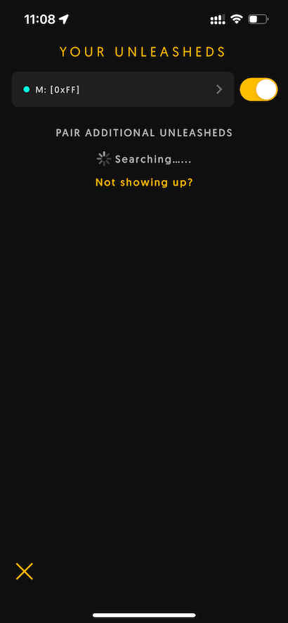

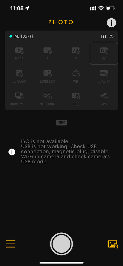

I can successfully and easily pair to the UNLEASHED but no camera functions are available in the app. All functions in all main screens of the app are greyed out and I get the messages similar to "Wrong USB mode. Change USB mode in your camera menu." or "USB is not working. Check USB connection, magnetic plug, disable Wi-fi in camera and check camera's USB mode."... or similar depending on the function.

The UNLEASHED unit itself has a solid green/teal light when the app is open and the app shows the teal connected dot. When pairing, the app initially shows the correct serial number as the name of the unit ("UNLEASEHED 012XXX" X's are actually real numbers), but that is quickly replaced by "M: [0xFF]". When I first tested it, I did have some issues but it "worked"... various functions worked (I think I even took a photo with it), but I couldn't get things like geotagging to work properly and there were some other errors which I don't recall, but I became busy and have only just come back to it. The first thing I did when I started testing it again last month was to update the firmware (to the versions prior to the current set listed above) and have never been able to access the camera functions since. It seems that it refuses to connect to USB on the camera.

Below are some screenshots of the app screens. These are mostly from the Photo screen, but all other main function screens are similar, with buttons either greyed out or in red.
Jonathan.
After pairing
Photo screen after clicking "i" icon
Photo screen after clicking "iso" function

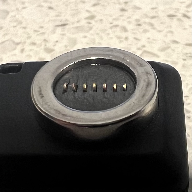

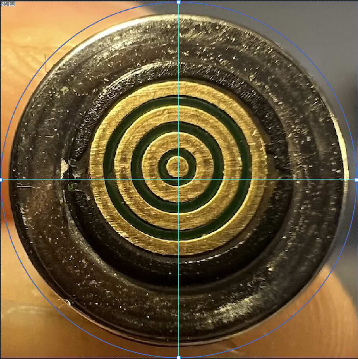

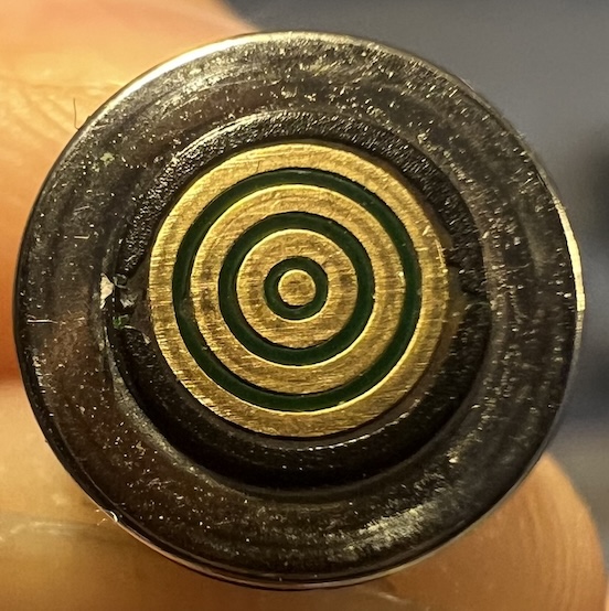

After a bit more investigation, it takes very little pressure to make it work. If I push very slightly (more just a touch) on the "top" (UNLEASHED in vertical orientation with logo upright), pushing in towards the camera body, it works. When I do this, it look like the USB plug shifts slightly (together with the UNLEASHED itself in the camera's USB plug. When I test it with a USB cable, the connection isn't unreliable at all, so I don't think that it is the connection on the camera end.
If I push directly on the center the UNLEASHED towards the camera body, it doesn't work, I have to push slightly on the top as mentioned above. If I rotate the UNLEAHSED 90 degrees (clockwise when looking directly at the UNLEASHED), then I still have to push on what is now the new "top" of the unleashed (i.e. what was previously the side of the UNLEASHED before rotation - the upper-most part compared to the camera). My impression is that it feels like it is a problem with the USB plug, not the magnetic connector because I am effectively pushing the USB connector in the same direction. In fact it only works if I push on the "top" of the UNLEASHED compared to the camera, almost no matter which orientation it is in.
However, as you will see in the photos below, one of the pins on the magnetic connector does look out of place, but not sure how consequential that is given that there the pins are paired.

January 8th, 2024, 12:28 pm
Hi Jonathan,
oh, the plug looks like its rings are not concentric at all!
I can't see how bad it is, since a bit of a perspective shift can make it seem much worse than it might actually be, but this would explain your problems.
The bent pin might make this worse as it might actually reach far enough to touch the next ring.
We'll just send you a new one! my colleague will send you an email with the details.
