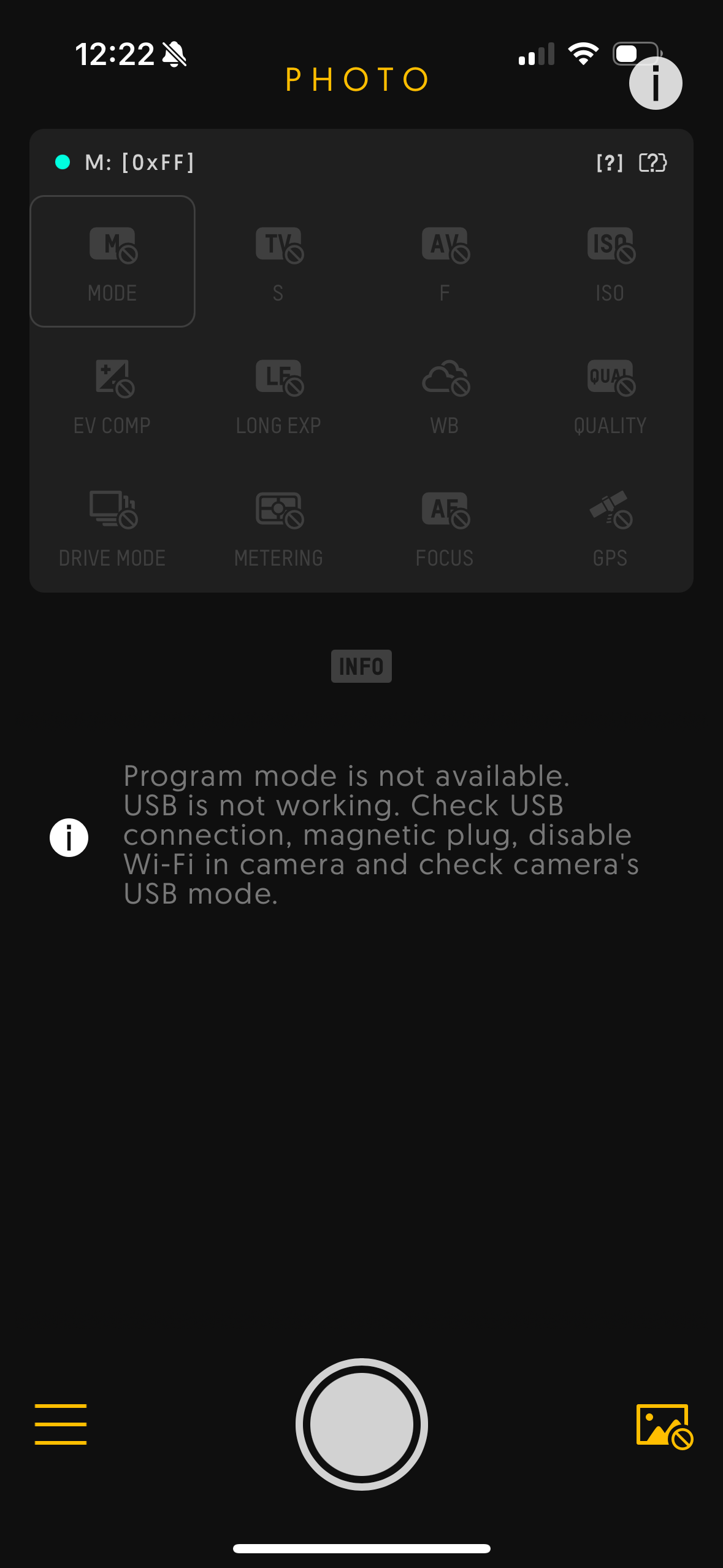

So now the issue has become worse. The unleashed will not even connect to my camera anymore.
I didn't have the file format to RAW+JPEG at first, but I can't test it now since there's no longer access to the app functions.
I've been struggling with getting this product connected to both my cameras since I received it. I also bought the hdmi chord for the a7rV but was never able to connect that camera so I figured I'd focus on the a7rIV first. Now neither of them are functioning.
Is it possible I received a defective item?

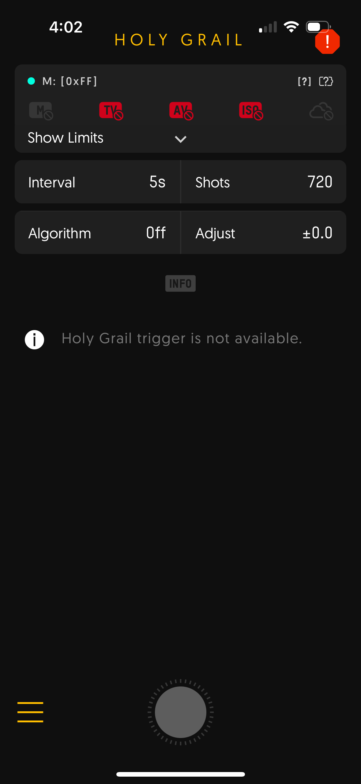

Update:
So I managed to establish a connection, and the algorithm feature is working correctly.
Unfortunately, I turned the camera off to test if it was repeatable and there is no longer a connection.
This is so unreliable that it is unusable. And I know the settings are correct because when I do establish a connection everything works properly.
Attached is an image of my screen in the app.
- IMG_6963.PNG (126.49 KiB) Viewed 35717 times

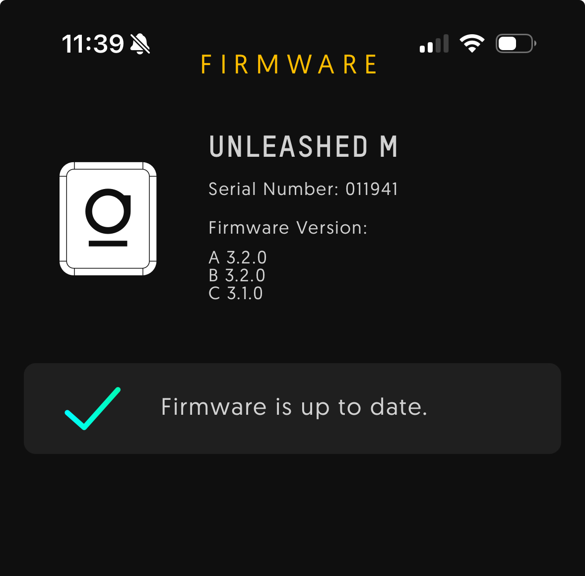

I've followed all the instructions for setup located here: https://www.foolography.com/start/
Double checked and triple checked my settings
Updated to Latest Firmware A 3.2.0 B3.2.0 C3.1.0
The Unleashed is still not working. There is no connection ( It shows M: [OxFF] )
The device is unusable.

- go to Menu -> Unleashed with gear icon -> Your Unleashed -> Firmware. Send me a screenshot, then do a firmware update. Be sure to follow the instructions in the app and halfpress the camera's shutterbutton while the Unleashed is updating. This is crucial or the Unleashed loses power in the middle of the update and won't work until you re-install the firmware. Send me another screenshot of the Firmware. Note: we just released FW 3.2.0 yesterday, and it includes a fix for Sony triggering and sony timelapse, as well as an increased initialization delay. more on this later.

- go to the PHOTO screen. if the settings are greyed out, tap on one, and you'll get an error message in the bottom half of the screen. Please send me a screenshot of that.
- if the settings are white, change them, and see if that works. Take a picture. take 5 more. Take 20 more.

To start, the confusion and multiple posts could have been avoided had you or one of your team members put out a post specifying that you wouldn’t be able to answer us just yet or did the expedient thing and just refunded or replaced the product.
This is not the first Timelapse product you have released. We are not your beta testing focus group. These products should never have been released to the public with as many issues as they have, particularly as they were marketed to be a plug-and-play solution to our needs. Many of us on this forum have expressed this sentiment so please do not patronize us when you are the one who should own the major mistakes associated with your company.
Let me clarify my experience so far. I was able to establish a connection (meaning the trigger was actually communicating with my camera and the menu options were available) three times out of dozens and dozens of attempts.
The initial post was made the first time that connection was established, but I couldn’t access the holy grail due to my camera settings just being set to RAW and not RAW & JPEG. The second time I established a connection the Holy Grail feature worked due to the settings being adjusted. I turned off the camera to see if it was repeatable, but I could not establish the same connection again. The third time it connected randomly but it hasn’t been repeatable since then after many more attempts. The app is not pairing to the camera.
I no longer own an A7RIV so now I am only attempting on an A7RV.
I’ve followed all of your troubleshooting instructions.
- unleashed cable points to the right
- both hdmi and magnetic usb plug are plugged in
- twisted the unleashed back and forth on the usb plug
- used only one memory card inserted (128gb is all I have and it’s a fast one)
-there is a turquoise dot
- firmware screenshot attached
-factory reset completed
- photo screen settings screen shot attached ( It says the USB is not working)
- I pushed on the unleashed, twisted it 90 degrees in either direction, and checked the concentricity of the contact rings on the magnetic plug. Photos are attached of the mating surfaces of the magnetic connection.
- I am not using the second USB port on my camera.
The only thing I can think of is that it’s a USB connection issue which I have no idea how to solve. I’ve followed all of the instruction on the Getting Started Page with no luck.

Ultimately, I need a replacement because it appears the product is defective –– or a refund. I have already wasted so much time troubleshooting this product with no success. I’ve never had an experience with a company where I am expected to troubleshoot on the company’s behalf, rather than just get a new product that works as intended. It’s absolutely ridiculous.
