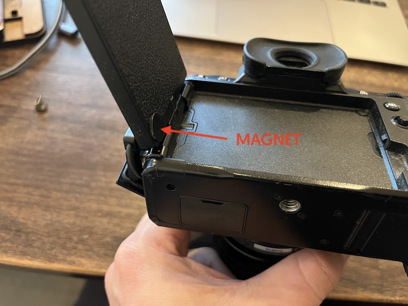

We were also stumped by this with our X-T4, but the cause is very different than you might think.
The sensor to detect whether you have the screen open or closed seems to be located in the bottom left corner of the screen and is actuated by a magnet that is in the top left corner of the screen when it's open, which moves to the bottom left corner of the screen when it's closed.
You might notice what the issue is: the sensor is quite near to where the Unleashed is plugged in, and the Magnetic Unleashed and plug can trigger the sensor.
The good thing is that it doesn't always hold the sensor in the "screen closed" position, but it it can hold it closed depending on how you attach the Unleashed to the magnetic plug. (ie if you pass by the sensor while attaching it in one direction it will actuate the sensor, and the magnetic force is strong enough to hold it in that position. But if you move the Unleashed in from another angle, it might not trigger the sensor.
To fix the issue, you can detach the Unleashed from the magnetic plug, and use its magnet to switch the sensor on and off.
If you hold the Unleashed to the bottom left corner of the screen with the logo pointing to you, the screen will turn on. if you flip the Unleashed around and you're looking at the magnet, this will turn off the screen.
You can experiment with how to best attach the Unleashed to the plug without triggering the switch. and you can always untrigger the switch by holding the Unleashed (or another magnet, or even ferrous metal) in the bottom left corner of the screen!
We have not come across any other cameras that do this, just the X-T4 🤷‍♂️
if it's hugely bothersome (I expect there to be some variation in the sensitivity of these sensors), you could try sticking a flat piece of ferrous metal, or if you have one, a very thin magnet behind the screen in that location, that could already do the trick to solve the problem permanently.
