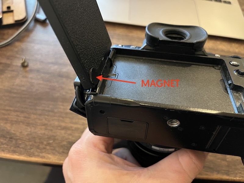

The sensor to detect whether you have the screen open or closed seems to be located in the bottom left corner of the screen and is actuated by a magnet that is in the top left corner of the screen when it's open, which moves to the bottom left corner of the screen when it's closed.
You might notice what the issue is: the sensor is quite near to where the Unleashed is plugged in, and the Magnetic Unleashed and plug can trigger the sensor.
The good thing is that it doesn't always hold the sensor in the "screen closed" position, but it it can hold it closed depending on how you attach the Unleashed to the magnetic plug. (ie if you pass by the sensor while attaching it in one direction it will actuate the sensor, and the magnetic force is strong enough to hold it in that position. But if you move the Unleashed in from another angle, it might not trigger the sensor.
To fix the issue, you can detach the Unleashed from the magnetic plug, and use its magnet to switch the sensor on and off.
If you hold the Unleashed to the bottom left corner of the screen with the logo pointing to you, the screen will turn on. if you flip the Unleashed around and you're looking at the magnet, this will turn off the screen.
You can experiment with how to best attach the Unleashed to the plug without triggering the switch. and you can always untrigger the switch by holding the Unleashed (or another magnet, or even ferrous metal) in the bottom left corner of the screen!

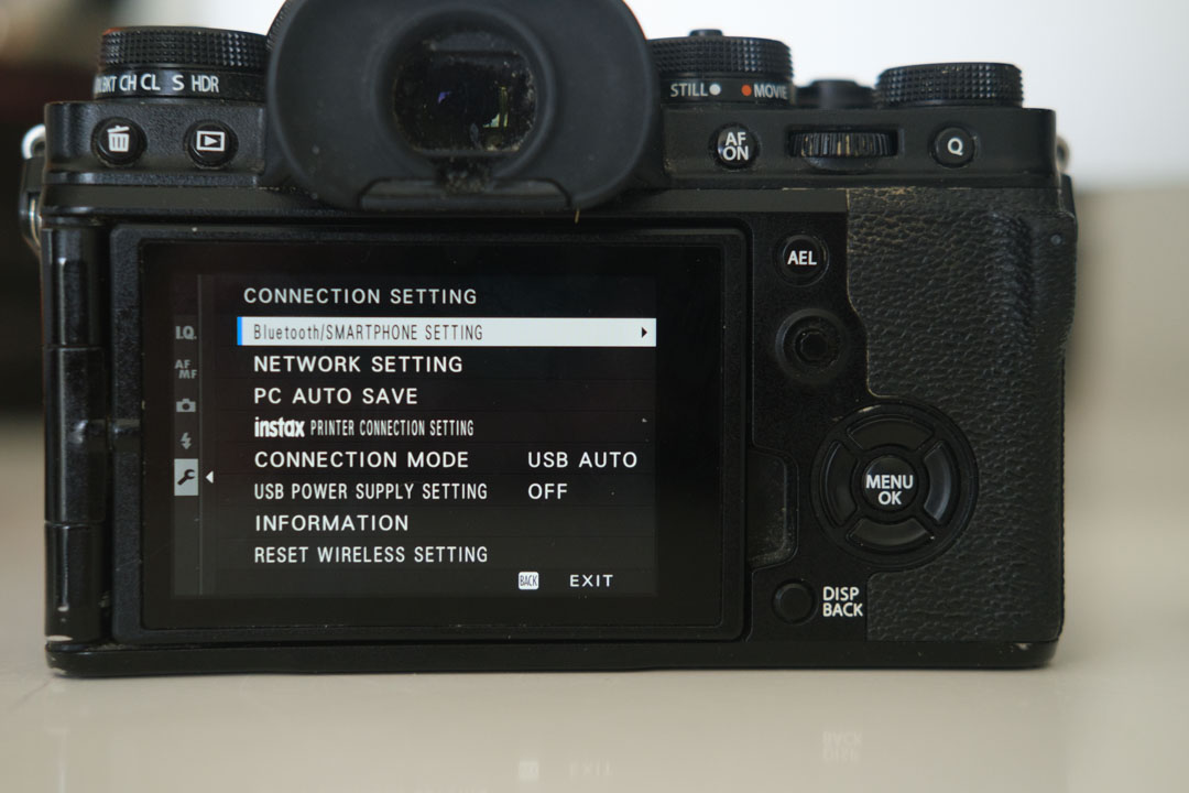

Have you seen this?
FUJIFILM
  • On newer cameras (eg X-T4), set the camera setting: MENU > SET UP > CONNECTION SETTING > CONNECTION MODE = USB TETHER SHOOTING AUTO
  • On cameras that have this (eg X-T5), also set USB POWER SUPPLY/COMM SETTING = POWER SUPPLY OFF/COMM ON
  • On older cameras (eg X-T2), set the camera setting: MENU > SET UP > CONNECTION SETTING > PC CONNECTION MODE = USB TETHER SHOOTING AUTO
  • If previously connected to Fujifilm Cam Remote app via WiFi, disconnect

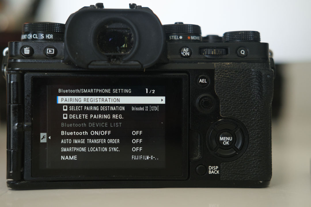

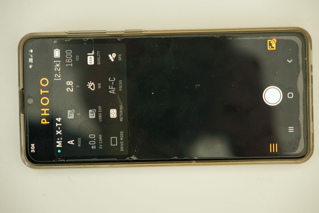

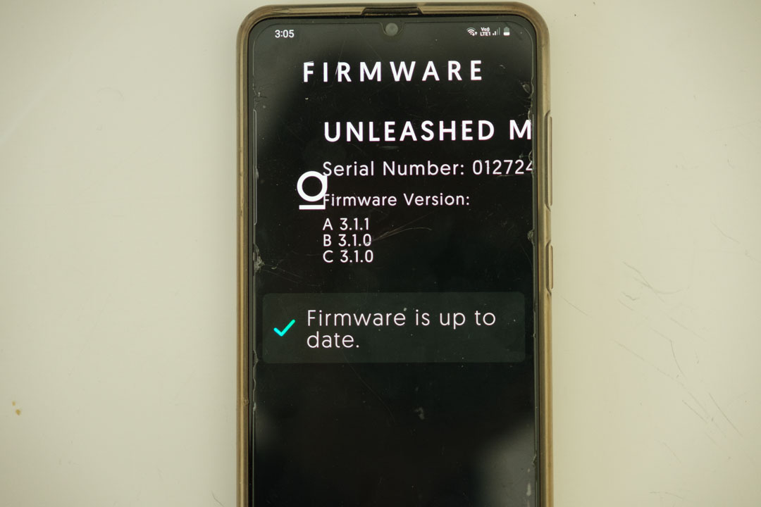

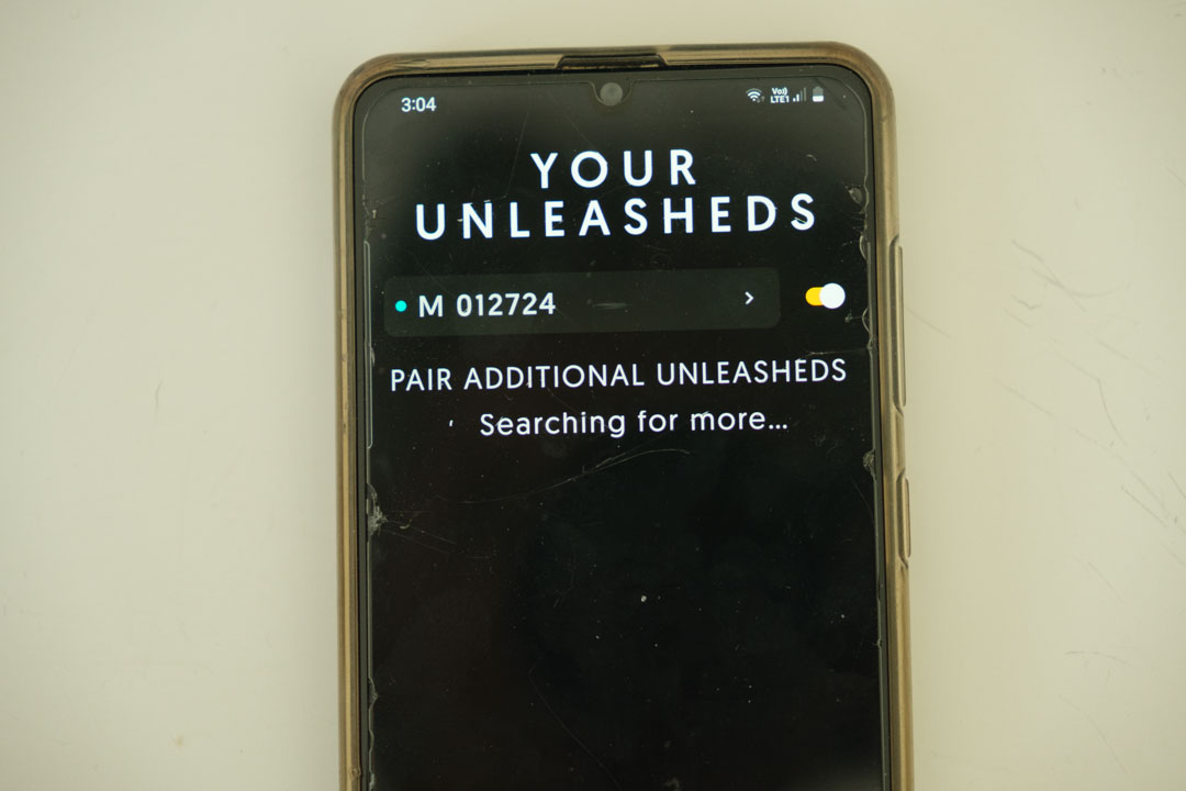

I have done some more testing but still can not get the app to take a photo. A couple of photos attached.
I have -
1 - reinstalled the app
2 - downgraded the firmware
3 - when I take a photo from the app the light on the back of the X-T4 flashes
4 - when I take a photo from the app the image counter on the camera disappears and reappears but the number does not change
5 - when I take a photo from the app the ss and iso on the app go from gray to white
Neil

November 17th, 2023, 11:40 pm
We just published another firmware update with several fixes for Fuji cameras. The fixes are mainly for bugs found with the newer cameras, but maybe they solve an issue for you too.
When you restart your app, it will get the firmware update automatically and you'll see a red notification badge on the menu icon in the bottom left corner of the app. Follow this notification badge through the app to get to the firmware update screen.
let me know if that solves your issue!
