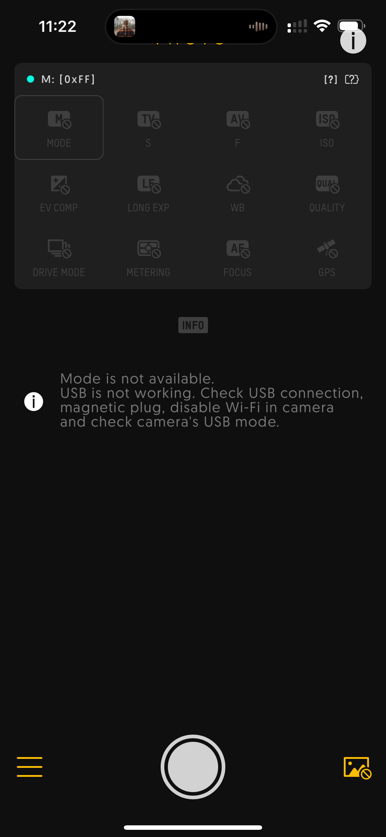

I have now got the unleashed to power on and pair, but get an error that the USB mode is wrong. I can't find the option to change this on the camera.
Any ideas?

Hmm, that's odd, the 5D Mark IV shouldn't show such an error.

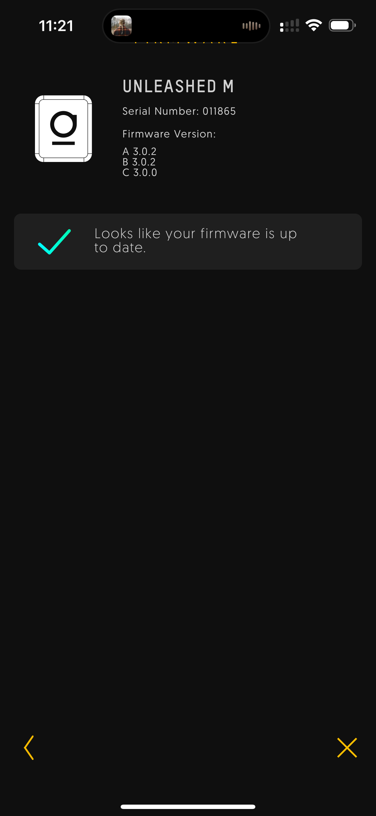

Have you updated your firmware? Whenever there's a Firmware update available, you'll see a red notification badge on the menu icon in the bottom left corner of the app. Follow this notification badge through the app to get to the firmware update screen.
can you send a screenshot where you see this message, or copy the message exactly?

Please see screenshot

Yesterday, we published a firmware update (A3.1.1 B3.1.0) - could you check if this solves your issue?
