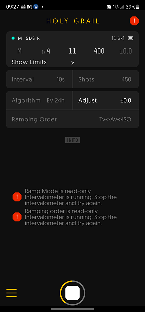

I use a Canon 5dsr.
in Holy Grail mode (Canon set to M-Mode) I get errors like
Ramp Mode is read-only. Intervalometer is running. Stop the intervalometer and try again.
and
Ramping order is read-only. USB is not working. Check USB connection, magnetic plug, disable WiFi in camera and check cameras USB mode
well my 5dsr has no wifi and no single usb relevant setting. I use a samsung galaxy S23 ultra with android 13 and tried it with wifi on and off which does not affect the above errors.
I get the errors after each single taken image.
I didnt try it long enough to verify if rampung is working or just the images are taken.
The firmware of my Unleashed 22 is up to date
hdmi and usb2->usb3 (lower part of the connector) are connected
did I somethin wrong?

1. I did a fatory reset
2. Selected Holy Grail Menu
3. changed my Canon 5dsr to M with following values: 1/4 F11 ISO 400 MF AWB writing dual SD/CF RAW
4. show limits give me above Start values and NIGHT 8/11/1600 and DAY 8000/11/100
5. interval is by default to 10s, shots is grayed out with 450, alg is LRT Sunrise Beta, Adjust +-0 and Ramping order TV->AV-ISO
6. if I now press start, images are taken and the error occurs. see screenshot
7. I also did "forget unleashed" did no change it.
Liebe Grüße
Georg
October 24th, 2023, 9:45 am
Ah, OK, but the holy grail timelapse is actually running?
if so, then those messages are correct, because you shouldn't be changing Ramp mode (Algorithm) or Ramping order while a timelapse is running. However, you should also not be seeing those as errors in the app, I'll make sure we don't display them anymore.
If the timelapse is running, you can ignore the errors for now!

yes, I can confirm the holy grail works as intended. I made a very short test with 400 images and the exposure time was adapted from initially 1/320 to 1/160 (ISO and aperture unchanged)
