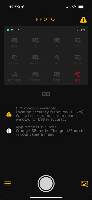

Re: Unleashed not working with Canon R7
Posted: October 24th, 2023, 1:02 pm
by bglana
Please note that the R7 has 2 card slots and I'm using both with 2 different types (speed) of 256GB cards.
I just did a test with a 32 GB card but no luck so far. Still got an error message(s)
Posted: October 24th, 2023, 2:07 pm
@croimans: just try it without any SD card, so we can confirm that your seeing the same issue for the same reason that we found.
@bglana : your problem is a very different one - on newer Canons, the only way we could achieve geotagging was via Bluetooth. The problem is that for some, unknown reason, canon does not allow controlling the camera via USB while also being connected via Bluetooth! that means you have to choose between controlling the settings of the camera, and geotagging.
I'll admit, probably 80% of the time that you might want to be geotagging, you'll have your phone in your pocket, and are walking around taking photos with the camera in your hand. And here, it's no loss, that settings don't work. However, in those 20%, where you do want to take a selfie, or have the camera on a tripod, for Landscape, long exposure or any other tripod photography, it's a huge shame. We haven't given up entirely, and are still searching for ways around these limitations, but unfortunately, for now the cameras are limiting what we can do...
