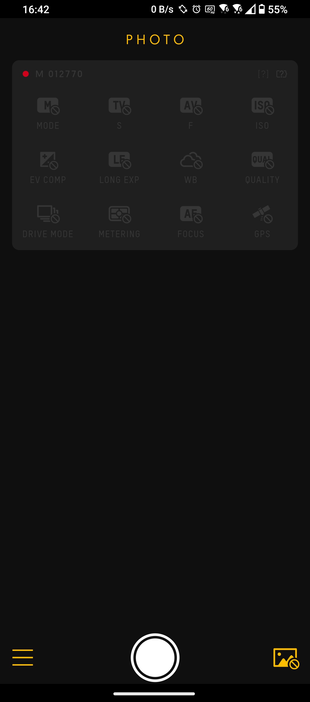

hi,
Received the Unleashed today.
Canon R7 to latest official firmware,
Play store for Android installed 3.0.3 app version,
Unleashed updated to latest in the app.
The unleashed is connected very fast, but all options are greyed out, and keeps saying unleashed is initinalizing.
How long we wait doesn't matter, it doesn't work with the R7.
The only thing we notice is when changing usb mode, , we get notification in app to change usb mode. so we know we are in correct usb mode,
only 2 modes applicable in camera settings.
wifi and bluetooth in camera are also disabled.
Hope there comes an update so we can use it, we also send log report in the android app.

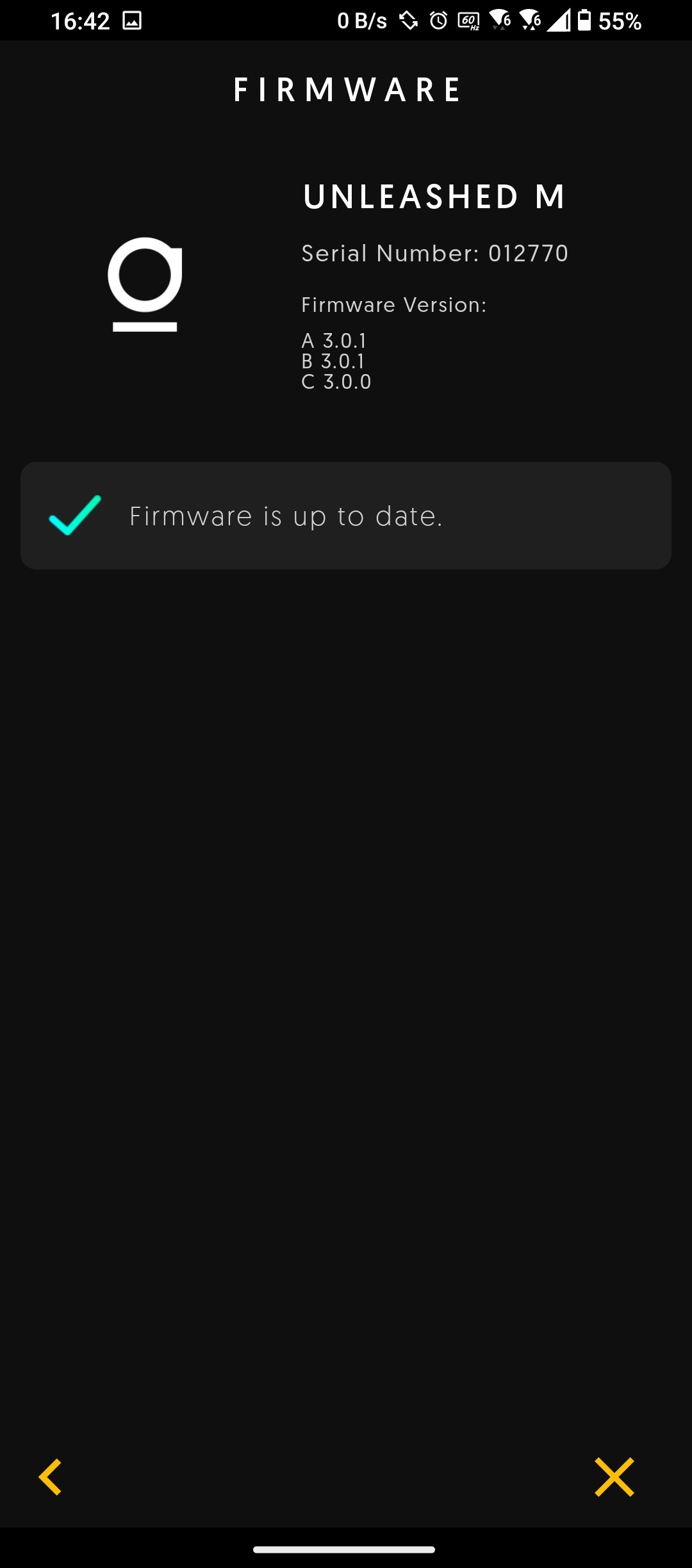

Could you post a screenshot where we can see the errormessage? We have two different "Initialising" errors, one comes from the Android app, and one from the firmware.
Did you install the firmware update? We published another one (3.0.1) on Thursday!

Offcourse last firmware update on Unleashed and on camera, is first thing I look for and also posted in start post that every thing is latest versions and up to date
Connecting is not the problem, it connects with app,
But all settings of camera stays greyed out,
When tapping on it, het notification :
Still initializing but how long you wait, never gonna work

croimans
Joined: October 20th, 2023, 7:38 pm
October 23rd, 2023, 4:45 pm
Some screenshots just taken

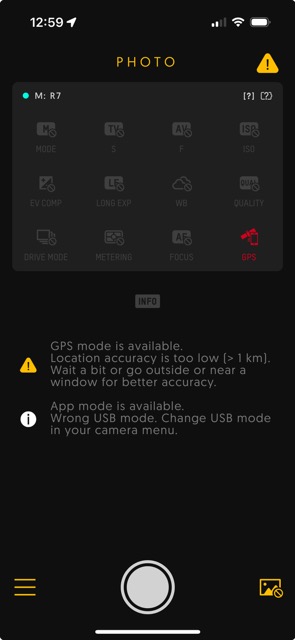

I have almost the same issues as already reported. I did the firmware update to th newest one but still not working.
I'm using an iPhone with iOS 17.0.3 and unleashed app version 3.0.1.
There are only 2 options in the camera for the USB mode. One is saying for a) PC and the other one is saying for b) Canon apps.
Changing this settings to a or b doesn't really help.
GPS not working is another issue.

Please note that the R7 has 2 card slots and I'm using both with 2 different types (speed) of 256GB cards.
I just did a test with a 32 GB card but no luck so far. Still got an error message(s)

@croimans: just try it without any SD card, so we can confirm that your seeing the same issue for the same reason that we found.
@bglana : your problem is a very different one - on newer Canons, the only way we could achieve geotagging was via Bluetooth. The problem is that for some, unknown reason, canon does not allow controlling the camera via USB while also being connected via Bluetooth! that means you have to choose between controlling the settings of the camera, and geotagging.
I'll admit, probably 80% of the time that you might want to be geotagging, you'll have your phone in your pocket, and are walking around taking photos with the camera in your hand. And here, it's no loss, that settings don't work. However, in those 20%, where you do want to take a selfie, or have the camera on a tripod, for Landscape, long exposure or any other tripod photography, it's a huge shame. We haven't given up entirely, and are still searching for ways around these limitations, but unfortunately, for now the cameras are limiting what we can do...
In other words: disable geotagging, and you'll have access to the settings again. then enable geotagging again to take photos... 🤷‍♂️
