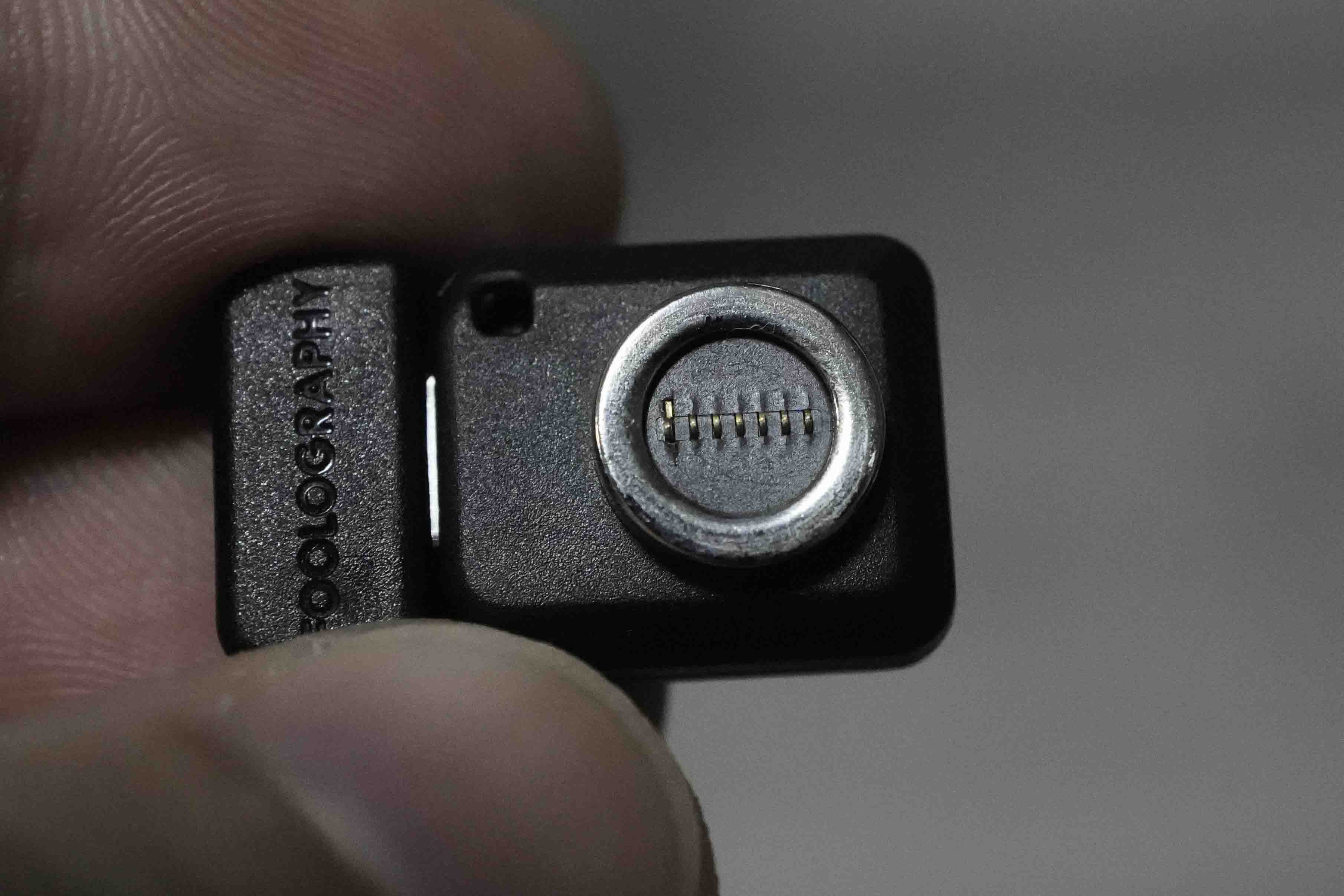

I have taken a picture of the pins, i found it odd that one of them is more exposed than the other, was wondering if this is expected, if not could it cause the contact issue?

October 27th, 2023, 11:40 pm
We found a possible solution to your problem. We'll roll out a firmware update in the next few days that will hopefully solve it.
We found out that we were trying to connect to the cameras USB a little too quick for the camera's liking, especially (but not exclusively) when using very large Memory cards - it seems that the camera is still busy getting the storage ready before it's able to communicate via USB.
You can try the following to see if this lets you use the Unleashed:
Leave the Unleashed's cable plugged in, but disconnect the magnetic connection.
Turn off the camera, take out the camera battery, and wait a few seconds.
replace the battery, turn on the camera, wait a second or two,
then reconnect the Unleashed to the magnetic plug.
does that work?

Thanks for the reply, I tried out what you suggested and it works!
Thanks for following up. Excited to try it out for my up coming trip.
looking forward to the firmware update :D
Not sure if it will help but i'm using a 80 GB cfxpress-A memory card, and it was in the whole time i was trying out the steps you suggested.
October 28th, 2023, 11:12 am
Awesome!
If those steps work, then the firmware update will almost certainly fix the issue!
