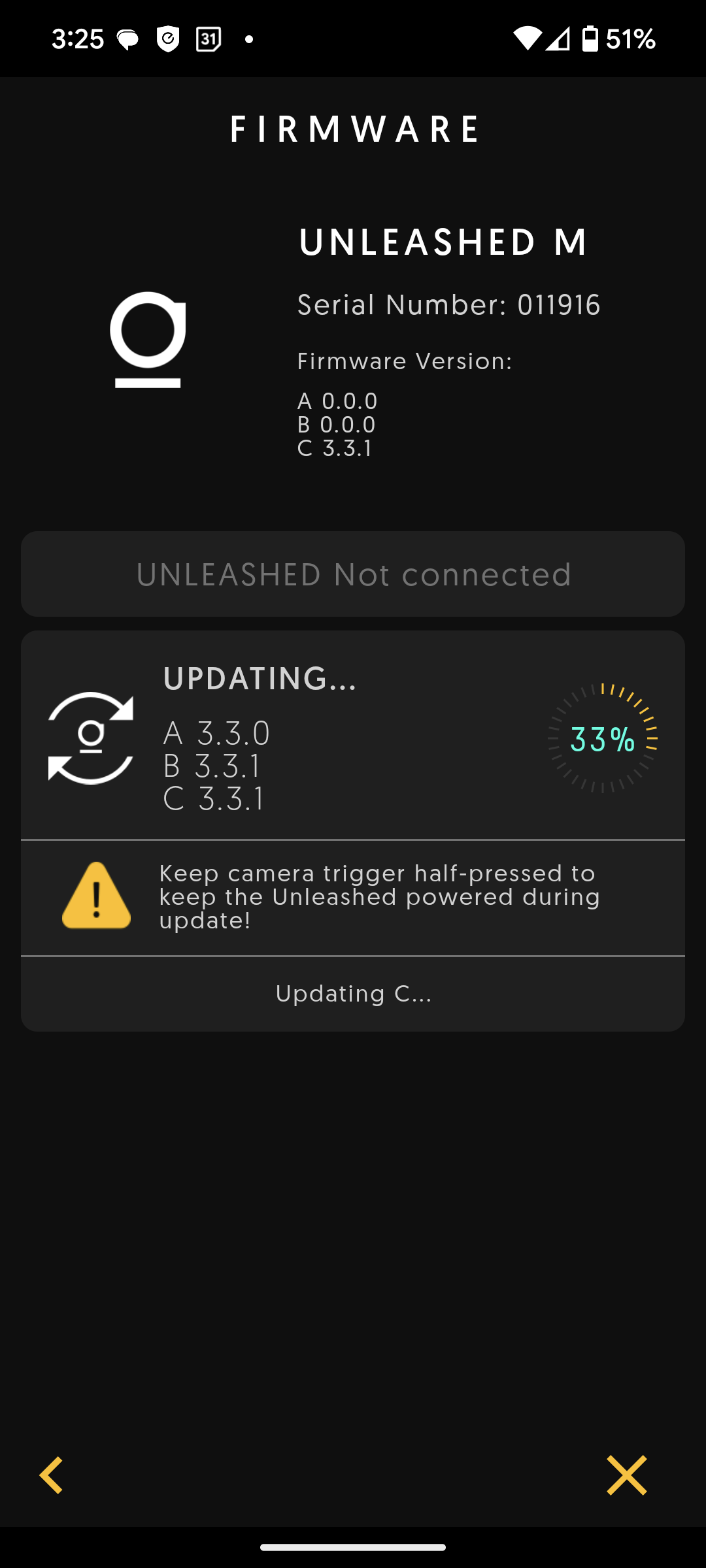

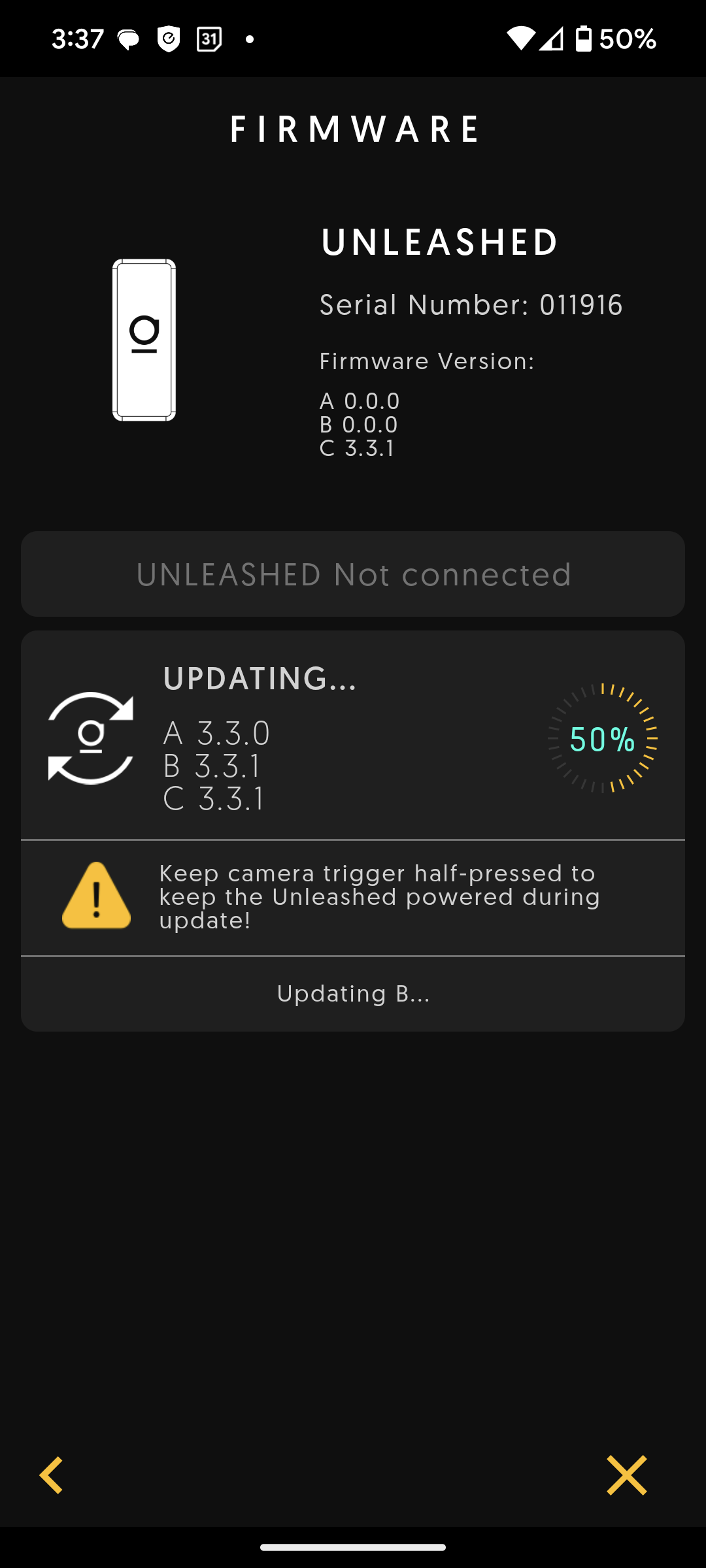

After much fussing and several failed attempts, I was able to update the firmware. The GPS icon shows an X despite the app having location permission. Phone is a Google Pixel 7a.
- Failed update attempt 4 - Unleashed always had power - connection would be lost and I'd have to restart each time
