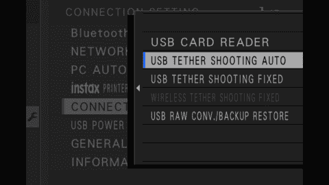

I get the following message: "Camera does not allow camera in this USB mode. Tap below and change USB settingin Camera menu to allow camera control."
I follow the procedure and go to the menu to set the USB connection option to "USB TETHER SHOOTING AUTO" and USB POWER SUPLY SETTING "to OFF
Despite this modification, the software on my phone still displays the message "Camera does not....."

I had a look and the correct USB mode and support for the SDK (which works the same way as the Unleashed controls the camera), was only added with camera Firmware 2.0 for your camera so be sure you have your camera's Firmware up to date.
https://fujifilm-x.com/global/special/c ... ntrol-sdk/
You can find the update here:
https://fujifilm-x.com/de-de/support/do ... ras/x-s10/
Are you sure you set it to the correct usb mode? can you send a photo of the options here? It should look like this:
