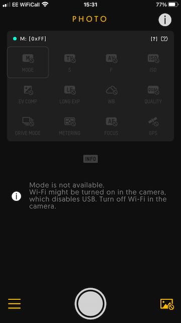

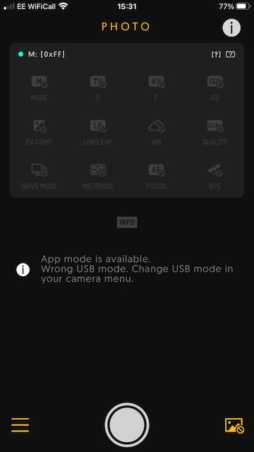

Got my M day before yesterday, but I can't get it to work on my Sony A7IV. I can connect successfully between Unleashed and app, but all icons are greyed out. I've got a message into Foolography tech support, but I think they are swamped.

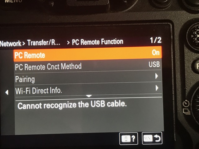

The only error message I've found that seems to indicate a trackable problem is this one: "Cannot recognise the USB cable".
Have any other A7IV owners gotten this message?

But to address your direct questions: firmware update completed successfully, though it took a few attempts. That photo of my A7IV's screen was taken after the update completed.
And here are two relevant app screenshots:

Just sent an email with more info, but for others reading this:
If you can - please try by resetting the camera to factory defaults and try again.
