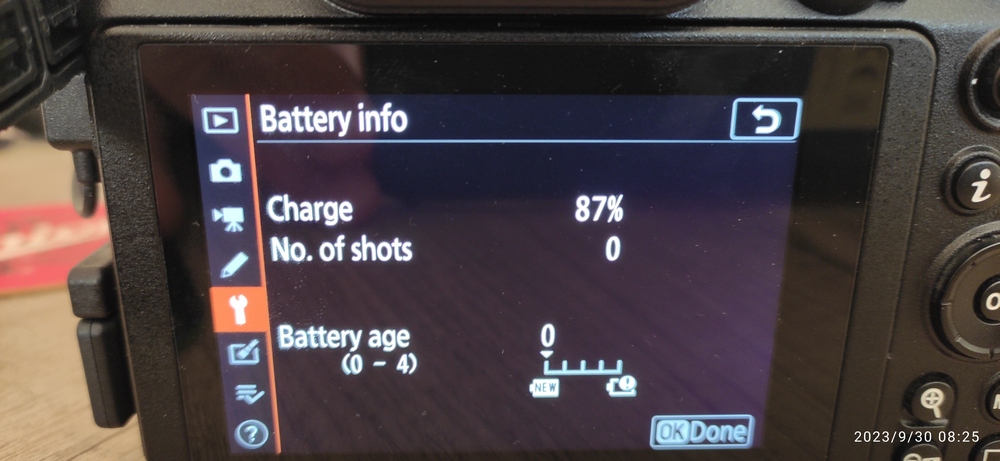

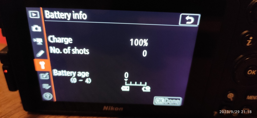

I have the same problem with Nikon Z6
yesterday I turned on my z6 and made the first image at 21:11. The camera battery was at 100%
after the image was taken I turned off the z6 with the power switch (it was in the off position)
today morning when I turned on the z6 the battery was at 87%
