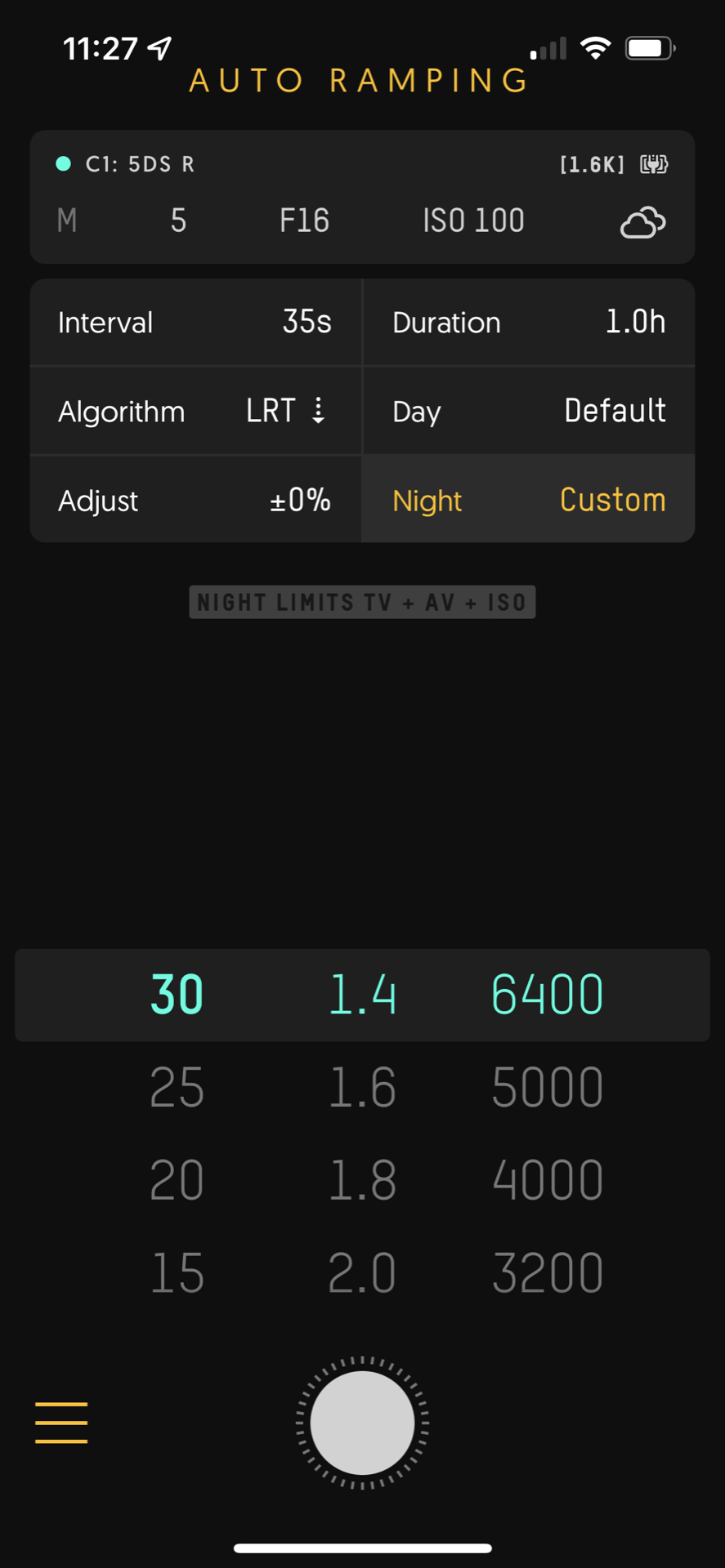

That is odd, and obviously should not be the case. Could you send me a screenshot of the Night limits? I see they are Custom, so it would be good to know what you set there.

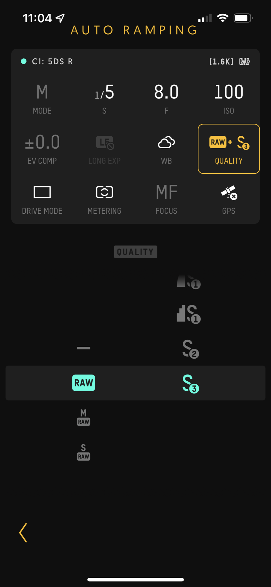

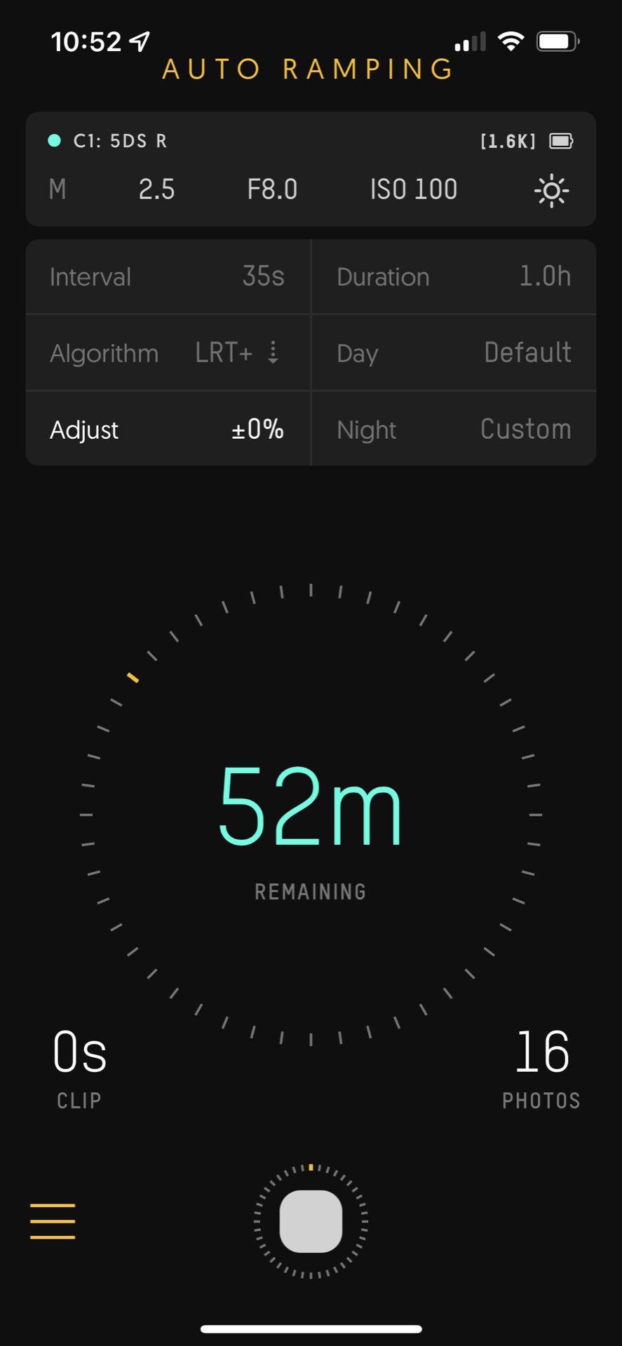

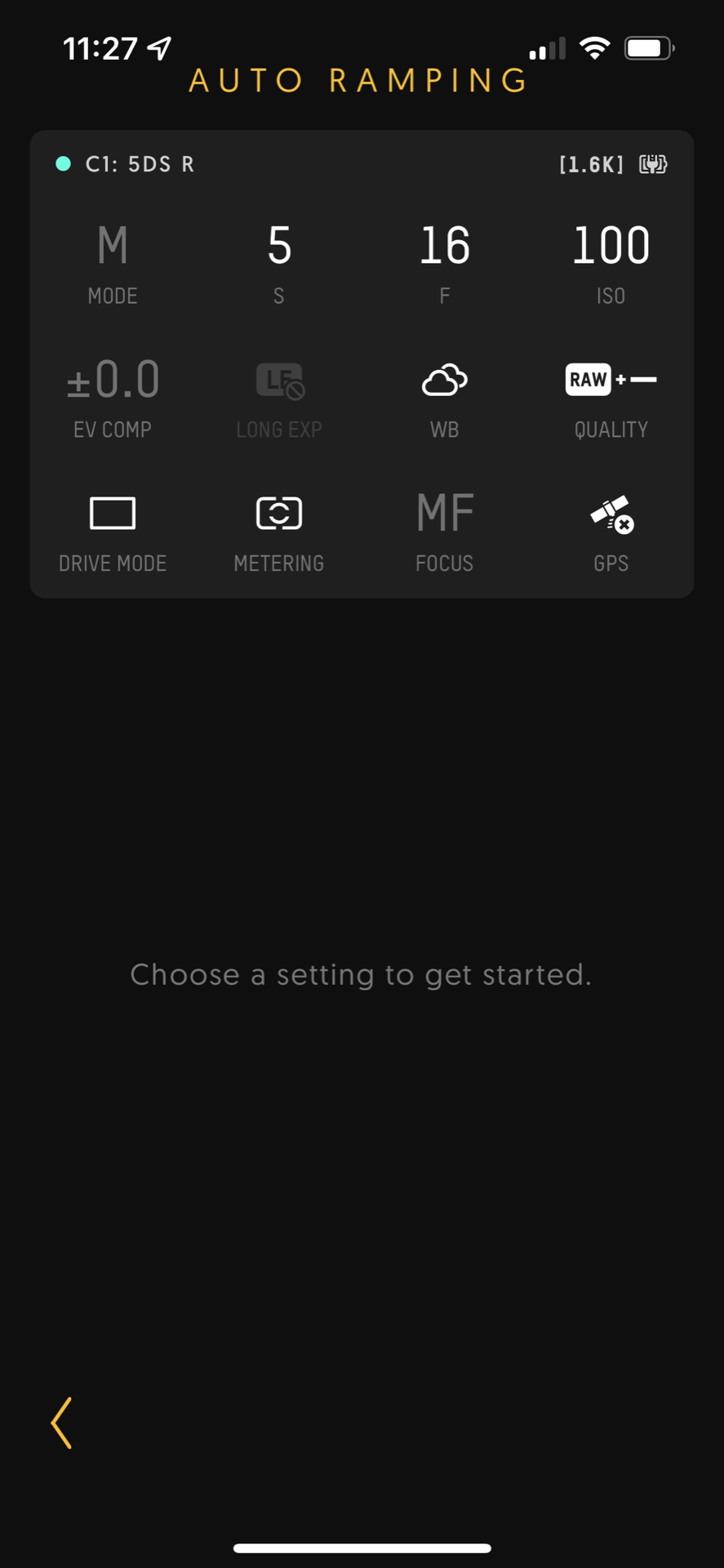

I tried Raw + jpg to 2 different cards, to 1 card as well as Raw + no jpeg and the auto ramp didn't change the setting in all 3 scenarios.
Is there a guide somewhere with recommended camera settings?
Below are screenshots of some of the settings I tried while simulating sunrises/sunsets by adding filters/lens caps to the camera while it shot.
Please let me know what you advise I try next.

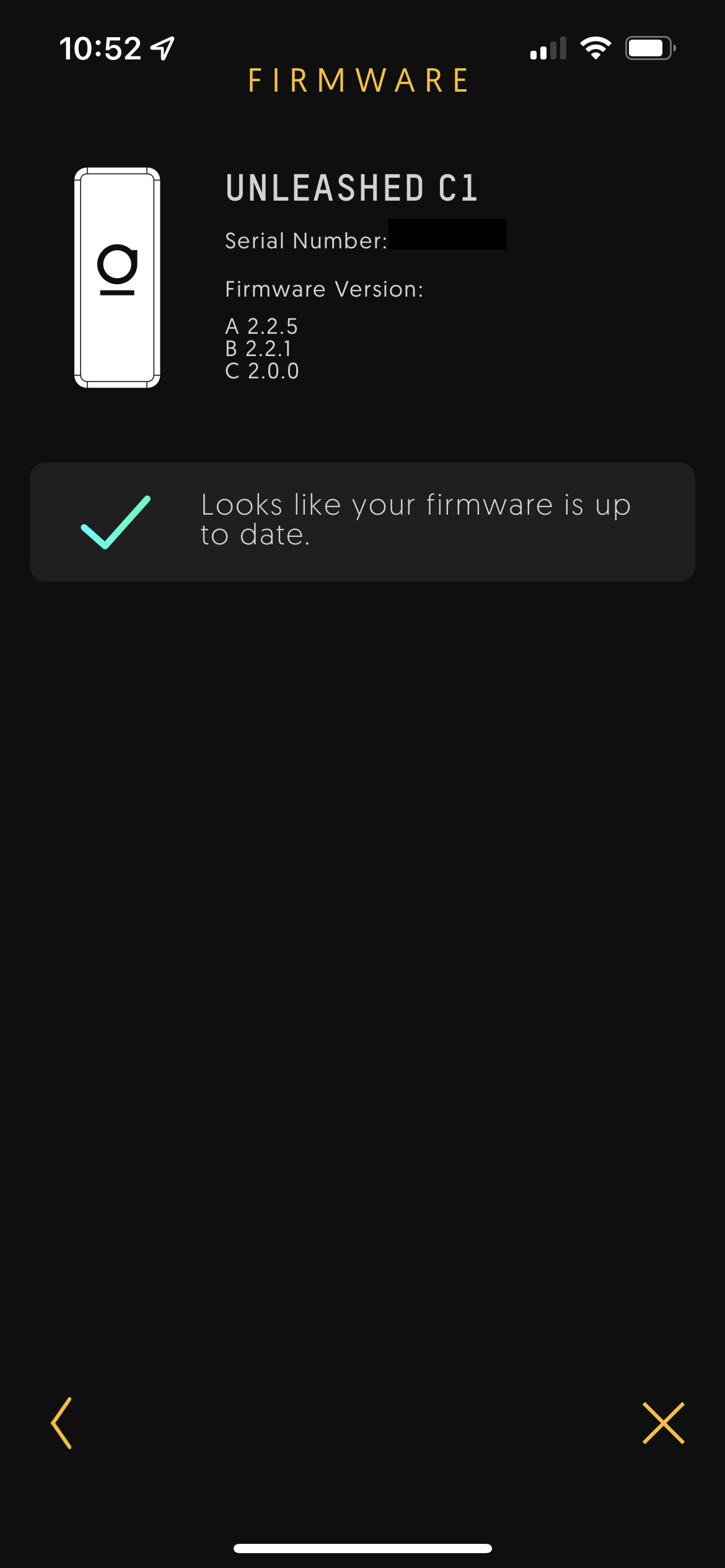

--_ How is it possible that his Firmware version is 2.2.5 and mine is 2.2.0 and the App says mine is up to date?!?
Re: Unleashed 18 C1 not auto ramping Canon 5DS R
Posted: December 29th, 2022, 11:02 am
That is odd. could you send us a screenshot?
