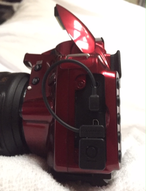

I have a Nikon D3200 (don't judge me, it's the most I can afford...)
I have plugged my new N2 module into into the camera per the video instructions, USB cable facing toward lens..

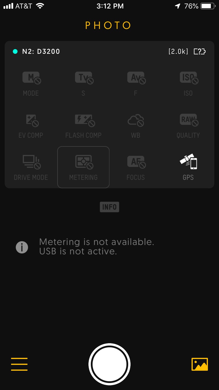

Once installed and paired, the only feature that works on my iPhone is the GPS. The N2 unit is blinking green. All seems to be happy. But all of the other menu items state that there is no USB cable attached.
I know that my USB port works because I use the Nikon wireless unit and it works fine.

The cable looks like it's plugged in correctly, but it's not detecting the camera.
can you choose another setting other than metering and tell me the error it shows? does it change when you unplug the USB cable? (try unplugging both sides)
Does the D3200 still have the option to change USB modes in the Setup menu? If it does, please change it to MTP/PTP mode.

Okay, in answer to your questions, I have attached a new screenshot of my iPhone screen with the "quality" icon selected Same response.. no USB.
When I unplug both ends of the USB cable, I get the exact same result -- no USB connected. I have unplugged and re-plugged many times. I also deleted the app from my iPhone and reinstalled. Lastly, I did a factory settings reset on my camera. Same result.
I don't find anything in the manual or in the camera menus to change the USB state.
Thoughts?
Thoughts?
