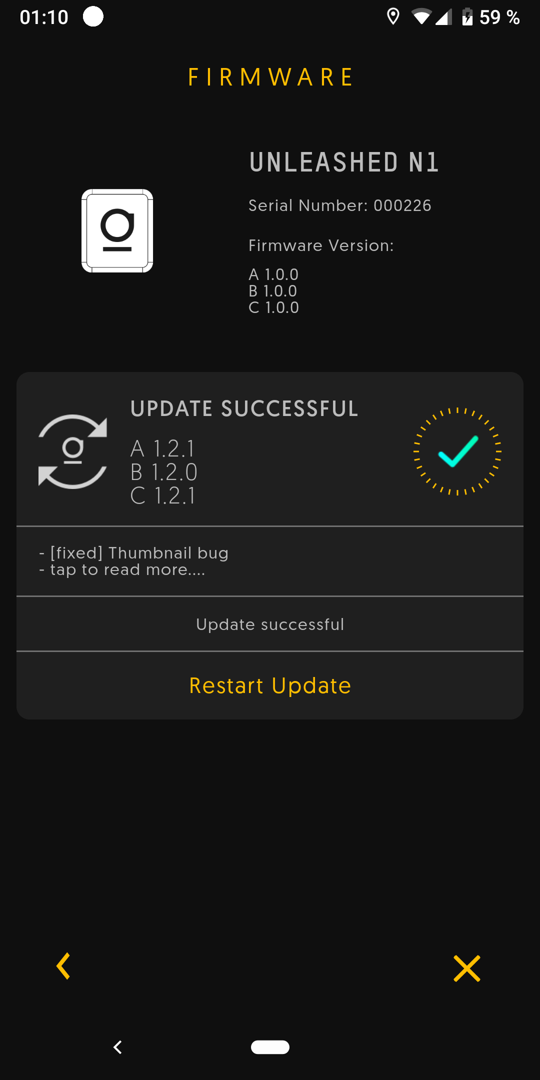

updated app to 1.0.1 and was asked to install firmware update.
This seemd to go okay, it wanting to install
A 1.2.0
B 1.2.0
C 1.2.1
It reached 100% and said update successful but each time I now go into the app it repeats the message and says I have
A 1.0.0
b 1.0.0
C 1.0.0
and wants me to install the update again.
Tried forgetting the unleashed, powering off the unleashed, rebooted phone, flush cache and data on app.
Any help apppreciated... Mike

I'm on a D500 and I have updated the App on my Android.
When I connect to Unleashed, I get a number "1" icon stating that there is a new firmware update Ver: 1.2.1, and so forth. I update it, I get the green check mark saying that it was successful and after rebooting my phone, and shutting the camera off and unplugging Unleashed, it still wants to update firmware version because under "current version" it shows up as the old one. Ver 1.0.0
Anything I am doing wrong here?

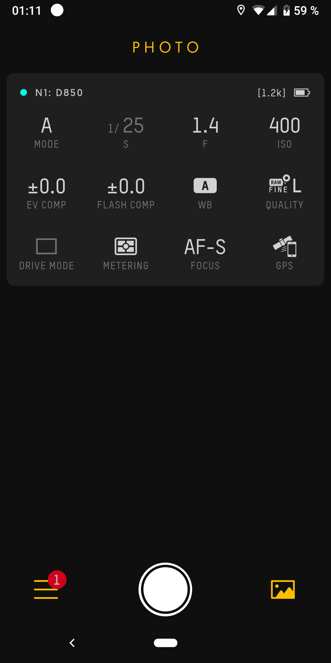

Same issue for me, but unpairing, cache clearing in the app, rebooting, or any combination of these actions won't help. When I clear cache in the app, I have to re-install the firmware. Once installed, the attached screen is visible, message permanently visible. D850, Google Pixel3, Android 9.

The Firmware seems to have updated completely, and our Android guys are looking into the issue remaining, that the old firmware versions are incorrectly still displayed. That firmware update badge is very annoying - I completely agree with that ;-)
As i wrote earlier: please double-check that the new firmware is actually installed:
One change you'd notice easily: if you remove the SD card, does the triggerbutton in the app get grayed out? If so, then it's probabbly still the old firmare, if it stays white, then you're on the new firmware. Remove the USB cable to be sure.

Re: Firmware update issue
Posted: February 15th, 2019, 4:43 pm
So we looked into the issue, and have a potential solution.
It could be that you "Bonded" the Unleashed with your phones, by pairing with the Unleashed in your Phone's system settings, rather than just in the app.
This bonding causes the phone to cache the Bluetooth services and characteristics.
We changed some of these in the firmware update (for example the one telling the app the firmware version), but if bonded, your phones don't ever learn about these changes.
We're looking into ways to prevent this in the future, but for now, all you need to do is go to your Phones Bluetooth settings, "Unpair" the Unleashed there, and probably also unpair it from the Unleashed app to be sure. Then reconnect it, but this time only from the app.
Let us know if that worked!
