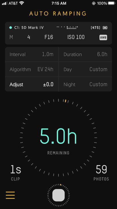

I've recently picked up the Unleashed to do 24h holy grail timelapses, but in my testing it has failed to adjust the shutter speed properly during a night to day transition. The exposure time will stick to 4 seconds despite the image gradually being overexposed and completely washed out. During this time, the ISO and aperture will adjust to their limits.
I have been able to recreate the bug by purposefully over or underexposing the start of an autoramp sequence. The Unleashed will attempt to correct the exposure with anything from the 1/8000-3s range. Once it is set to 4 seconds or higher, it will fail to adjust the exposure time. Tests were conducted with and without ND filters. This issue has manifested on two cameras, both Canon 5dM4.
Settings:
EV Smoothing 24h
Interval: 1min
Day: Default
Night: Default
FW: A2.0.1 B2.0.0 C2.0.0

EV Smoothing 24h.
I've also tried testing the EV Smoothing + Autocomp algorithm, but that one fails to adjust at all and gives the error message "Trigger is available. Ramping operation failed too many times. Check you camera settings."

Tested the new firmware yesterday and today; the behavior has changed a little, but unfortunately the issue still persists. Now the shutter speed will adjust normally at first, gets stuck until the EV is about +3, then immediately drops to 0EV and adjusts normally after that. So far in my tests I found the Unleashed to hang on 15" and 4" shutter speeds.
Still using the EV 24h algorithm. No issues for day-to-night transitions.
