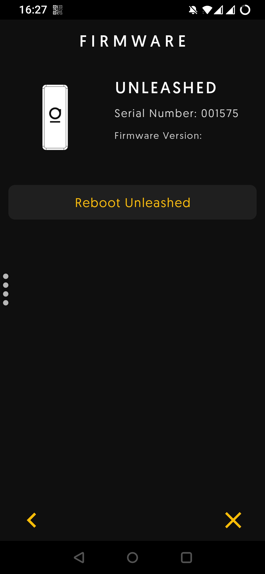

Bonjour,
La
mise à jour s'est bloque (en fin du firmware B il me semble). Le module ne se connecte plus et je reste bloquer sur le bouton "Reboot Unleashed".
Pouvez-vous m'aider ?
Merci,
Bruno.

Bonsoir Olivier,
j'ai supprimé l'APP et vidé les caches mémoires. Puis recommencé la procédure (deux fois).
Mon OnePlus 6T (Android 11) reconnait bien le module. Cependant, les led du module ne s'allument pas...
le "Reboot Unleashed" ne se fait toujours pas.
cordialement,
Bruno.

Yes! we found your issue yesterday.
The problem is that you had a very very old firmware on your device (1.2.x or less - from 2018 or early 2019). These versions had a slightly different API for the firmware version transmission to the app, and the latest Android app did not take care of this, and as it can't check the current version it is unable to decide whether to tell you to update or not.
We've already implemented a fix, but it will take until next week to publish. If you want to use your Unleashed faster, you could do the firmware update with an iOS device (from a friend or family member). Then you'll be able to use the Unleashed with your Android phone after the update.

Hello OLiver,
I uninstalled and then reinstalled the application, but nothing changes. The "Reboot" button remains inactive ...
