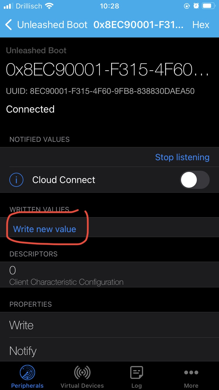

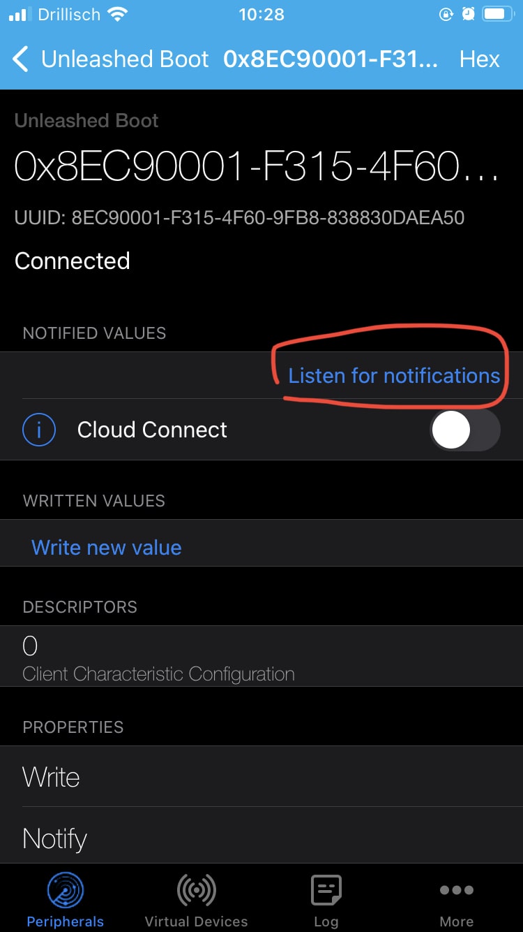

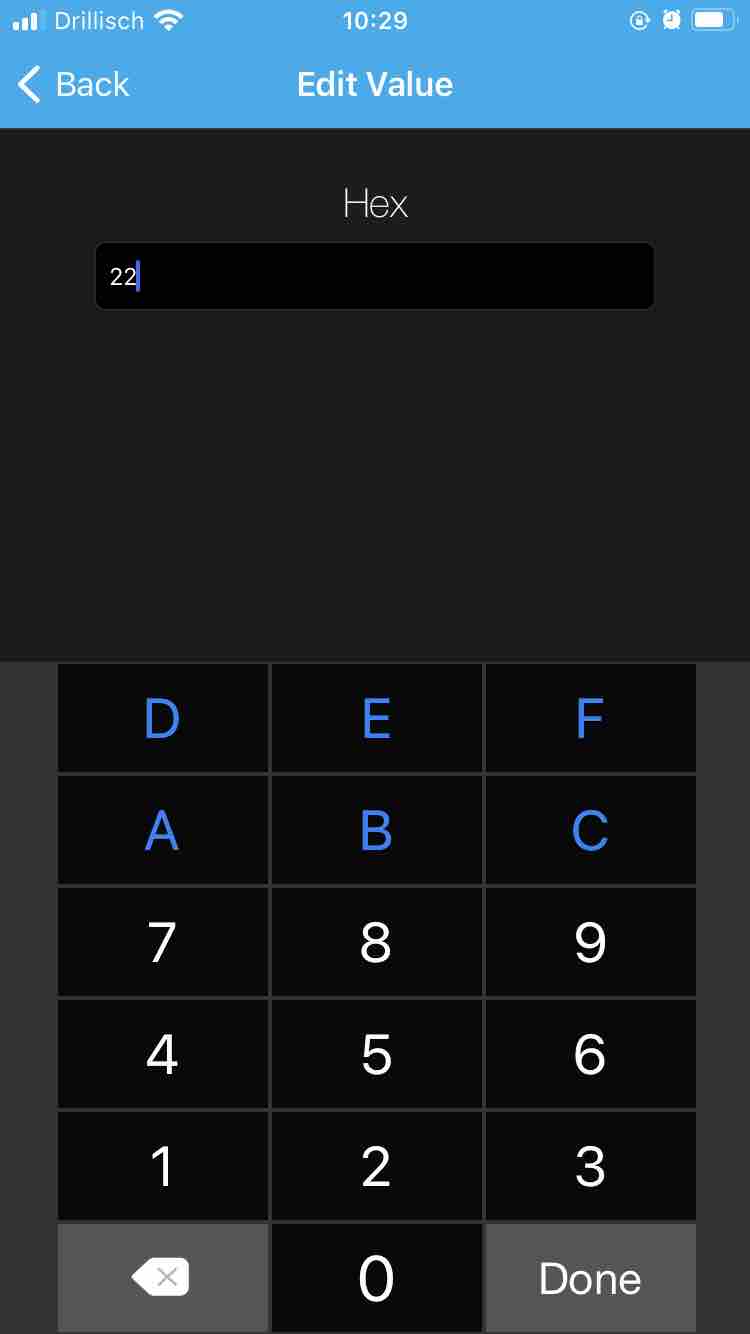

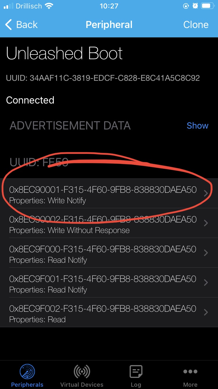

In the latest beta bootloader we implemented a mechanism to erase the flash, so let's try that and hope for the best. You will need the same Lightblue app you used before.
- Plug in your Unleashed and turn your camera on.
- Open the Lightblue app and locate "Unleashed Boot"
- Tap on the list item circled on the screenshot below (the one that says write notify)
- Tap on listen to notifications
- Tap on write new value
- Write 22 and tap on done
- Your Unleashed should reboot and hopefully work normally again
If it doesn't work, get in touch with Oliver again to arrange a replacement.

Hello Andy,
I followed the instructions. Just after typing 22 the blue light on the dongle goes down, a few seconds later the dongle flashes red, and nothing is changed. The unleashed is still presenting itself as "Unleashed boot". I repeated the process twice, just to be sure, but no different outcome.
Best regards,
Marcin
January 29th, 2021, 10:31 pm
Hey Marcin,
Your replacement was shipped yesterday. Thanks again for your cooperation and testing all our suggestions!
