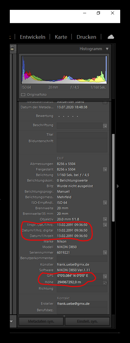

July 13th, 2020, 6:57 pm
Heute mal wieder!!!!!!!!!!! Nur beim ersten Bild, dann ok.

July 15th, 2020, 1:39 pm
Da kann ich nur von ausgehen, dass wir diese Daten auch so vom GPS bekommen!
ich werde die Kondition nochmal überprüfen, wann wir Daten als "Gut" akzeptieren. Ich könnte evtl. für das Datum nur ein gewisses Zeitfenster erlauben, würde mich aber gleichzeitig freuen, wenn unser Unleashed in 2091 immer noch funktioniert. aber zumindest Daten in der Vergangenheit könnten wir ausschliessen.
Aber wenn uns das GPS Daten gibt, und gleichzeitig sagt, dass diese gut sind, dann müssen wir diesen Daten auch glauben.
July 15th, 2020, 3:43 pm
Hi Foolography Team,
I have been reading the posts in this thread, and something popped into my mind...
Could it be that it is possible that one of the satellites on which the external GPS (QStarz BT-1000ST) has a fixed locked is giving out bad data and thus puts out corrupt data to the Unleashed?
or:
Could it be that by re-establishing the Bluetooth connection, the first few received location data from the external GPS (QStarz BT-1000ST) is corrupt?
It sounds like a problem that does not always take place in a continues pattern, but in exceptional cases causes corrupt data to be stored in the EXIF data of the photo. That is hard to reproduce for debugging.
Does the Unleashed middle out the date/time received from all data handed out by an external GPS device?
Does the Unleashed middle out the location received from all data handed out by an external GPS device?
Maybe some "date/time fencing" and "location fencing" could be a possible solution to drop all invalid data that is outside of the "fence" (boundaries) of a certain time frame and location frame. Just as Geo-fencing works, detecting in range and out of range boundaries.
Maybe it is also possible to re-route the data coming from the external GPS device to the Unleashed App from the Unleashed itself? Or maybe it is possible to re-route the data coming from the external GPS device first to the Unleashed App and then forward it to the Unleashed itself, making the Unleashed App the man-in-the-middle so that the GPS data can be logged for debugging purposes. Then you will know for sure if it is the external GPS device, the Unleashed App, the Unleashed hardware or the camera not processing the incoming data correctly.
Is it also possible to have a double check on the camera date/time stamp and the received date/time stamp from the Unleashed, and detect if there is a huge gap between those stamps?
Can you fetch the date/time stamp from the camera and use that in the Unleashed? By that you could correct the incoming/received date/time stamp from the external GPS device before it is written into the EXIF data of the camera.
It would be a "nice to have feature" when a second Bluetooth connection could be established from the Unleashed hardware to the Unleashed App on the smartphone for logging purposes only. So you can see what is being received by the Unleashed hardware as incoming data. Setting the Unleashed App and Unleashed hardware in debugging mode, if possible?

July 15th, 2020, 7:12 pm
die GPS-Daten werden direkt vom Qstarz an den Unleashed ohne Umweg über die App geleitet. Die App ist auch gar nicht eingeschaltet. Wenn ich mir den Track des Qstarz anschaue, ist kein Ausreisser nach z.B. 2091 zu sehen.
