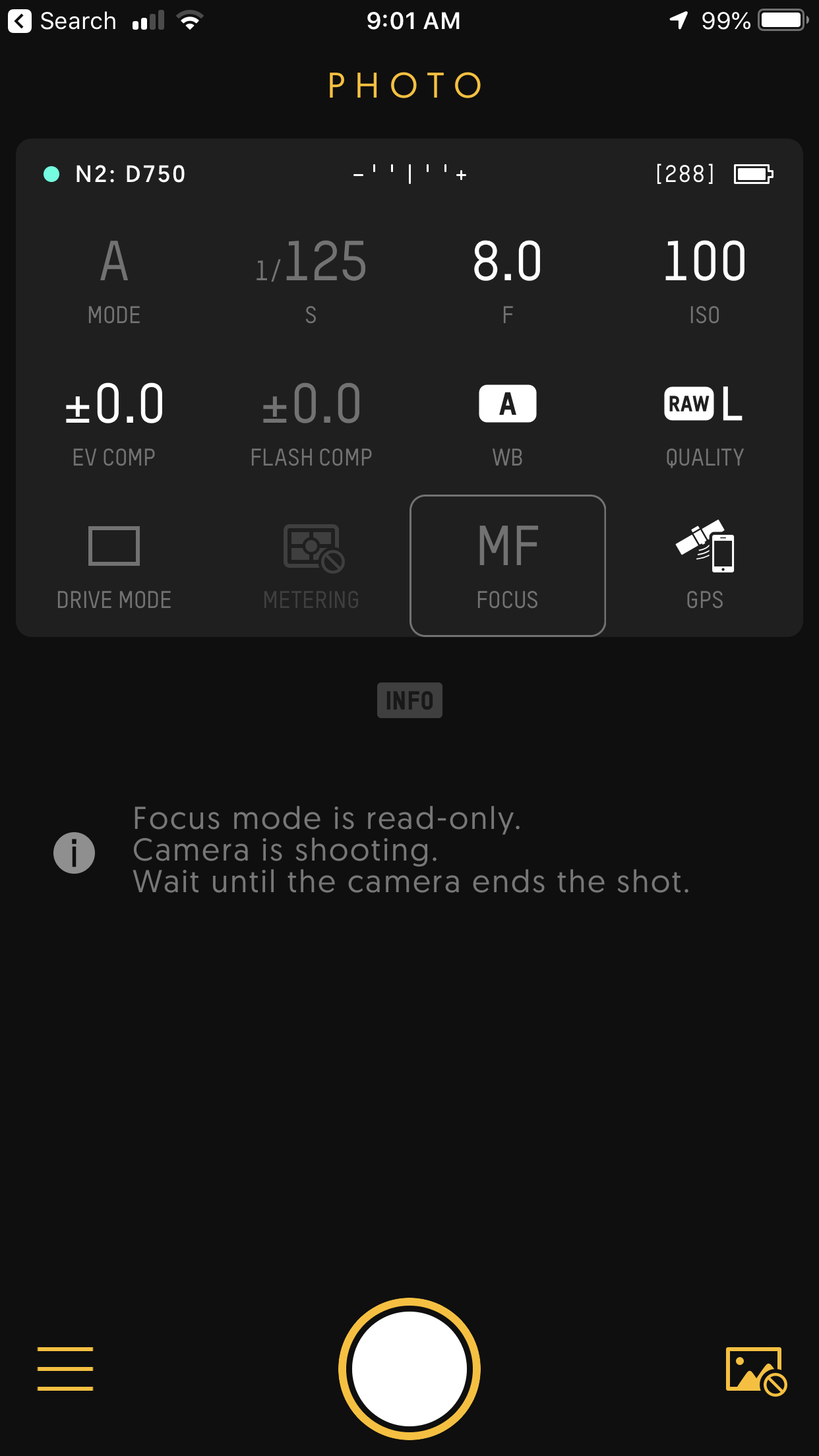

OK, several things I'm noticing.
1. The GPS is the only setting that is consistently enabled -- I can change the settings on it. I can trigger the shutter from the app. even when all the other settings are not enabled or lit up.
2. I was able to tap around several times and got several other settings lit up and felt haptic feedback on the phone. But I could only do this once. What I'm seeing consistently is that toggling the power button on the camera causes the other Photo settings to become enabled.
However, Unleashed app. still thinks the camera is shooting when I tap for instance the focus mode (see screenshot attached).
And as soon as I trigger a photo from the app., the camera preview shows it was taken, with geotag. But the Unleashed app. thinks it's taking another picture and all the settings, other than GPS, become disabled again.
As I noted, even with only GPS setting lit up in the app, the shutter is working, so that seems to contradict the other part of the app. which thinks the camera is still taking the shot.
Those messages about the camera still taking a picture are nonsensical, since most of the time, the shutter speeds are fractions of a second. My camera takes a picture in bright light and it's ready for the next one.
Regardless of some software status it may return, it's at odds with the physical state of the camera, which is that I can take new pictures, while the app. thinks it's still taking the first one.
3. So I have to keep toggling the power button to get the other settings in Photo mode enabled or wake the Unleashed device.
4. Even with several but not all the settings in Photo mode enabled, Video and Time Lapse modes still report that the camera is taking a picture, just as tapping on some of the Photo settings return that message.

Is the yellow ring of the trigger button in the app always there? Can you perform some tests for me and check the following scenarios?
  • Turn camera off and on again and check if the trigger is still yellow.
  • If the trigger isn't yellow after turning the camera on, check if triggering from the camera makes the trigger stay yellow.
If the trigger remains yellow only after triggering from the app, then it may be a firmware issue, but I still doubt it.
What do you mean with this?
hyy wrote:
November 29th, 2018, 6:12 pm
It seems to me that your Unleashed is working mostly fine, but the yellow ring in the trigger is causing issues in the app. It may be a hardware issue.

November 29th, 2018, 7:11 pm
Most of the time it seems to be yellow.
I could quit the app and force it to reload by up swiping it as a running app, Then when it launches, it's gray with all the settings disabled.
But once I start tapping on the settings, it turns yellow and stays there.
When you say hardware issue, are you saying hardware issue with my camera or the Unleashed device?
November 29th, 2018, 7:16 pm
If after the Unleashed connects to your phone, you turn on the camera and the yellow ring is there, I'd say that your Unleashed has an issue with the shutter detection. Unfortunately, that would be a hardware issue, more likely in the Unleashed than in the camera.
One thing that you can do to confirm that the Unleashed is faulty is to connect it to another Nikon camera with a square plug. If the app still shows the yellow ring, then it's definitely an issue with your Unleashed.
