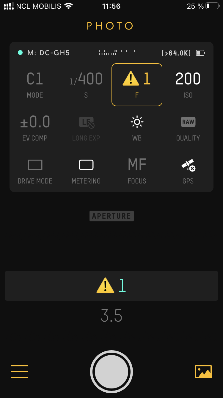

In all the modes (single photo mode, timelapse mode, holy grail mode or video mode), when I set my aperture to 4.0, it’s ok, when I want to set f 3.5 (which the maximum aperture for my lens), I have a yellow triangle that show up and the aperture value shows f1, but on my camera it’s properly set to f3.5
Aperture set at F10, it’s ok, F8 it’s ok. When I set to F9, same yellow triangle and F1 sign (but my camera is at F9 properly), but within the app I still can go back to another f stop that works.
The values that cause this bug are F18, F13, F9, F6.3, F4.5 and F3.5. for each of this value, the camera is properly set. It’s just within the app that it cannot display properly. I have exactly the same problem in all the modes, with the exact same F values

OK, interesting. It does look like it might be related, though the result is very different.
Could you try this when your Exposure Mode is a simple "M" instead of the custom "C1"?
Could it be that you changed your exposure value stepsize to something other than 1/3 of a stop?

Sorry for the C1 mode, but it doesn’t change anything. I noticed this issue when shooting a holy grail in the first place, so I was in M mode. And here again I tried another time in M mode and same result
And no, my exposure increments have always been by a 1/3 of a stop

We got all the data we need, and found the issue! It's definitely a bug in the camera firmware, which on those values (shutterspeed >1s and the apertures you mentioned, F9, F6.3, etc), the camera suddenly tells us that the current value is "00000000". On the next aperture, it would then give us the correct values again...
We will contact Panasonic to let them know, and will probably fix this in a firmware update in the future. At least Panasonic is a company that frequently issues Firmware updates.
However, we also implemented a workaround for this, so we don't have to wait for Panasonic's fix. the mentioned bug only affects one type of packet, where we get all the Information from the camera for a setting (current value, permission and the list of settable values), but there's luckily a second type of packet where we just get the current value. We will now just ignore the buggy current value when we get those packets, and simply the previous current value, which will have been, or still will be set by the other (non-buggy) type of packet.
This fixes the issue for both the shutterspeeds over 1 second, as well as the apertures showing "/!\ 1"
We will probably publish a Firmware update with this fix by tomorrow.
