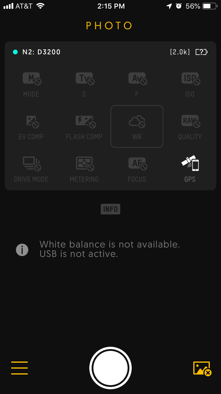

Here are the steps that I took and the photos are below:
#1 - Removed previous Unleashed N2 and previous USB cable from Nikon 3200 camera (while the camera was in the power off position)
#2 - Deleted the Unleashed App from my iPhone 6 in order to start fresh
#3 - Turned my iPhone off and then back on to make sure memory is clear
#4 - Re-installed Unleashed to my iPhone 6

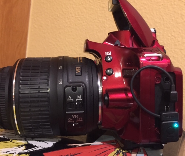

#5 - Installed the replacement N2 and replacement USB cable onto my Nikon 3200 (in the power-off position) (see photo below)
#6 - Turned Nikon 3200 on. The Unleashed device LED clicks on (see photo below) - so it is getting power

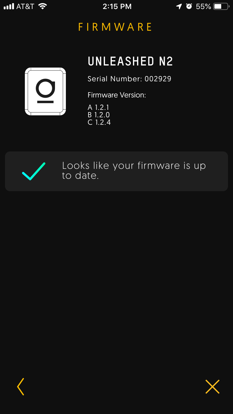

#7 - Selected my replacement Unleashed N2 in the app and ran the firmware update (see screenshot of firmware below)
#8 - Tried app features with replacement Unleashed N2 with the same results as before
#9 - GPS and shutter release both work perfectly.
#10 - Tried unplugging and replugging USB - no change occurred
#11 - Plugged a USB cable into my Nikon 3200 to my computer to see if I could transfer data -- data transferred perfectly - so USB seems to work
So, unless my USB port is somehow not communicating fully with the N2, I think there may possibly be a compatibility issue with this camera?
So now I have two N2 units (one that I need to return to you), and neither is fully functional with this particular camera. Not sure what to do next.

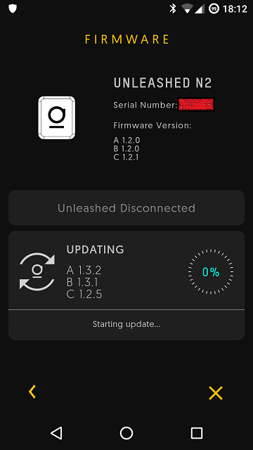

007: please try a couple of times! and yes, it's supposed to disconnect as soon as you start the update - the Unleashed then reboots into Firmware update mode, but the app should then reconnect immediately too, and begin the firmware update.
can you make sure you did not pair with the Unleashed in your system settings?

So that's the state of the BT: And that's Your app: With or without USB cable doesn't matter. Even after a minute the app didn't connect.Oliver wrote: ↑May 6th, 2019, 11:30 pm007: please try a couple of times! and yes, it's supposed to disconnect as soon as you start the update - the Unleashed then reboots into Firmware update mode, but the app should then reconnect immediately too, and begin the firmware update.
So either the Unleashed Boot mode doesn't listen for the app in this state or the app fails to create a connection to "Unleashed Boot". Maybe some logging debug build might help here, or do I need You to update the Unleashed by Your devs?
(Another question: why can't the update be aborted with the orange X?)
