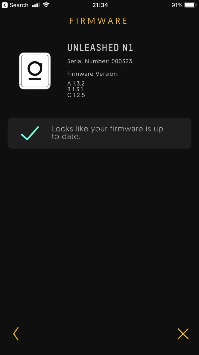

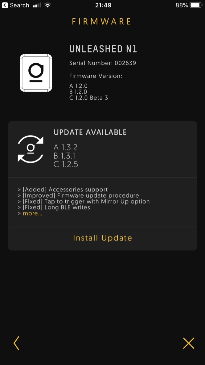

HI Oliver,
I have recorded a short video of the first unleashed unit (serial 000323) as well as the 2nd newer unleashed unit(serial 002639). The first unleashed unit still has the same problem even with the new firmware installed. I can send this to you if it helps to diagnose the problem. The 2nd newer unit has been working fine without any problems so I have not upgraded the firmware just yet.
I'd really like to have the 1st unleashed unit working so that I can use that on a 2nd body.
Thanks

Here is a screenshot of firmware version on the unleashed that causes my D850 back buttons to stop working.

This is for the unleashed unit that works fine on my D850.
